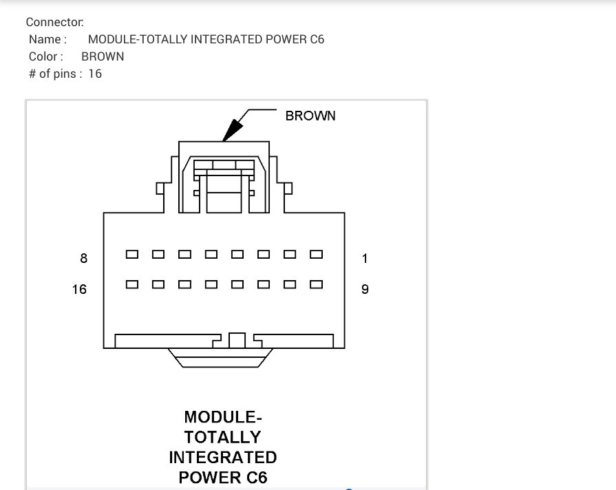

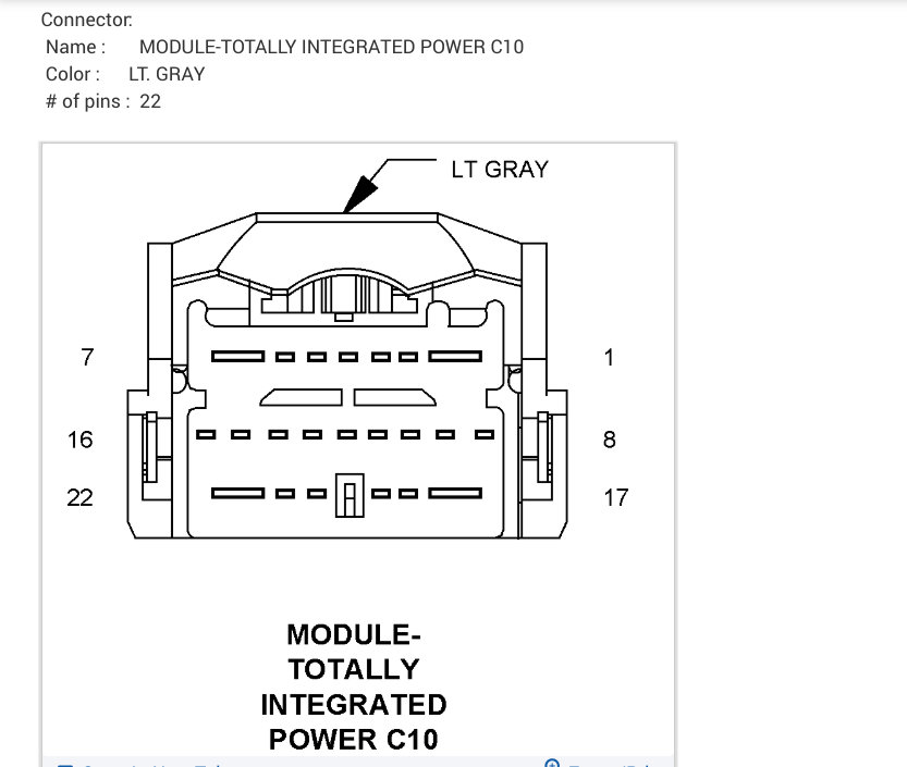

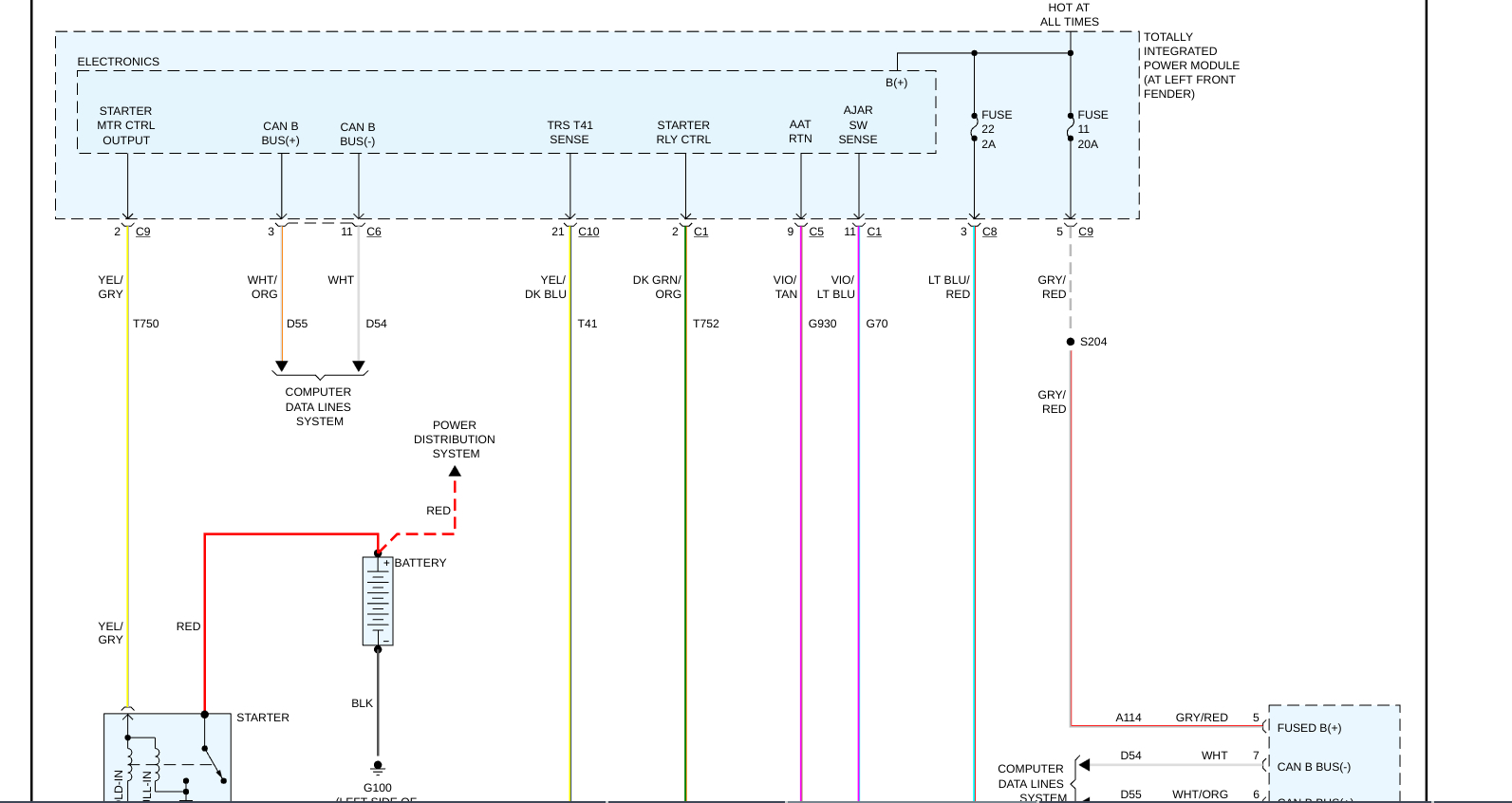

So I left the battery off for 2 days I got busy and. Wasn't able to work on it. I have not replaced anything. Because i'm wanting to get to the bottom of it. So what I did is went through every cylinder and pulled a plug. I then while I have it apart cleaned the carburetor because it was black black. I put everything back together and went to fire it up first turn it fired right up. Turned it off the tried turning back on but this time it did the same and clicked. But only clicked twice then fired did this over and over and the more times I did it the more cranks it took to fire it over. So where should I got from there?
Thursday, December 19th, 2019 AT 1:14 PM
SCGRANTURISMO
  • 4,897 POSTS

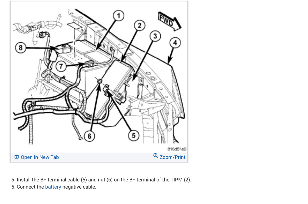

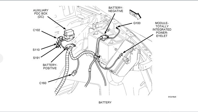

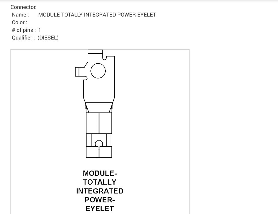

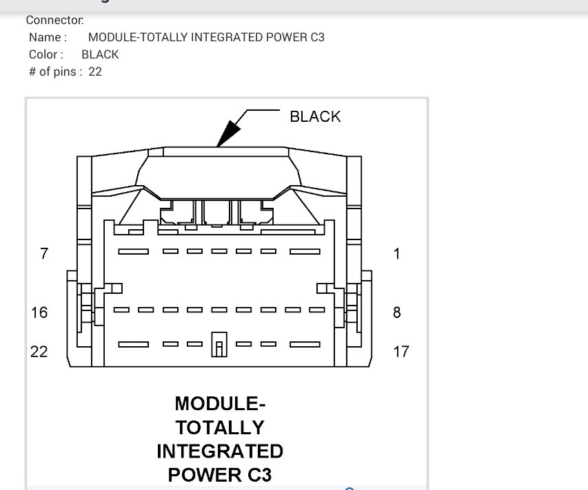

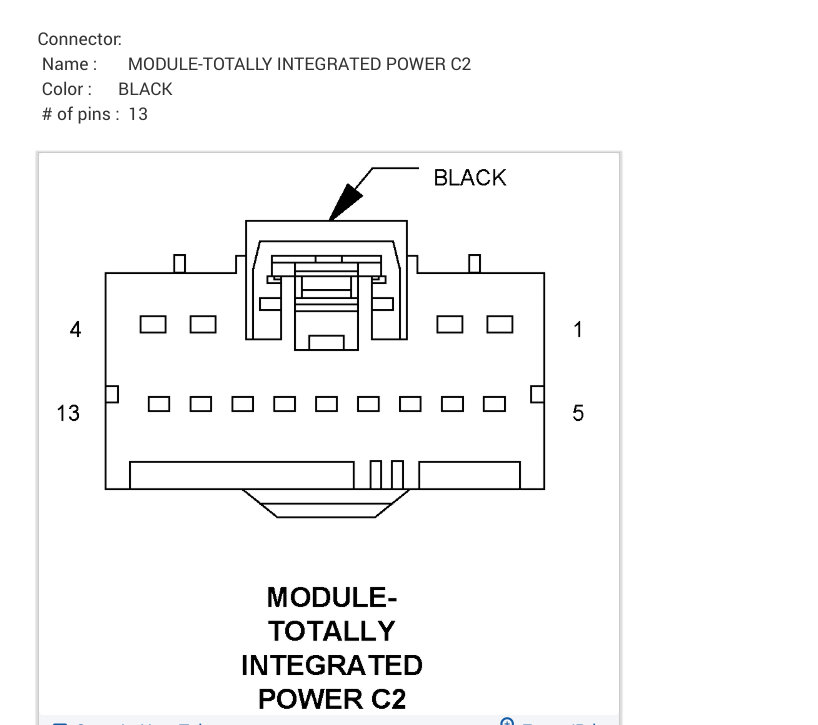

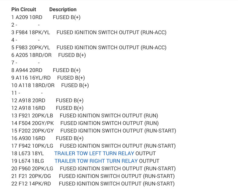

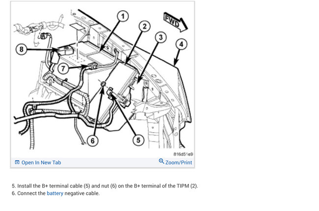

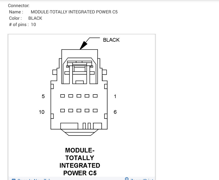

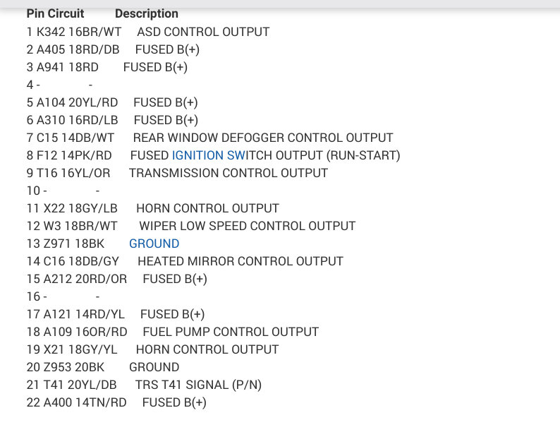

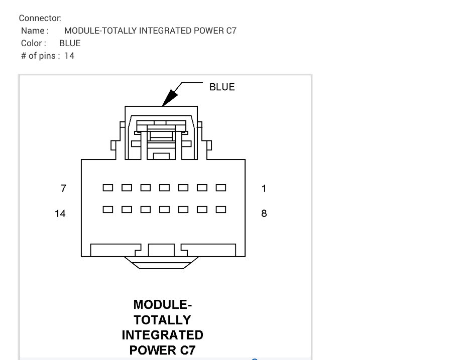

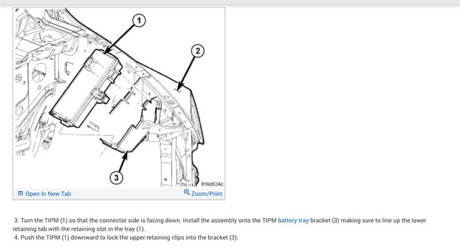

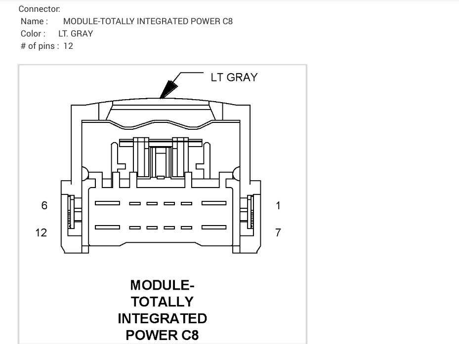

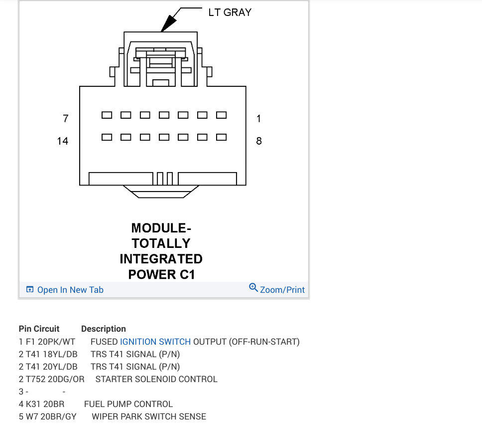

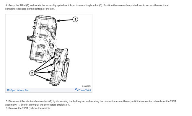

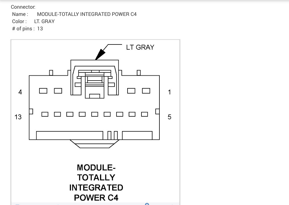

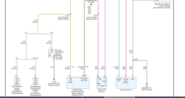

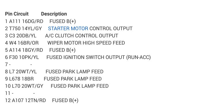

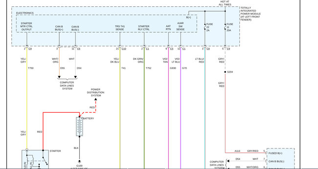

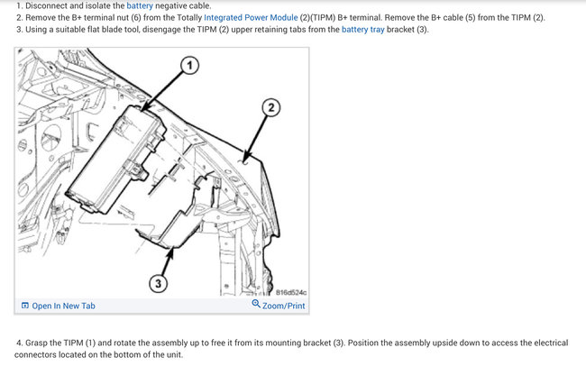

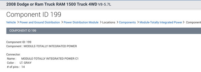

Hello again,

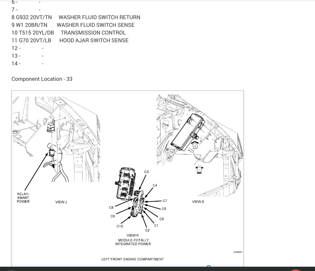

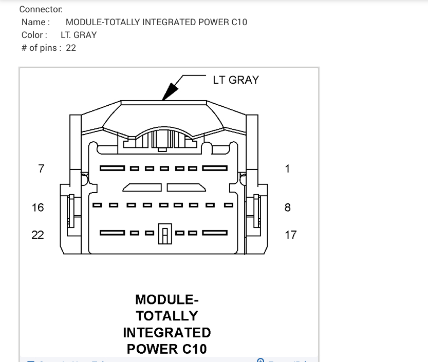

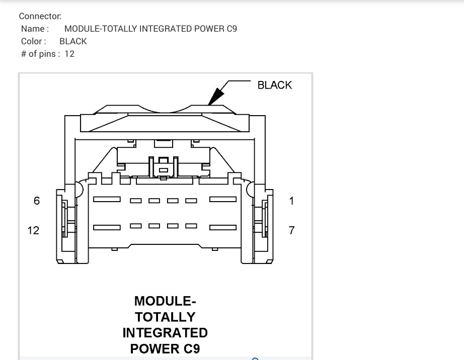

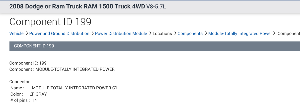

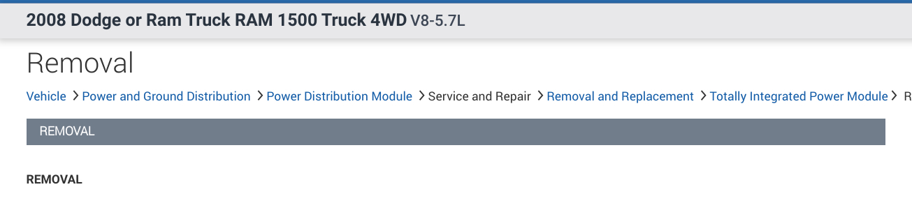

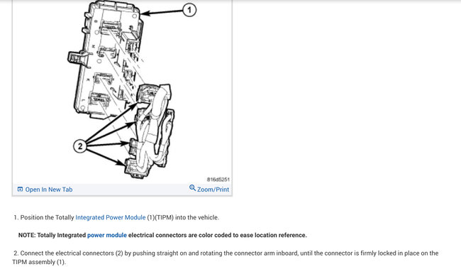

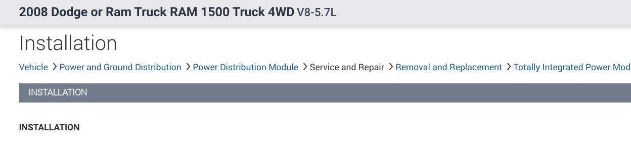

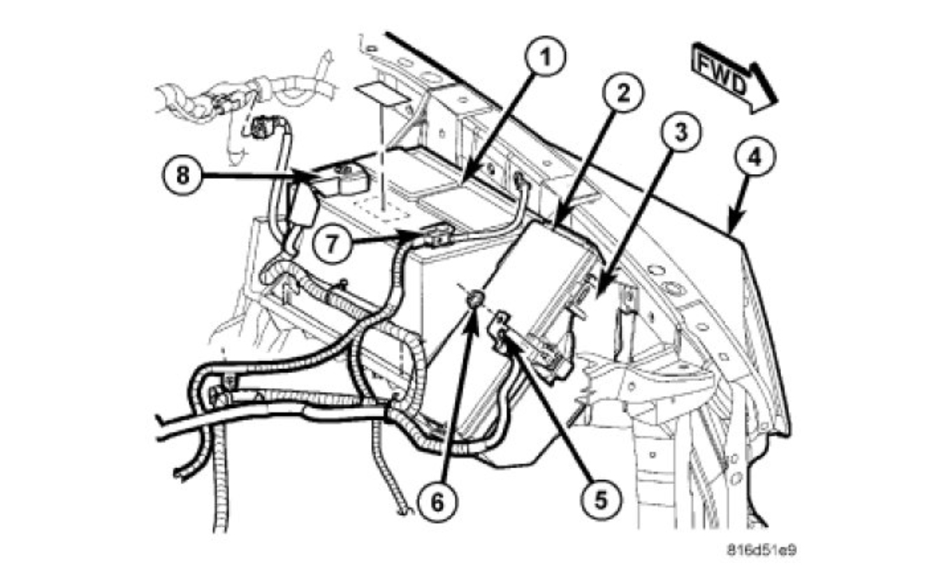

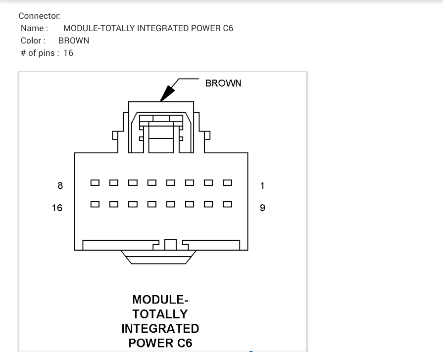

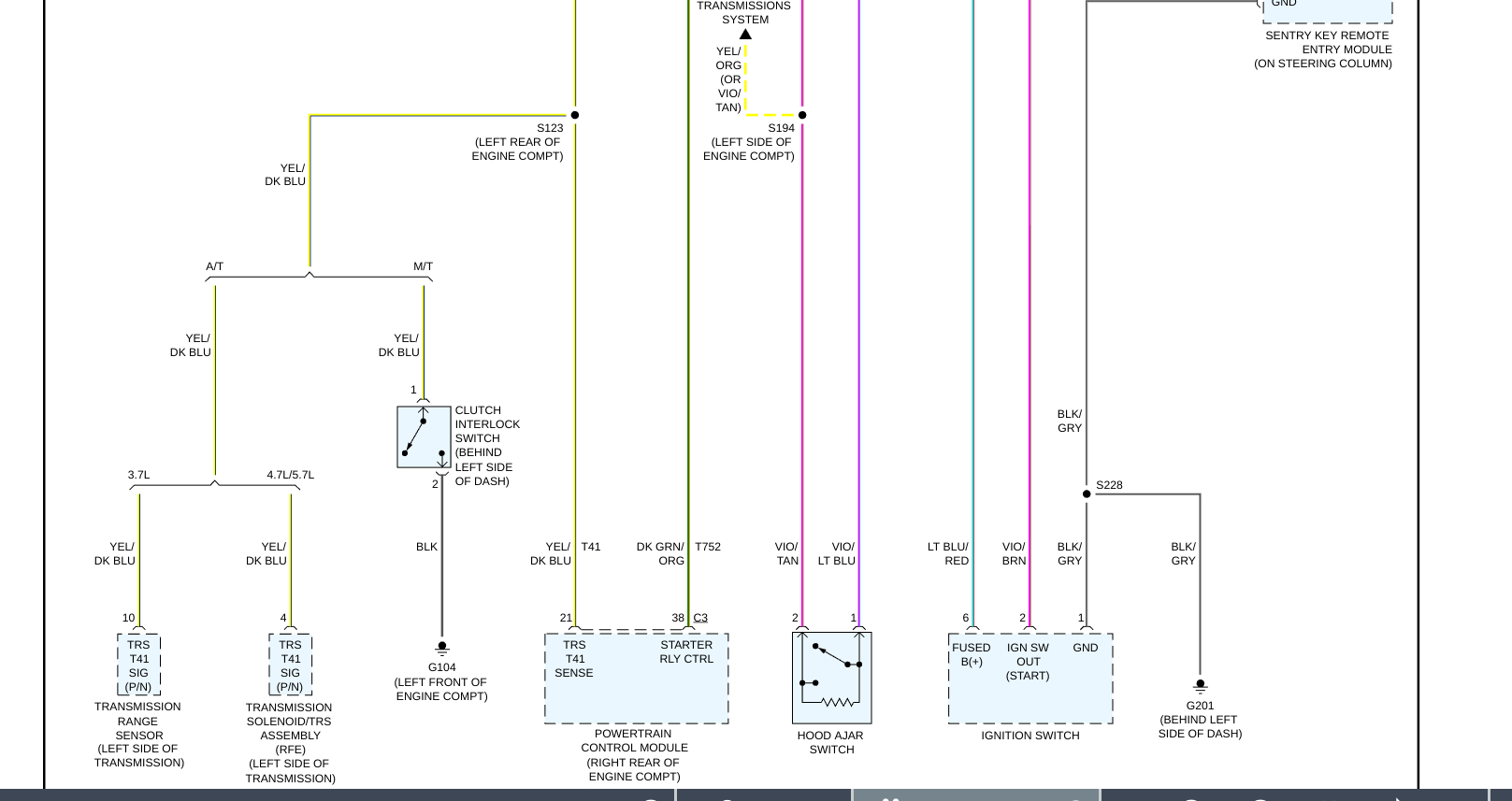

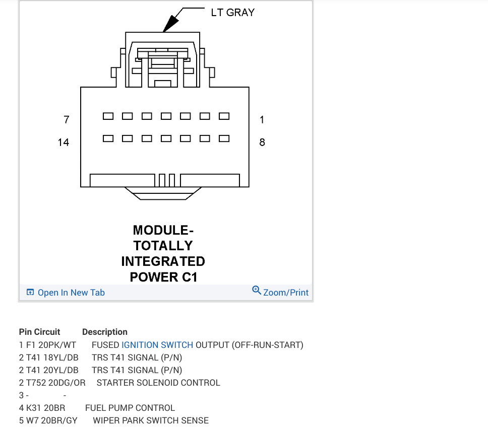

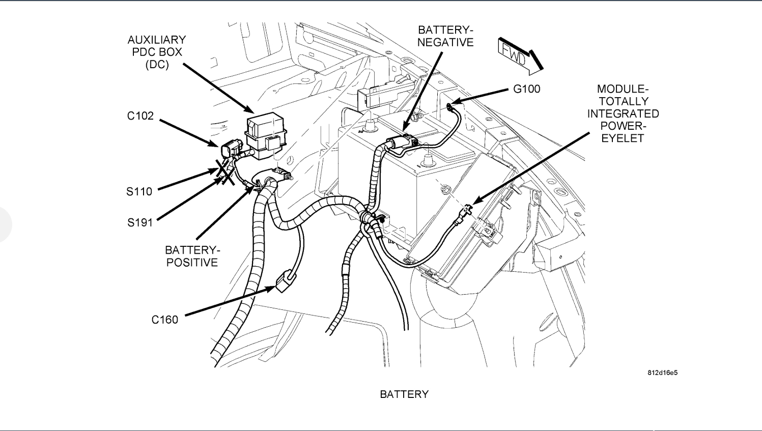

Okay, so it sounds like this could be a problem with your vehicle's starter relay, which is located in the Totally Integrated Power Module and is not serviceable. In the diagrams down below I have included a wiring diagram of your vehicle's starting circuit, as well as location and component i.D. With call outs, and the instructions from the vehicle manufacturer for the removal and installation of the Totally Integrated Power Module. Please go through these guides and get back to us with what you are able to find out.
Thanks,
Alex
2CarPros
Thursday, December 19th, 2019 AT 5:39 PM
