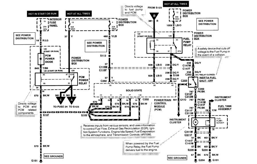

Do you hear the fuel pump come on with the key on? Can you test for fuel pressure?

Check all your fuses with a test light for power on both sides.

Need to verify power to the fuel pump relay with the key on. You should have two powers. One to the control side and one for the load side.

Okay, do you have power to the inertia switch?
Saturday, November 17th, 2018 AT 12:13 PM
LINDA EGAN
  • 19 POSTS
Yes it not popped out either.
Saturday, November 17th, 2018 AT 12:14 PM
  • 52,797 POSTS
Okay, if you have power to the switch then you have a bad fuel pump.

Now have fuel but no spark.

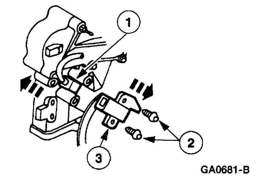

  • 52,797 POSTS
You may have a failing crank sensor which sends a signal to the PCM for creating spark.
1. Disconnect the battery ground cable.
NOTE: When the battery is disconnected and reconnected, some abnormal drive symptoms may occur while the vehicle relearns its adaptive strategy. The vehicle may need to be driven 16 km (10 mi) or more to relearn the strategy.
ImageOpen In New TabZoom/Print
2. Remove the Crankshaft Position (CKP) sensor.
1 Disconnect the CKP sensor electrical connector.
2 Remove the screws.
3 Remove the CKP sensor.
INSTALLATION
1. Install the CKP sensor.
1 Position the CKP sensor.
2 Install the screws.
3 Connect the CKP sensor electrical connector.
