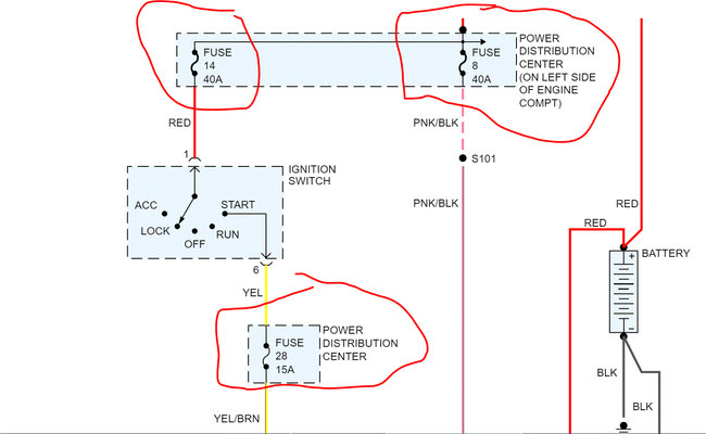

Won't start or even crank.

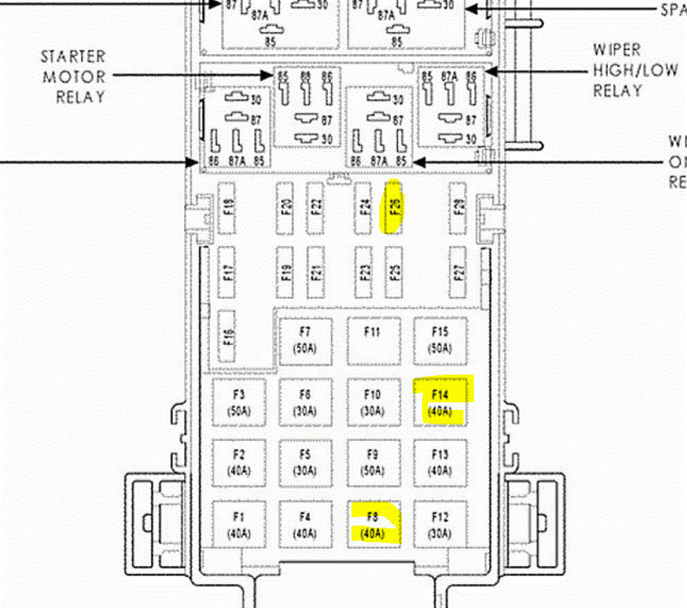

If it doesn't start in neutral, I need you to check three different fuses. All are located in the power distribution box (fuse box) under the hood. If you look at pic 1, it is part of the wiring schematic for the starter. I circled the fuses needing checked. Pic 2 shows their locations
in the fuse box. In addition to just checking the fuse, make sure there is power to them. Here is a link that explains how to do it:

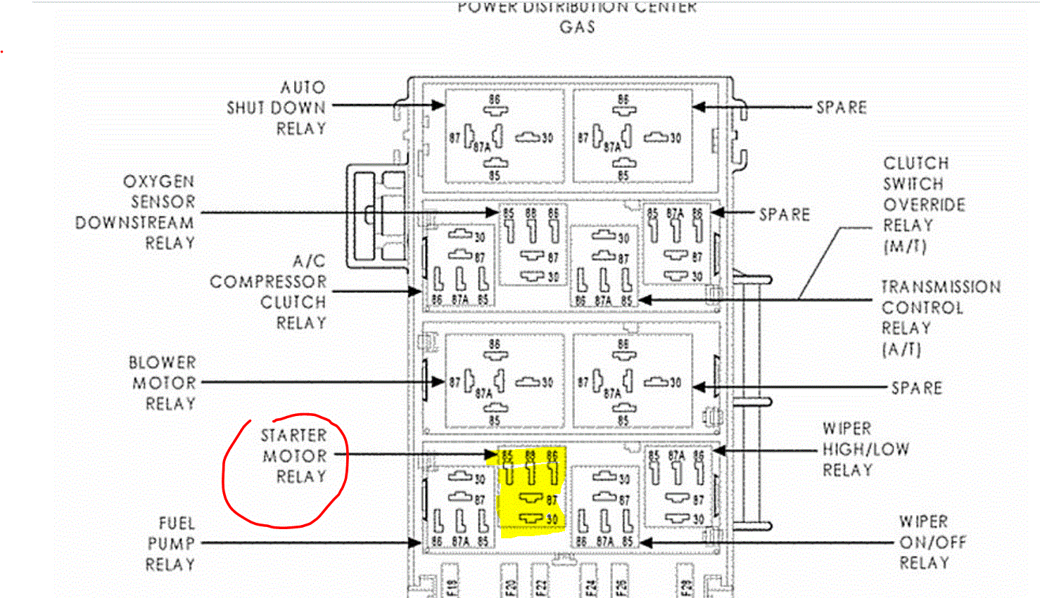

If all fuses are good, I want you to check the starter relay. It too is located in the same fuse / power distribution box. I highlighted in in pic 3. Simply switch that relay with a different one having the same part number. If there isn't one in the box (there should be) then here is a link that explains how to test a relay:
______________________________
