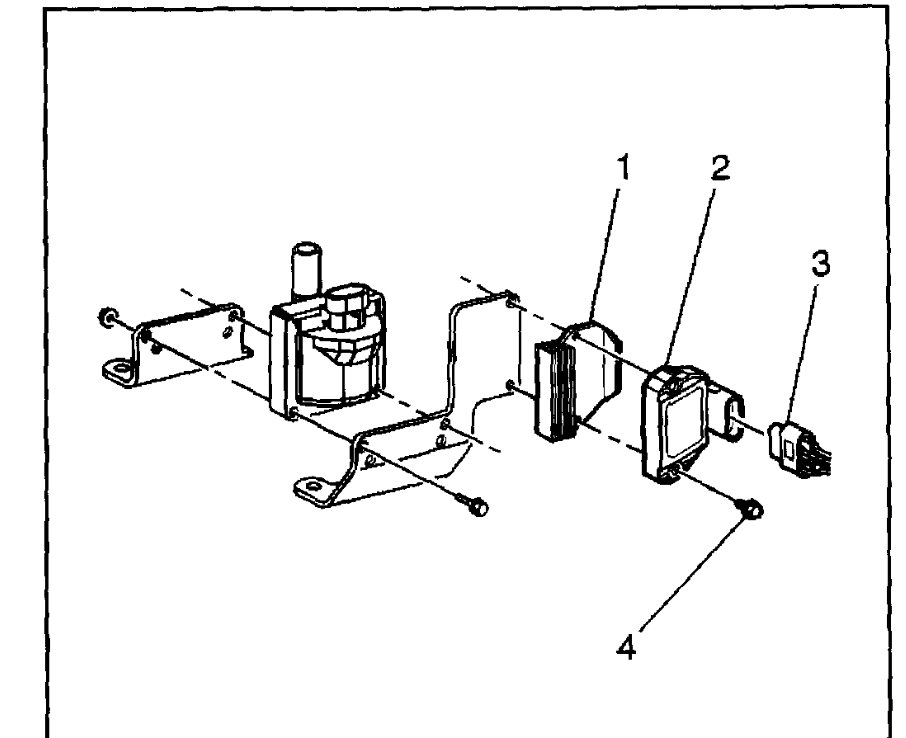

Van runs good except for hesitating/stumbling at freeway speeds occasionally then started at all speeds even at idle still occasionally. Then van wouldn't start it would turn over but not fire. About three weeks later brought mechanic over and van started right up used it everyday for a month. now van will not start again!

There could be a couple of things causing this.
1 Fuel pump failure ( A lean condition from low fuel pressure will result in a po300 and the other conditions you stated. A quick test now would be to spray some starting fluid in the throttle body and see if it cranks. if it does you know the fuel pump is bad or it's not getting voltage.
2. ignition control module (this can also cause the same symptoms you have. If spraying fuel in the throttle body does not result in it starting this is the next place to look. You can remove it and have most any parts store test it. Below is info on removing it.
Let me know what you find and we can work further if required.
The module is located on the coil bracket on the top passenger side of the engine.
1. Remove the engine cover.
2. Disconnect the electrical connector (3).
3. Remove the screws (4) holding the ignition control module (2) and the heat sink (1) to the bracket.
4. Remove the ignition control module and the heat sink.

Thanks Ken, I already replaced the ignition control module, tried the starting fluid test and van won't start. what next?

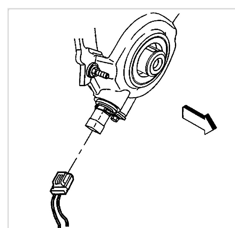

Now if both test fail then the next step it to replace the crankshaft position sensor. it's located on the timing cover. i'll post how to replace it below.

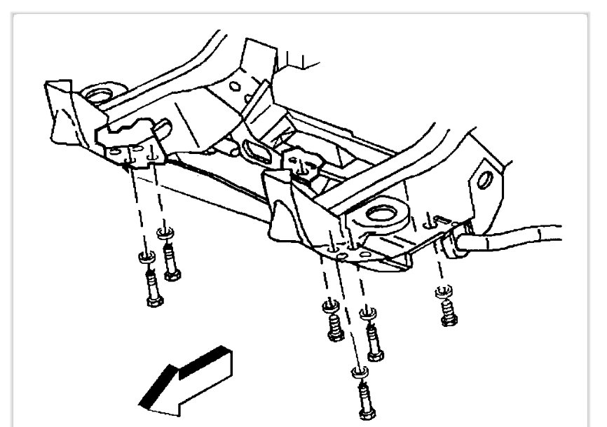

2. If the vehicle is equipped with the underbody shield package, then remove the steering linkage shield mounting bolts.
3. Remove the steering linkage shield.

4. Disconnect the CKP sensor harness connector.
5. Remove the CKP sensor mounting bolt.
6. Remove the CKP sensor.

3. Install the CKP sensor.
NOTE: Refer to Fastener Notice in Service Precautions.
4. install the CKP sensor mounting bolt.
Tighten
Tighten the CKP sensor mounting bolt to 8 N.m (71 lb in).
5. Connect the CKP sensor harness connector.
6. Install the steering linkage shield.
7. Install the steering linkage shield mounting bolts.
