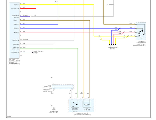

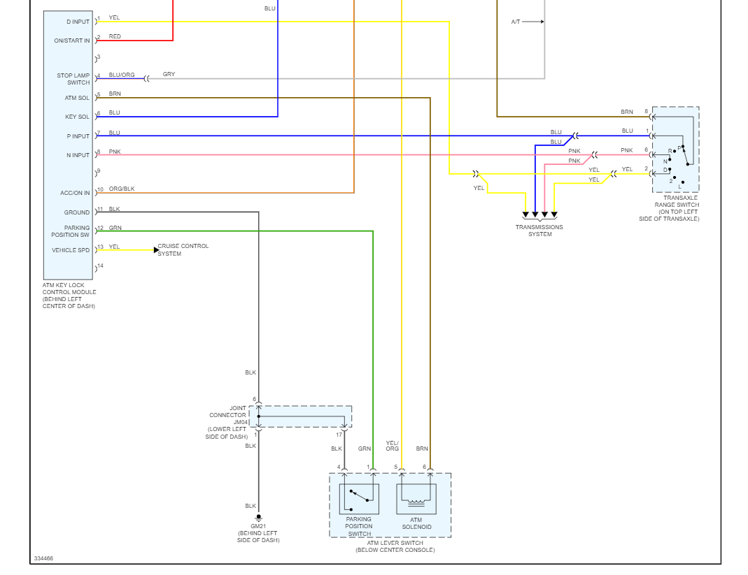

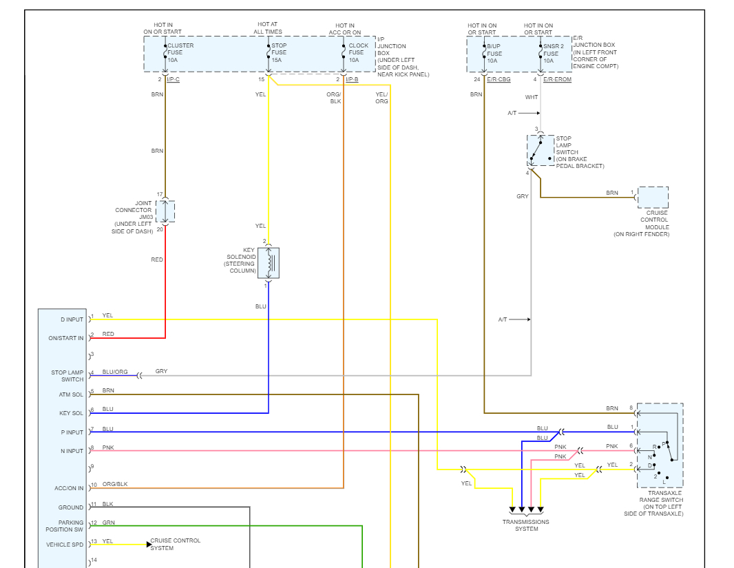

The fact that you can hear it clicking means the electrical part is working okay, I would disassemble the shift lock mechanical part to see if there is something stuck in there not allowing it to release. Here are the shift lock wiring diagrams so you can see how the system works, our manuals don't show the shift lock itself for some reason. :/ Check out the diagrams (below). Let us know what happens and please upload pictures or videos of the problem.

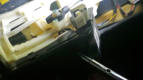

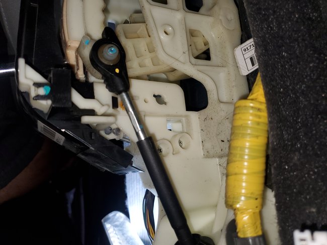

Thanks for the quick reply and for the diagrams. I will recheck electrical again with diagrams. I am still rusty with electrical diagrams, but this will help imagine what's going on. I checked fuses and found the cig lighter fuse blown, replaced it but no difference.

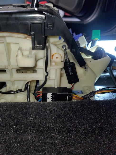

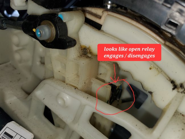

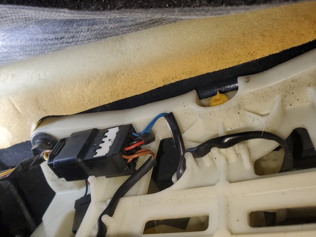

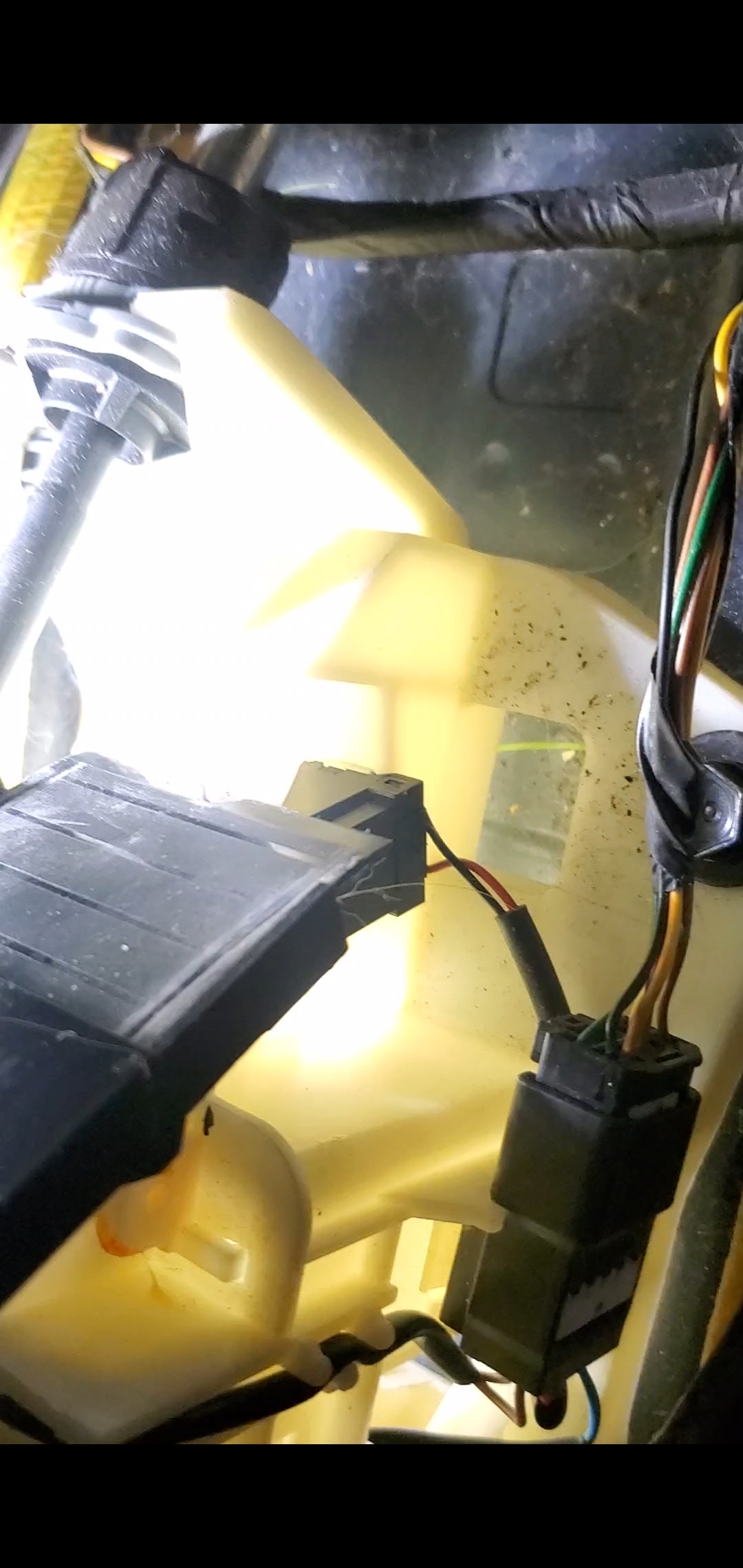

so, once removed console cleaned it up. checked cable and cable bushing, stepped on brake with KOEO and tried to shift no luck. Also, besides hearing the click by the steering wheel. in the back of the shifter when I attempt to shift, I hear the clicking and see the part work, looks like a open relay. i then disconnected connector and tested the red and black wire coming from the car and there was both ground and battery voltage, plugged it back in, tapped on solenoid and, still nothing. I'm leaning towards the shift solenoid. but Hyundai said it's $100.00 and no returns if order it. So, I want to be sure. The guy at Hyundai said from his image for the part it looks like its pigtails in to wire connector. would I remove the white tab on back of main connector on shifter and then remove wires to solenoid and plug the new ones in? I don't know what the other wires on the shifter go to but will look at diagram. Any other test i can do to test solenoid.
Is the shift solenoid supposed to operate once step on brake?

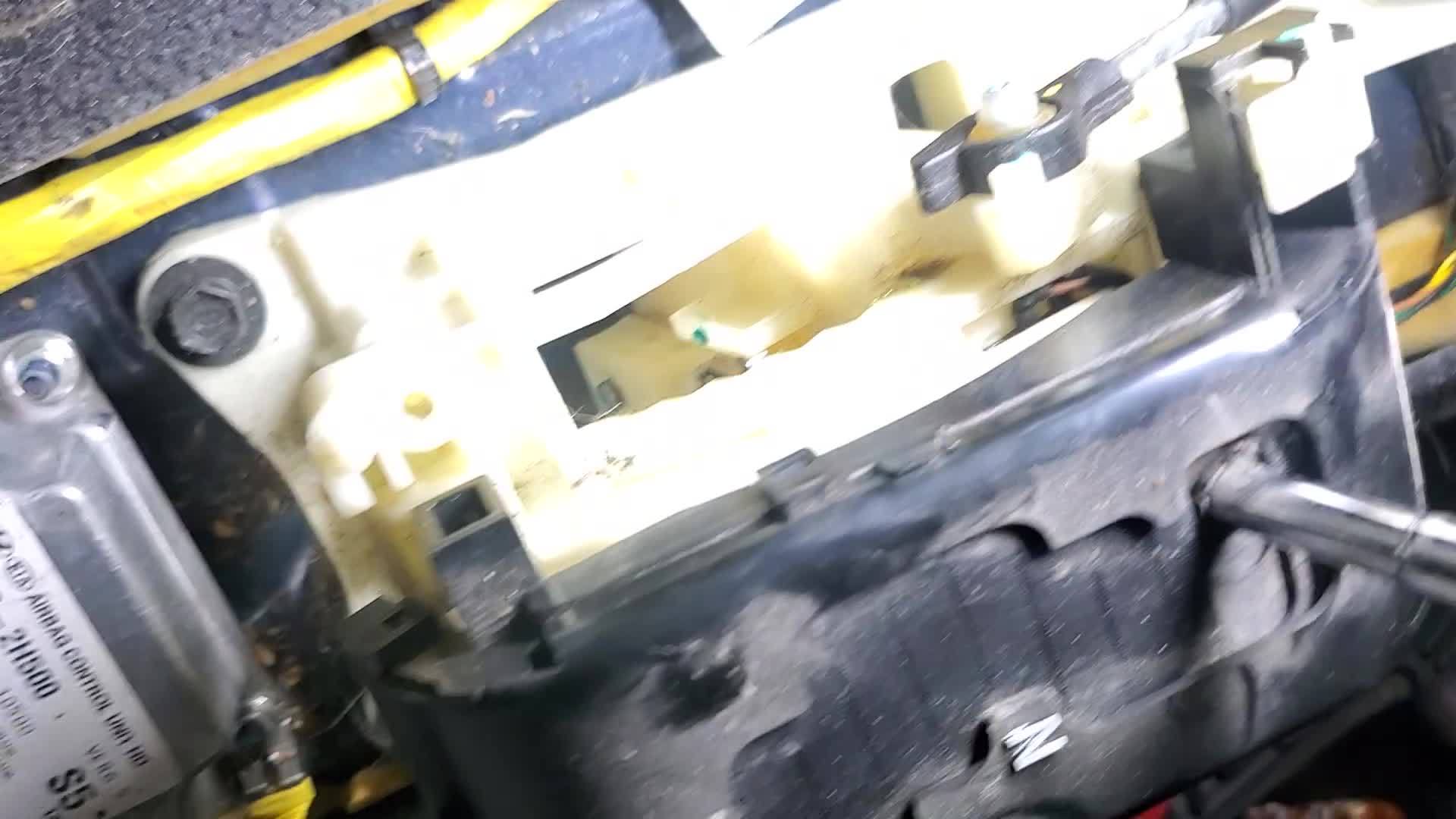

Updated part 2 of last reply.
I tried to attach more pictures or edit the previous reply, but it wouldn't let me.

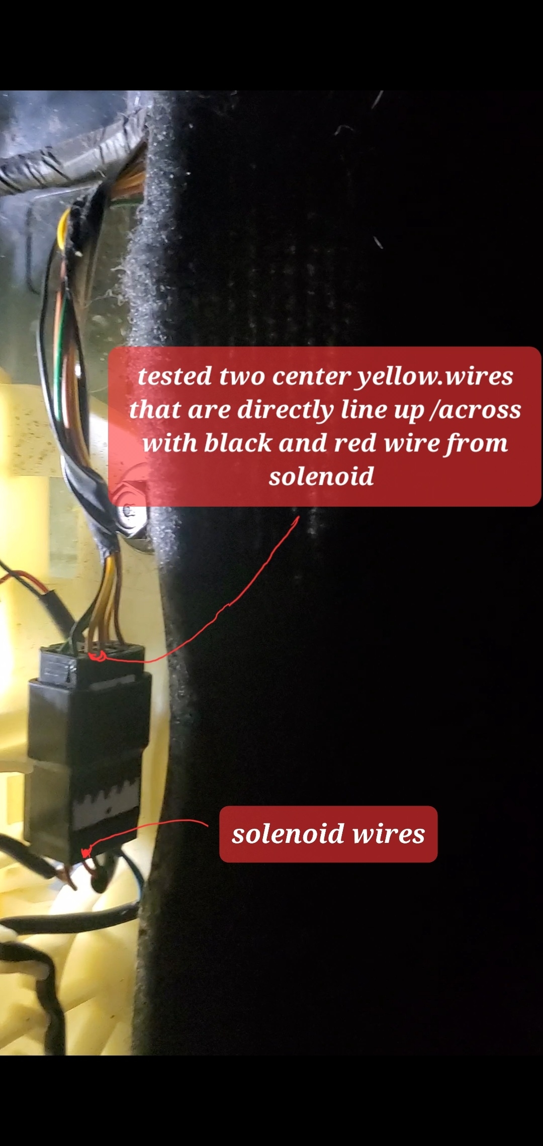

When I had everything apart, i tried stepping on the brake both with KOEO and with the car running and the solenoid didn't do anything, it moves when you apply a screwdriver to the shift release lock.
Correction from last reply, i tested the two yellowish/tan wires from the car wire harness that plugs into the connector attached to the shifter with the shift solenoid. those wires match up directly with the black and red wires from the shift solenoid wires. There was power to one wire 12.36 V and ground 0.002 V to the other the wire. i plugged it back in and still nothing.

Thanks for the pics and video, it helps. The fact that you have power and ground, and the solenoid is still not working it tells me the unit is bad. nice gloves I use the same color blue, they really help when working on cars. Let me know what happens.

Update: before uninstalling the old shifter solenoid, i had a power probe and i connected ground to the black wire and gave 12 v to the red wire, solenoid did not move when attached to shifter. replaced the solenoid and didn't work in normal operating procedure. did the same test with the power probe by checking new solenoid connected to car and it moves the shifter release but still won't shift normal operating procedures. I have to still push shift release to shift gears out of park. Also, for good measure i tested brake light switch with old and new switch and still nothing. i did disconnect battery for about 15 minutes and tried to shift it normally, but still nothing.
i know there's the parking control switch under the shifter if that's what the diagram shows and there is 4.5 v on one wire and ground on the other. The two blue wires control that open relay on the other side of the shifter and does engage and disengage when I attempt to shift. I can still here the clicking in the steering column.

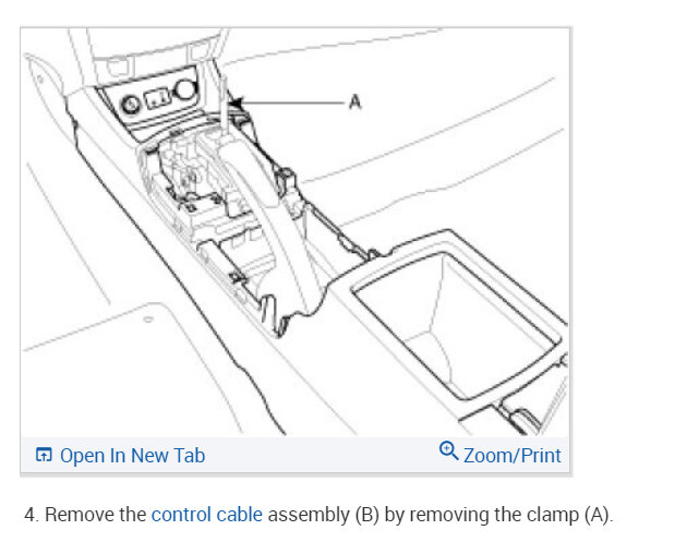

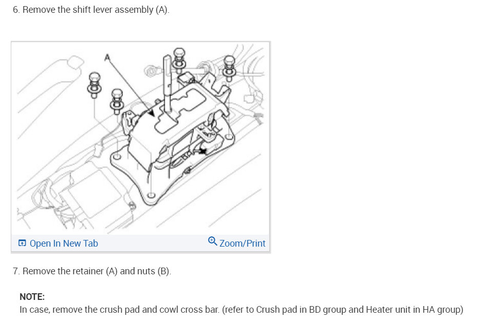

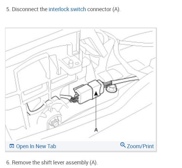

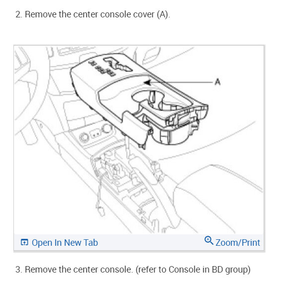

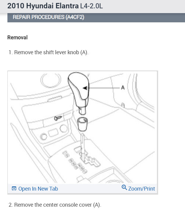

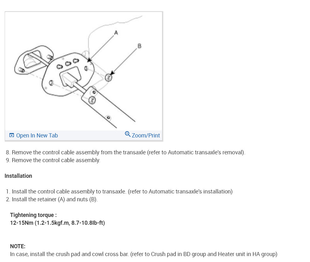

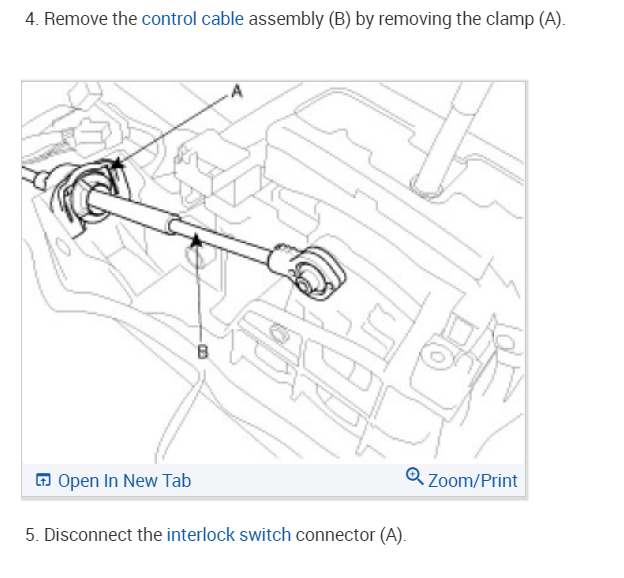

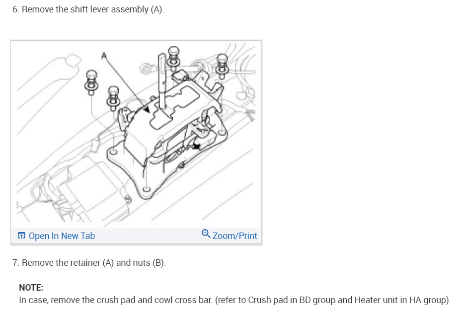

We need to get a visual to see if the solenoid is working, use a flashlight to see if you can tell what is making the noise? Here is how you can disassemble the shifter in the images below. Check out the images (below). Let us know what happens and please upload pictures or videos of the problem.

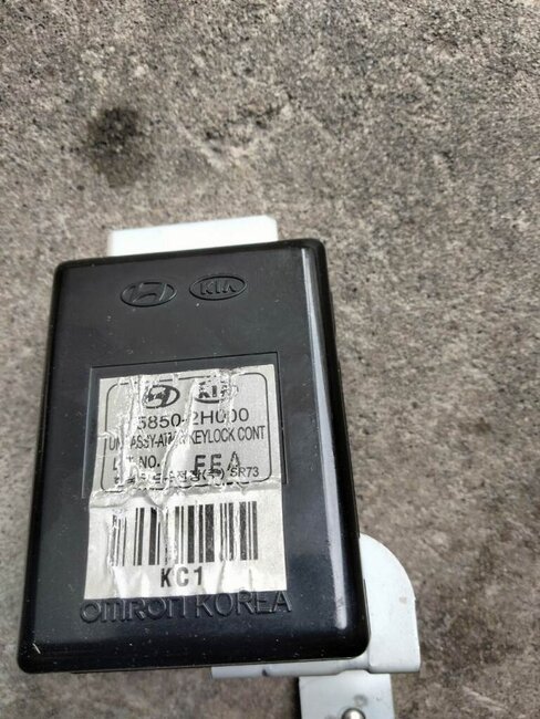

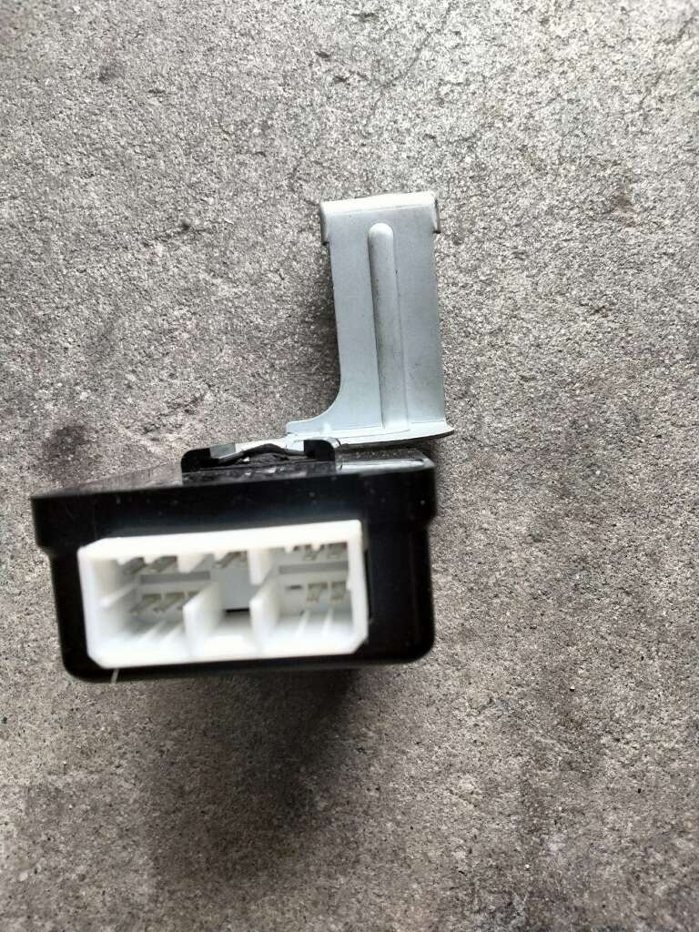

Good afternoon. He did get his car fixed. Thought I submitted a response. First off thank you to all that helped me on my brother's car.
I did end up having to take it in due to my time limit. Checked all fuses thought it was shift control solenoid since it wasn't moving when placed power to it by stepping on brake pedal . It was weird due to the fact that it did have power to it and also when i took power probe sent power to the solenoid it barely moved. So, replaced that for 100 dollars . Part from Hyundai.
His was a transmission solenoid control module. Thay may not be the correct name but its Located by the fuse box. It was a 100 dollar part from Hyundai
Hope this helps
I will post a picture of it with the correct name .

This is the part located by the fuse box and under the dash.
Oct 24, 2022 at 4:49 AM
  • 55,224 POSTS

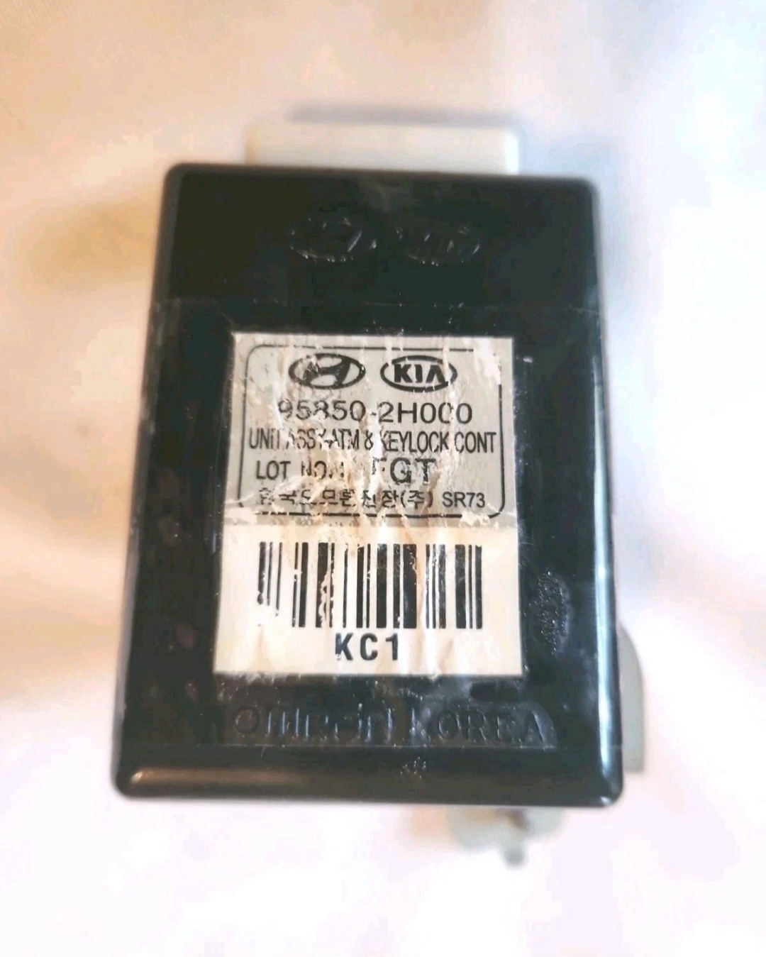

Thank you, that is the lock control module.
Oct 25, 2022 at 6:44 AM
EDRIVERS
I just want to Thank you so much for this post. I ran to the same problem and I really thought it was the transmission gone bad. I did my research and ran across this post after reading it I went to my local junkyard and purchased Hyundai Elantra 958502H000 95850-2H000 ATA Key Lock Control Module and luckily it worked and fix my problem.
