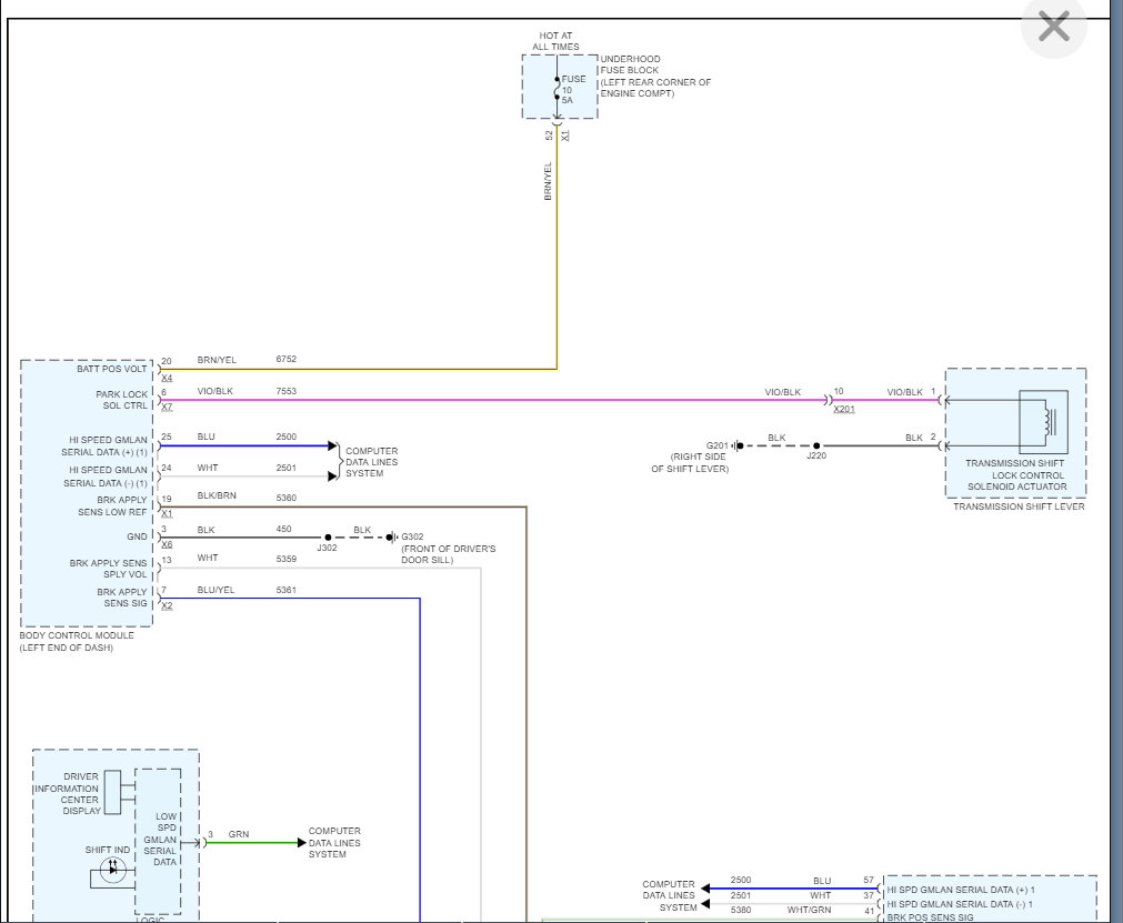

What we need to do is start with checking voltage to the solenoid just to make sure the connections are tight, and it is getting the signal to release.
Here is a guide that will help with this type of testing:

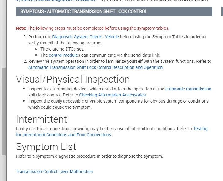

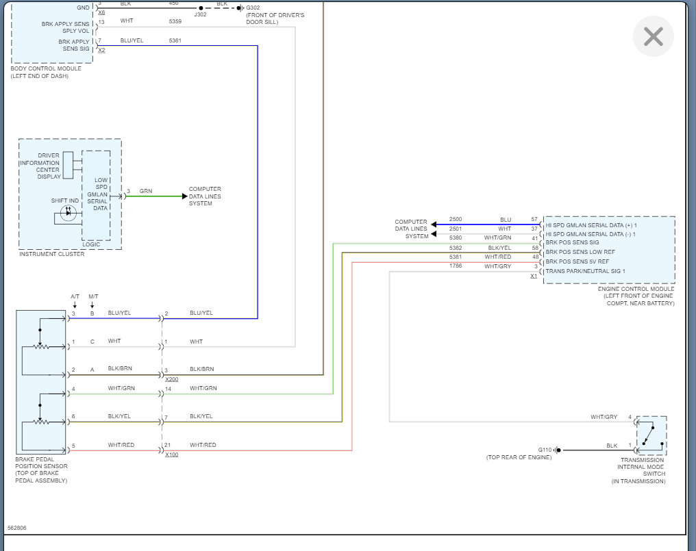

Below is the wiring diagram and the testing from the manual.
It wants you to check for codes as well so here is some info on how to do that as well:
Please run through this info and let us know what you find. Thanks
