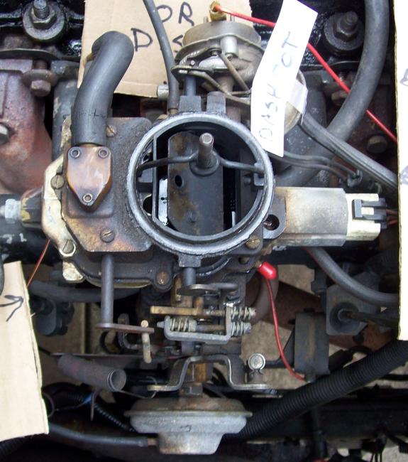

REASON(S) FOR DOWNGRADING TO A SINGLE BARREL? (SPILL YOUR GUTS!)
DID YOU CHANGE THE INTAKE MANIFOLD?
IF NOT, HOW DID YOU ADAPT IT FOR THE ONE BARREL TO FIT?
SINGLE BARREL- WHAT KIND, WHAT DID IT COME OFF OF/ OR WHAT ENGINE/ VEHICLE WAS IT MEANT FOR?
HOW MUCH HAVE YOU SPENT ON THIS PUPPY (PARTS/ WORK) THUS FAR?
3RD PIC- YOUR PREVIOUS CRAPOLA CARB?
YOU MAY HAVE KNOCKED ON THE RIGHT DOOR, DEPENDING ON YOUR ANSWERS
