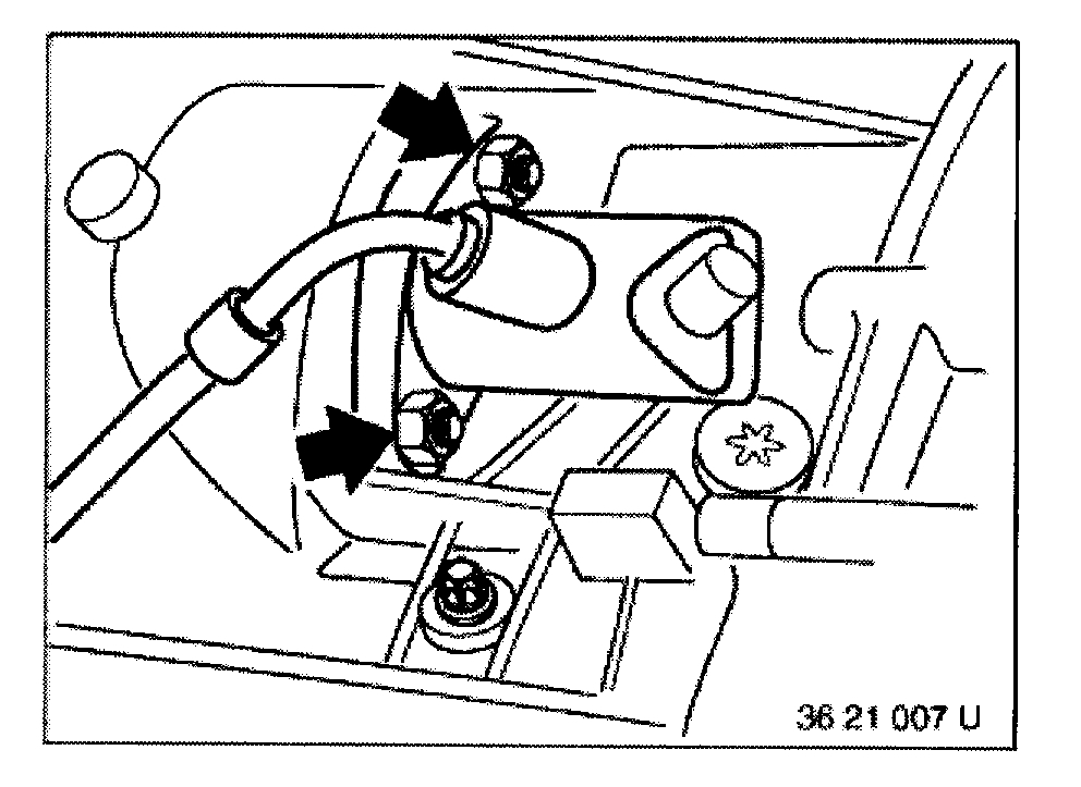

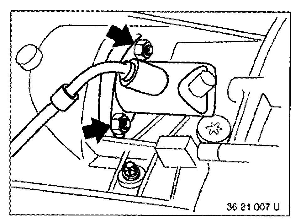

Unfasten nuts and remove clutch slave cylinder (pressure line remains connected).

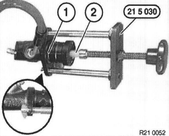

Fit special tool 21 5 030 to the clutch slave cylinder (1).
Press piston rod (2) completely into clutch slave cylinder with the help of the spindle.

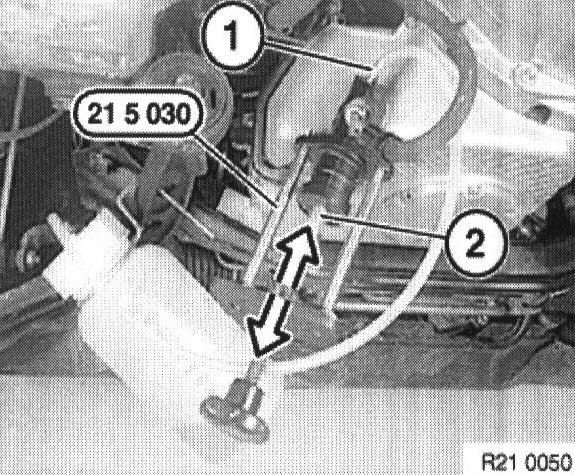

Attach breather hose to breather valve (1).
Hold clutch slave cylinder in illustrated position (refer to figure) with special tool 21 5 030.
Open breather valve (1).
Once brake fluid emerges without bubbles, withdraw piston rod (2) on clutch slave cylinder with the help of the spindle, then press back in.
If no air bubbles escape, close breather valve (1), otherwise repeat this process.
Caution: Never remove special tool 21 5 030 from clutch slave cylinder if the system is pressurized, otherwise the piston and push rod can be forced rapidly out of the clutch slave cylinder.
Switch off breather devise and/or remove from brake fluid expansion tank.

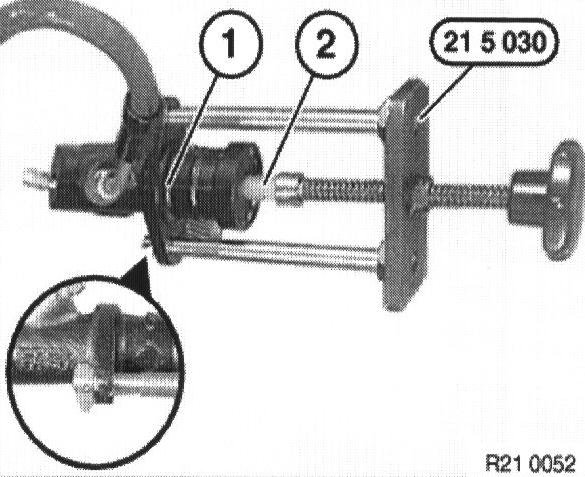

Slowly retract piston rod (2) of clutch slave cylinder (1) with special tool 21 5 030.
Remove special tool 21 5 030 from clutch slave cylinder (1).
pic 5
Fit clutch slave cylinder to the transmission.
