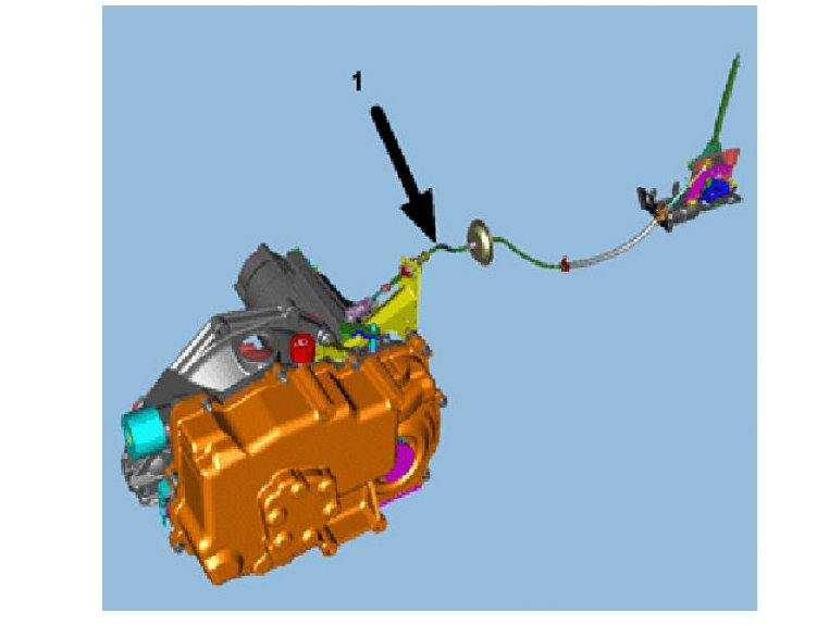

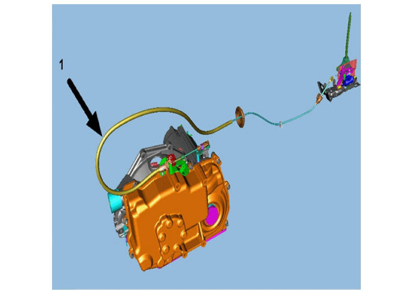

# 14152E: Product Safety - Transmission Shift Cable Fracture - (Jan 8, 2015)
Subject: 14152E - Transmission Shift Cable Fracture Models: 2004-2007 Chevrolet Malibu Maxx 2004-2008 Chevrolet Malibu 2005-2008 Pontiac G6 2007-2008 Saturn AURA Equipped with 4-Speed Automatic Transmission (ME7/MN5)
The service procedure in this bulletin has been revised to include an inspection procedure. Please discard all copies of bulletin 14152D.
Condition
General Motors has decided that a defect which relates to motor vehicle safety exists in certain 2004-2007 model year Chevrolet Malibu Maxx, 2004-2008 model year Chevrolet Malibu, 2005-2008 model year Pontiac G6, and 2007-2008 model year Saturn AURA vehicles equipped with a 4-speed automatic transmission (ME7/MN5). These vehicles have a condition in which the transmission shift cable may fracture at any time. When the fracture occurs, the driver may not be able to select a different gear, remove the key from the ignition or place the transmission in park. If the driver cannot place the vehicle in park, and exits the vehicle without applying the park brake, the vehicle could roll away and a crash could occur without prior warning.
Correction
Dealers are to install a shift cable assembly and mounting bracket.
