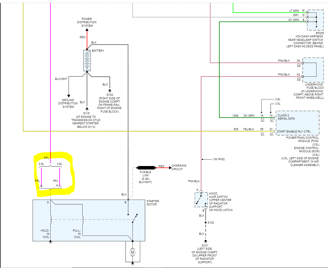

So, I tested all the fuses and relays everything is good. I drove it to store n got back in my car and it won't crank or start, all lights everything turn on. I popped the hood and could smell some kind of burnt smell, but it wasn't any wires, belts or any of my fuses, from what I could see from up top. I tried hitting the starter and still nothing it clicked and that was it. I was thinking maybe a bad connection or my ignition switch is bad, but I don't know.

If all fuses and relays are good, we need to go to the starter motor and check for power. This will confirm if it is the starter or if we need to work back from that point to determine where the power is lost.

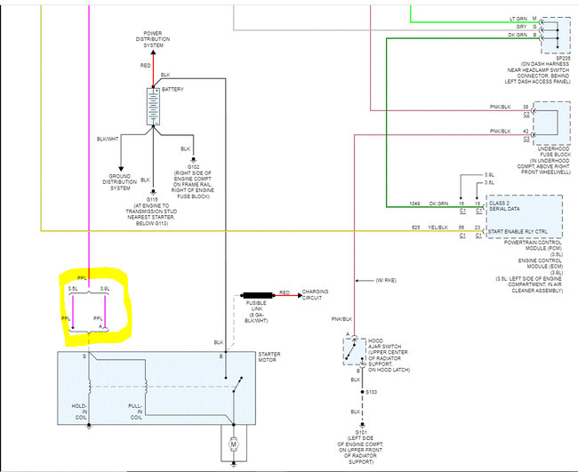

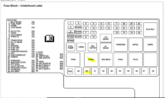

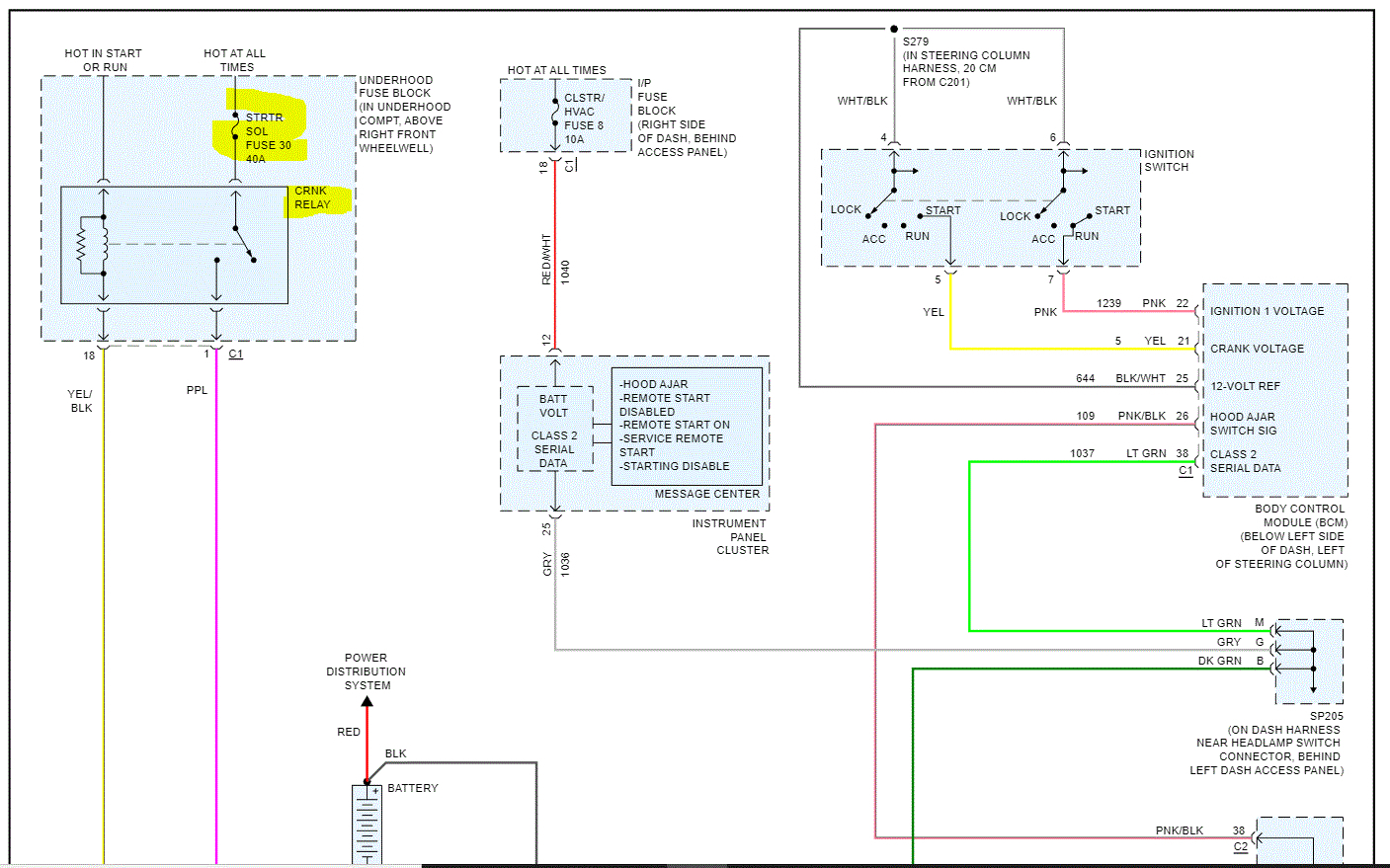

I attached the wiring schematic below for the starting circuit. Note there is a 40-amp fuse (fuse 30) in the under-hood fuse box. I realize you checked fuses, but also make sure there is power to and from it. Here is a link you may find helpful.
If that is good, switch the relay with a different relay in the box having the same part number.
If that doesn't make a difference, we need to check the power at the starter. You will need a helper for this.
At the starter, there are two wires. One is black and the other is purple. The black wire is a heavier gauge wire. It should have 12v at all times. Confirm that.
If that is good, the purple wire will have no power until the key is in the start position. Have the helper turn the key to the start position while you check for power at the purple wire.
Here is a link you may find helpful as well:
Now, if the heavy gauge wire has 12v and the purple gets power with the key in the start position, the starter is the likely problem. However, check this and let me know what you find.

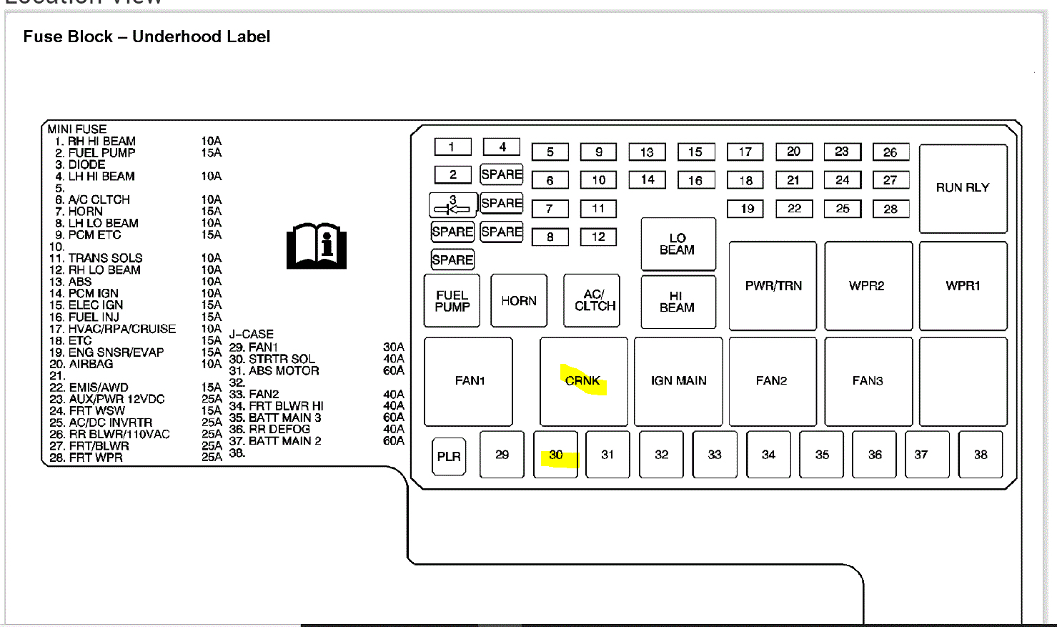

See pics below. Note: The schematic was one page. I had to cut it in half to make it readable for you. I did overlap them. The last pic shows the under-hood fuse box. I highlighted the fuse and relay.

Would the ignition switch be something to check as well? Like if the ignition switch was bad would I still have all lights in the car still turn on?

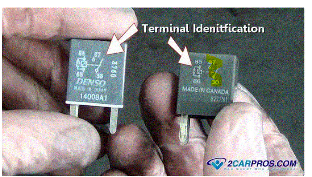

Also, another question? Am I able to jump a wire from the crank relay to see if it engages the starter? Because I looked and there is no starter relay.
Jun 4, 2022 at 5:02 PM
  • 110,244 POSTS
Has the starter ever engaged since this started? If it did, recheck the orientation of the pic and the box in the vehicle. Without that relay, it will never crank. Could someone have removed it?
As far as the switch, it could be bad and still have most of the electrical system working.
The starter relay can be jumped using a short jumper wire. You would need to jump terminal 87 and terminal 30 in the box. See pic below
Jun 5, 2022 at 3:26 PM
ALAMAHOWARD93
  • 7 POSTS
Nope, it didn't make any sound it clicked once when I jumped the wire.

It sounds like the starter is bad. If you jumped power at the relay directly to the starter trigger wire, it should have engaged.
Was there power at one of the terminals you used when you jumped at the relay?
Let me know that. Also, here is a link that explains how to replace a starter motor. At this point, I would remove the starter and have it bench tested at a parts store. They should do it free of charge.
Keep in mind, you must make sure the battery is disconnected before working on the starter.
Let me know what you find.

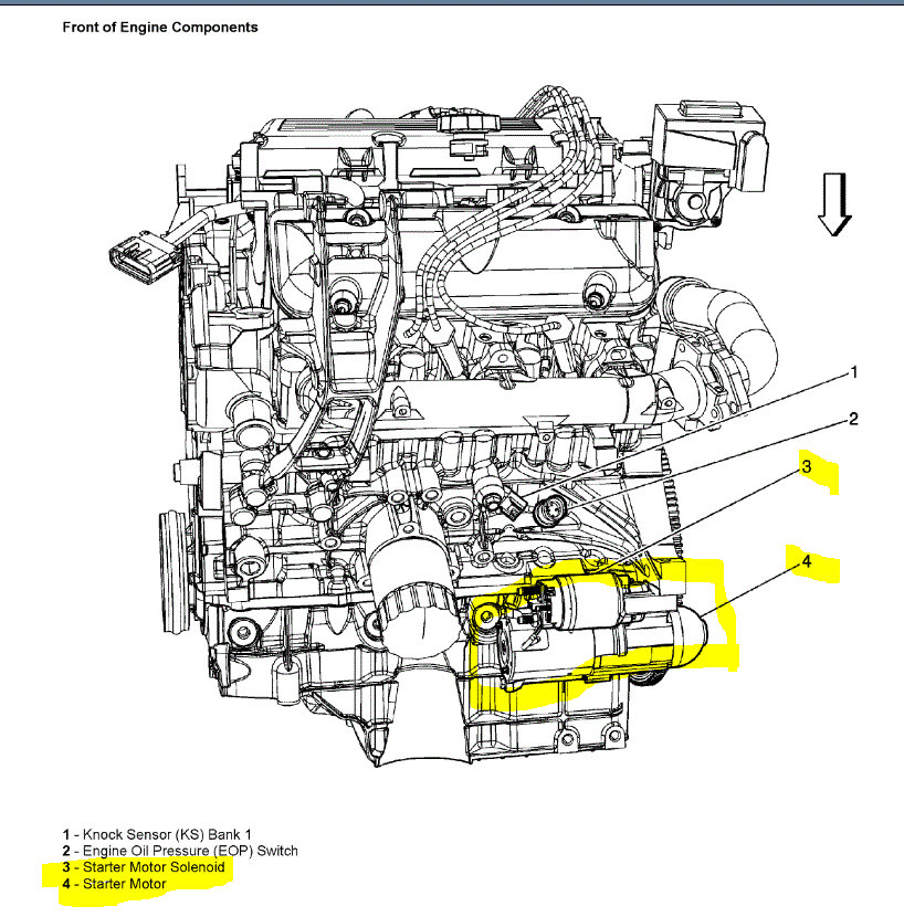

See pic below. It shows the location of the starter motor.
Jun 6, 2022 at 1:30 PM
ALAMAHOWARD93
  • 7 POSTS
Yes, I it had power it just made a click and i can smell burnt smell by starter and whoever wrapped the wire that goes to one of the cooling systems used some kind of foil type tape. that was next to the starter connector. so, I'm thinking it's what probably burnt the starter up.
