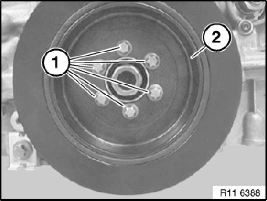

I have been driving in the motorway and the engine light came on and the oil light at the same time. I pulled over and stopped the car and I tried to start it back. it won’t start. when I press the start button you can hear a ticking going on but the engine doesn’t spin at all. I have checked with a mechanic and I did what he told me to put the negative of the engine to the battery, but it didn’t work. I could smell a cable burning and smoke came up and. I don’t know what to do now it doesn’t crank at all.

First and foremost, if you see smoke and smell wires burning, disconnect the battery. Otherwise, you could end up with a fire.
Now, when it shut off while driving, did the oil light come on and then the engine shut off? Is there oil in the engine? If you were out of oil and the engine locked, the starter won't be able to turn the engine and it will draw too many amps from the battery. This could easily start a fire.
With that being said, I suggest seeing if you can turn the engine crankshaft by hand using a large wrench. If you can, remove the starter and have it tested.

Okay, since the light came on prior to you turning it off, it may have been out of oil or extremely low. Check and confirm the oil level in the engine and let me know what you find. Also, see if you are able to turn the engine at the crankshaft using a wrench. I'm worried that the engine may have seized and that is why the starter is getting extremely hot and not able to turn the engine.

I cannot check the oil level it doesn’t have a dipstick 1series have it from the odometer and how can I turn the crank shaft ? Thanks

The crankshaft pulley is at the front of the engine at the bottom. It will have an accessory belt routed around it to operate the alternator, power steering. In the center of that pulley is a large bolt which holds the dampener and pulley assembly on the crankshaft. Get a socket that fits that bolt and a long handled ratchet or breaker bar and see if you can turn the engine (you will see the pulley turn if it turns).
I attached a picture of a common BMW crankshaft pulley. You want to try turning it from the larger center bolt and not the smaller ones with the arrows pointing to them.
Let me know if this helps.
