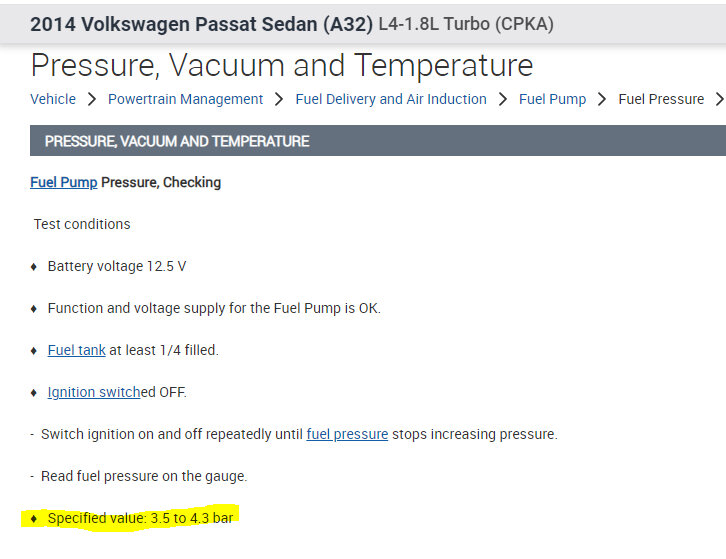

I recently changed the battery on this car and now it just wants to stop running. It will start, go for a minute and then just shut off. It shut off on my way to work and would not restart, even after a jump! When we got it home, it started right up but then after a few minutes it shut off. The battery is good, and the alternator seems good as well. What could it be??

Is there any indication that the anti-theft is actuated? Also, does it only happen once the engine warms up? Also, did this just start after the battery was replaced?
If it was happening prior, take a look at this link and let me know if it mirrors what you are experiencing:

Thank you so much for answering! Yes, it stalled a few times before the new battery. Started happening end of summer Aug-Sept. We are in Arizona very hot (the battery wasn't "dead" bad, but we figured it was part of problem and this is why we replaced it) After new battery, we drove to Disneyland and back with no problems at all. The link you sent makes so much sense! We are going to replace this sensor. I'll let you know if it fixes the problem in a couple days. Thanks again so very much!

Well, we changed out the crankshaft sensor and it seemed to work. However, when we went to road test it, as soon as he hit the gas to speed it up it shut off. It started right away, went a few feet, then shut off again. Then it would start, shut off, start shut off then didn't want to start at all. Had to push it back home. G was driving, I was passenger and to me, it felt like it wasn't getting gas when it shut off the first time, like it couldn't handle the pedal to metal acceleration. No lights came on. Battery still good. Because we haven't been able to drive it anywhere, we can't get any codes to come up either. Guess we should probably check the fuel pump? Or have you heard of this problem needing something else? Any help is appreciated.

I think that is a good idea. It may be weak. As far as testing it, here is a link to help:
The specifications indicate 3.5 to 4.3 bar. That is around 60 PSI. You will need a fuel pressure gauge. If you don't have one, most parts stores will lend one to you.
Let me know what you find.
See pic below.

Starting to wonder if it's something that shuts it down when warmed as well. We'll test the fuel system in the next few days. Thanks for the link, we'll keep you in the loop.
