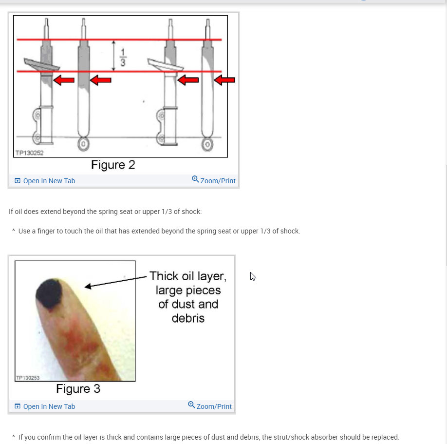

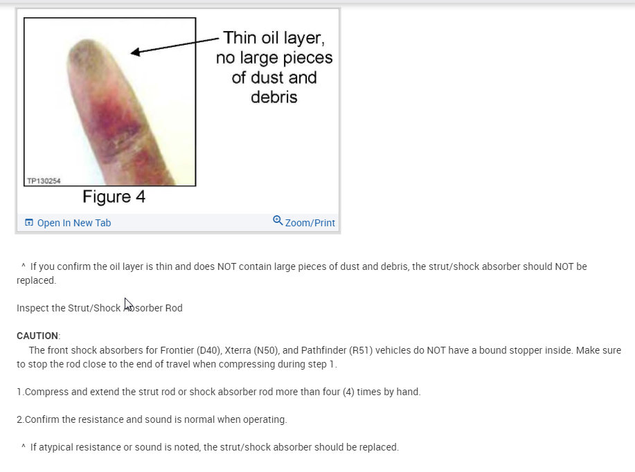

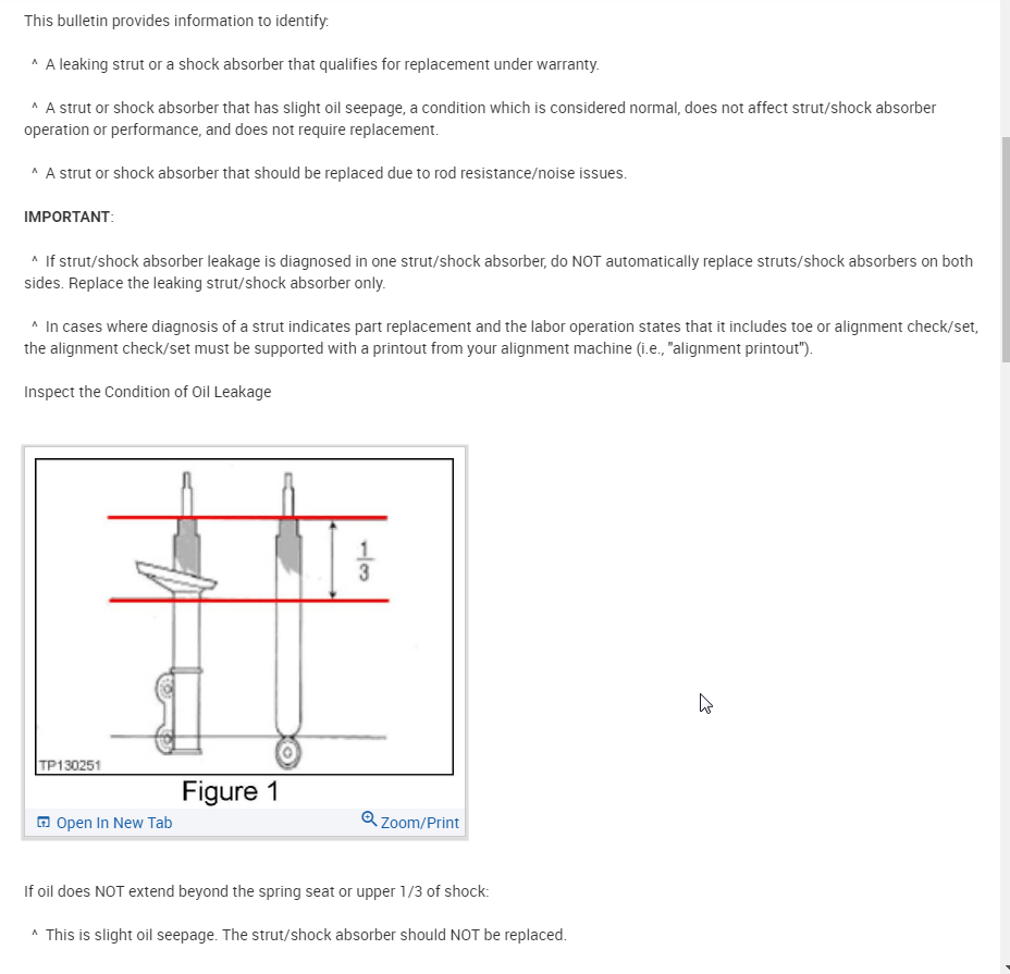

I am not sure I completely understand what you are experiencing but have you checked the shock absorbers? If you have one or more that are leaking, it will cause the vehicle to bounce or feel like it is less stable. They can also make noise when hitting a bump. I didn't read that so I am not sure this is your issue but we need to eliminate it to make sure.
https://www.2carpros.com/articles/replace-shock-absorber
If this is not your issue is there a way to get a video of what you are describing? I just want to make sure I understand what you are experiencing. Thanks
