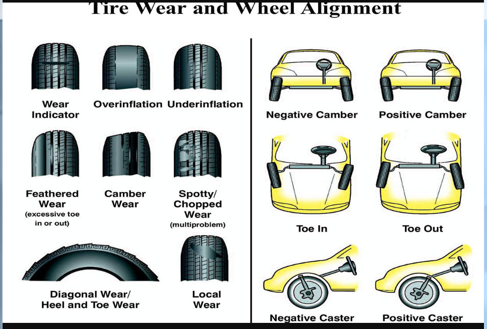

I would lift each tier off the ground and find out if the tire is loose in any way when pushing and pulling the tire at 12 and 6 o'clock and then at 3 and 9.
Also, are the tires showing any kind of wear on them? That will give us a good idea what the issue could be.
Please see the chart below and let us know what you find with this. Thanks
