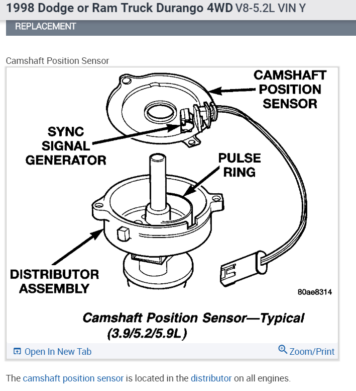

I got a p0340 code cam position sensor. That is what I was looking for I do not remember what site it was. But I had the same thing looking for a 02 sensor and some other parts. Thanks for checking.
Nov 6, 2018 at 9:58 PM
  • 55,433 POSTS
You do not need to replace the distributor they service the sensor separate. Here are instruction and diagrams to help you get the job done:
REMOVAL
Distributor removal is not necessary to remove camshaft position sensor.
1. Remove air cleaner assembly
2. Disconnect negative cable from battery.
3. Remove distributor cap from distributor (two screws).
4. Disconnect camshaft position sensor wiring harness from main engine wiring harness.
5. Remove distributor rotor from distributor shaft.
6. Lift the camshaft position sensor assembly from the distributor housing.
INSTALLATION
1. Install camshaft position sensor to distributor. Align sensor into notch on distributor housing.
2. Connect wiring harness.
3. Install rotor.
4. Install distributor cap. Tighten mounting screws.
5. Install air cleaner assembly.
