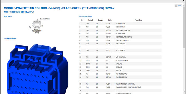

I recently changed the computer on my car listed above Touring. The adapters were kinda weathered in place i did what i could to remove them with out very much damage and i was successful. now I'm looking to replace that wiring harness. What is the name for it, where could i get it and how much do they run? I haven't had any luck finding one on my own.

PCM engine computer.. it has the 2 really big harnesses.

Okay. There are many different part numbers depending on how your vehicle is equipped. Do you mind sending me the last eight of the VIN and I will be able to get you specific part numbers for this. Thanks

7N556197.

Sorry for the delay. Looks like the engine and body harness are the ones that you need.
04795736AD - Engine harness
05084723AD - Body Harness
The unfortunate thing is that these are not available any longer. I ran a quick dealer check and there is no inventory at any dealer either.
This leaves the aftermarket or junk yards. Normally aftermarket parts companies don't supply harnesses because they are bulky and not highly demanded. Which leaves finding a used one. Your best bet is to find the vehicle and taking what you need off of it. If you don't need the entire harness as it sounds like you just need the connectors then cut them off the other vehicle and just solder them onto your vehicle.
Your other option is to go to Mopar's connector website linked below and look up your vehicle. Then you can find the PCM connector and look for the part number. I attached an example. If you look at the top right where it says full repair kit number, that is the number that you need to order from a Chrysler Jeep Dodge Ram dealer.
http://connectors.dcctools.com/home.htm
Let me know if you have questions and we can go from there. Thanks

Man you're too awesome. Mine still works like i said i just wanted to make it look prettier, i sure will look at the info you sent me thanks. If i ever see you in this life, water, coffee beer or liquor on me.. thanks again.
