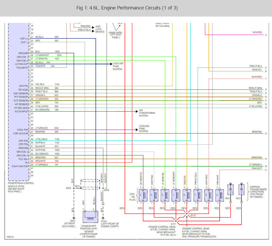

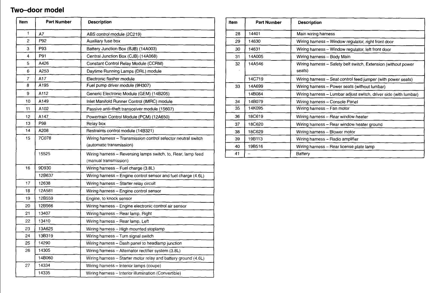

My car is the GT model. Someone cut my wires before the connector on the main wiring harness that control fuel injectors coils that are one for each plug cold air intake, also plugs in to alternator and other things. Can I see a diagram or something showing which wire goes in each hole? It is 42 pin connector but only like 32 are used on the passenger side coming out of firewall. At top of firewall is cut before that connector. Please help! I really cannot read schematics showing the color wire to each hole. Would help a lot if you can help.

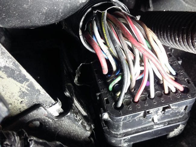

Could you take a picture of what was cut off and post it here? I am not sure if you mean they cut off the connectors at the sensors or the bulkhead connector or somewhere else. There are numerous sub harnesses used so it would be very likely you would not need to change out the entire harness, just the section(s) that are damaged.
Overall you would be better off to go to a salvage yard or online and see if you can find an intact harness and use it. Even if you have to spray the connectors with cleaner it would likely take less time.
Some of those wires are very sensitive and a splice could alter a signal enough that it will not run.
For diagrams you can try http://bbbind.com/tech_database.html
Make sure you select wiring diagrams.
Then select the ones you need. There are something like 45 files, most have between 1 and 20 pages each.

WORMY14U
  • 6 POSTS
Before this connector

OK, Follow that harness out to the next connector and then compare it to the chart to see which harness section(s) are the damaged ones. Then you can look up the correct harness diagram on the above link.
I doubt you can still get the harness through Ford but with the part number(s) you can call them and search online.

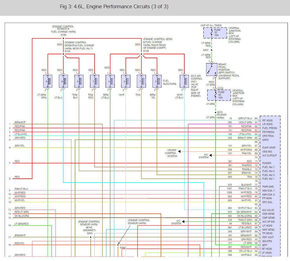

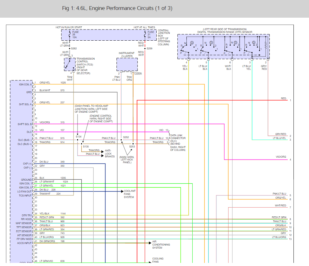

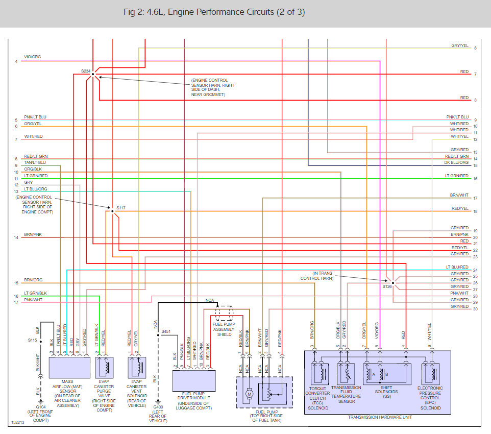

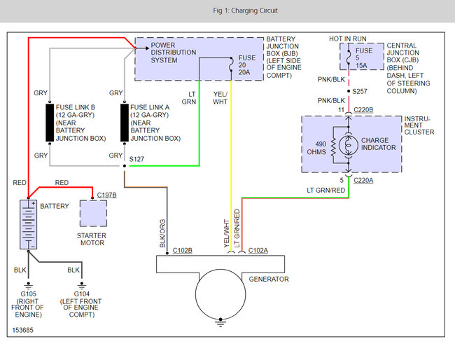

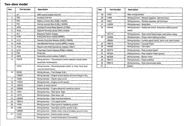

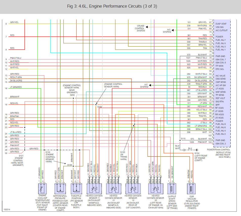

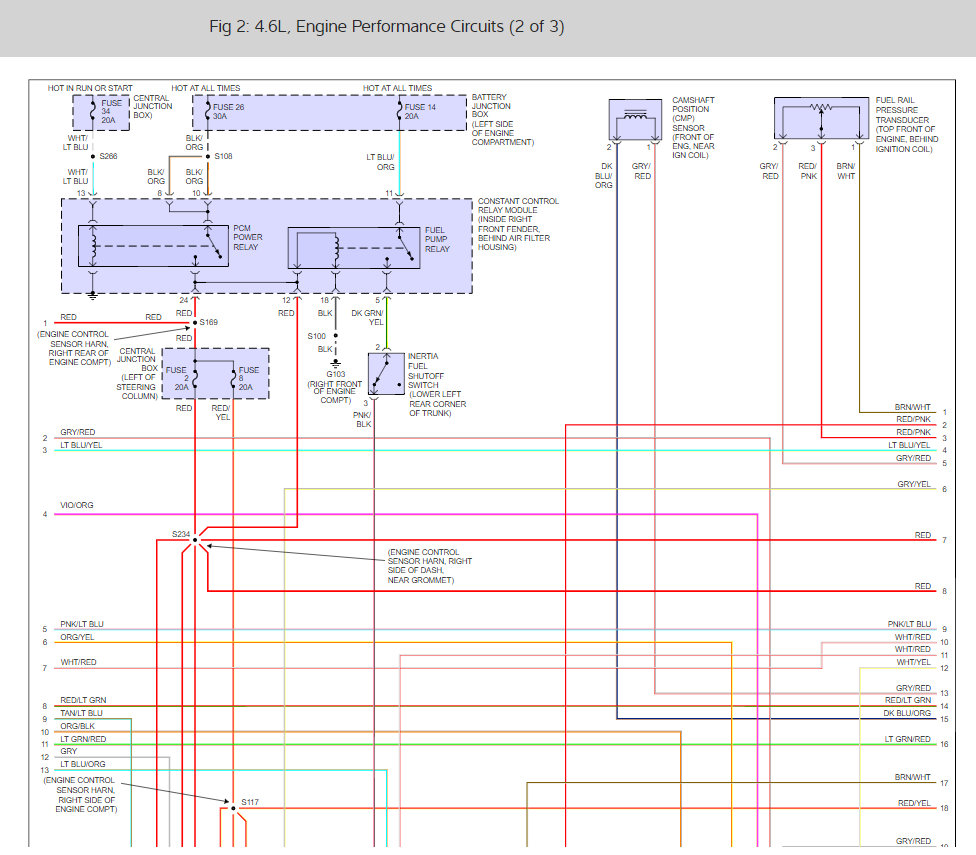

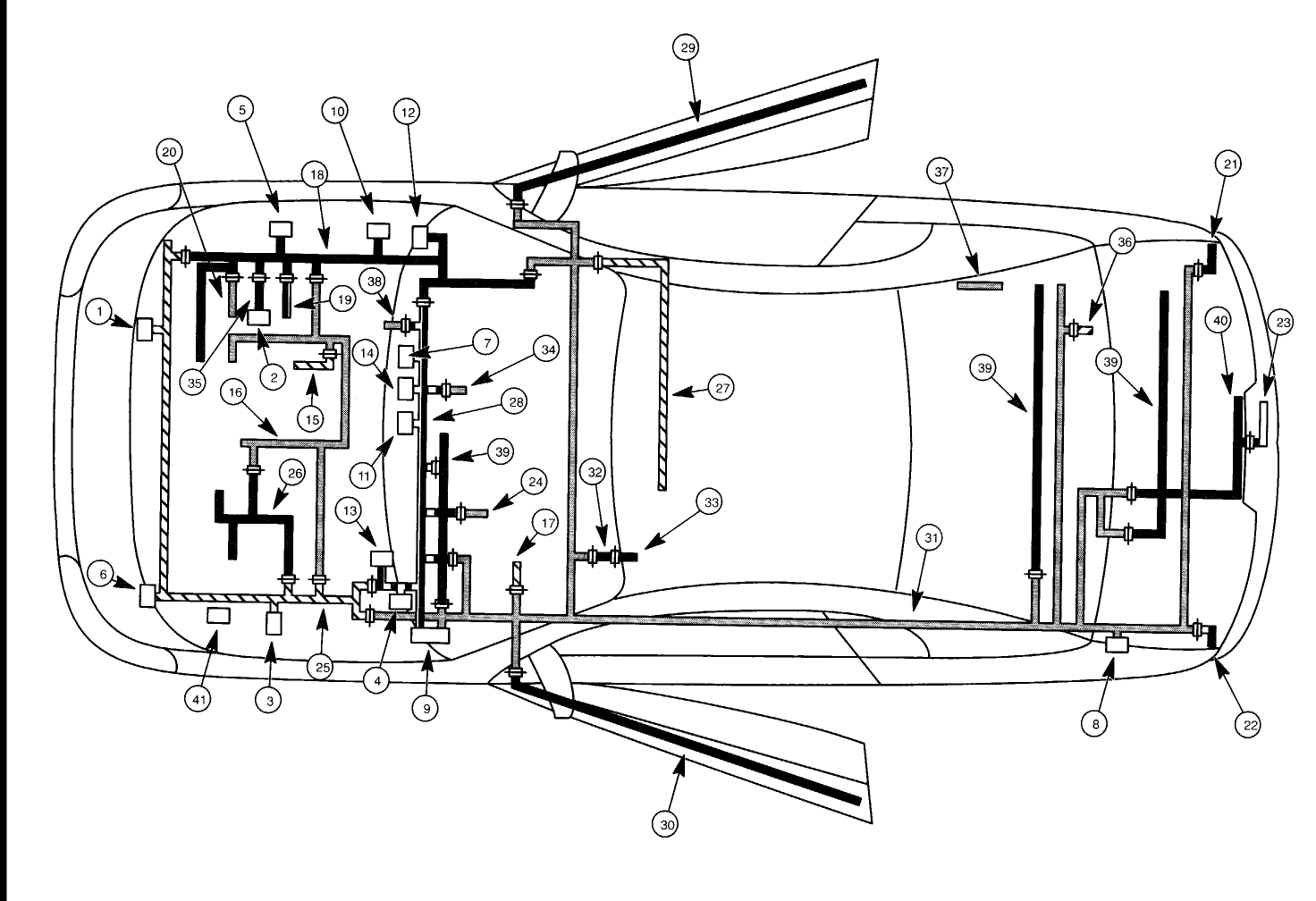

We do not have pictures but we do have colored wiring diagrams so you can see what goes where. Here are the diagrams (below):
Wednesday, September 20th, 2017 AT 11:37 AM (Merged)

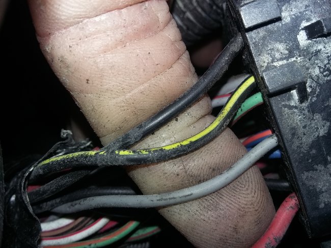

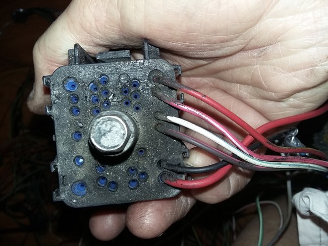

I have never read, but I know mine has 32 wires coming to it its 42 pin and 32 wires. Here is picture and a partial picture I think these wires are right.
WORMY14U
  • 6 POSTS
And the red is hole 42 red and white 41. The red beside black 34 black 35 and grey red 38 I am positive white with blue 39.

Yes, that can change colors going through a bulk head connector like that. More pictures further down the harness would be better too.
