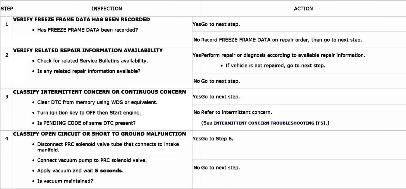

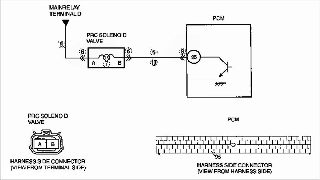

Having a code p090 come up if there’s any way, I can get the wiring diagrams in reference to this code so I can see if there’s a short or open ground.
Jan 23, 2023 at 2:38 AM
CARADIODOC
  • 34,381 POSTS

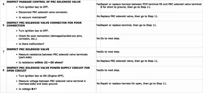

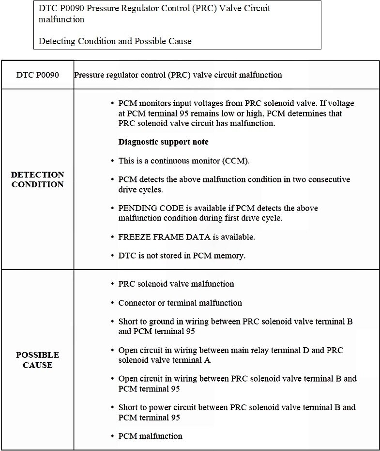

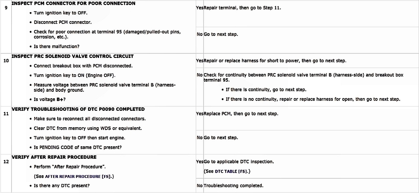

Here's the diagnostic chart for this fault code. The second panel shows the related part of the circuit. If you need more of the Powertrain Management diagrams, let me know. There's over a dozen diagrams I'll need to copy and format.
