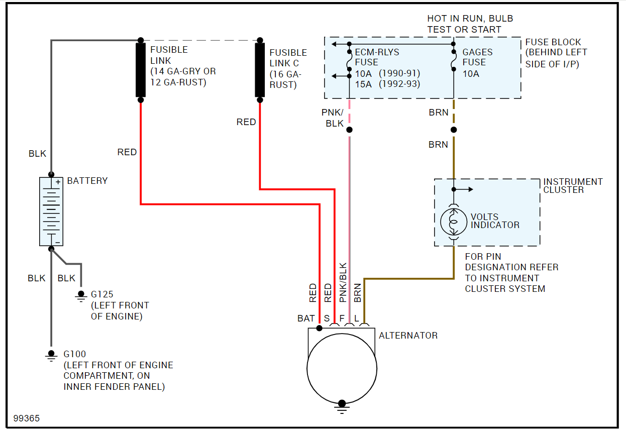

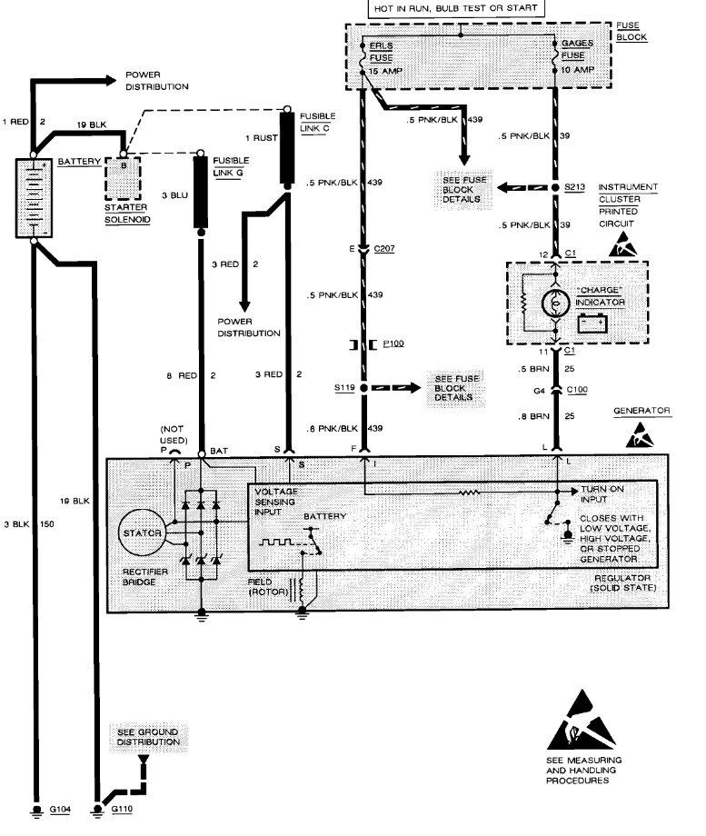

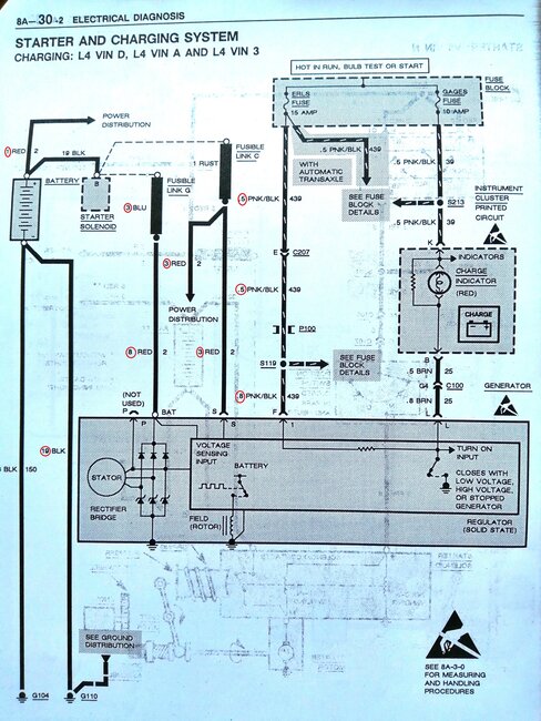

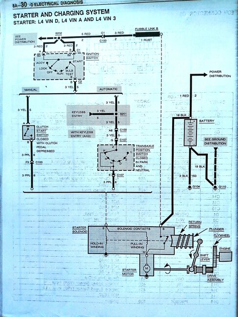

There are numbers on the wiring diagram. I have circled them. What do these numbers mean on a wiring diagram? Is it the cross-sectional area of the wires? Is it the diameter? What are the units of measurement? And how do you convert it to mm²?

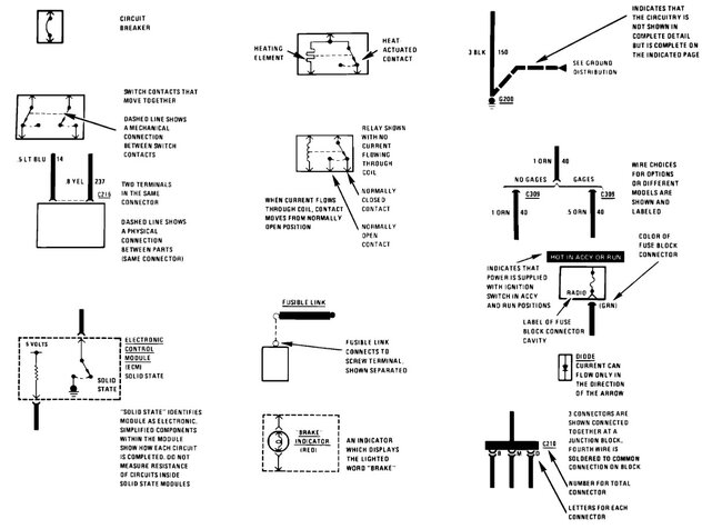

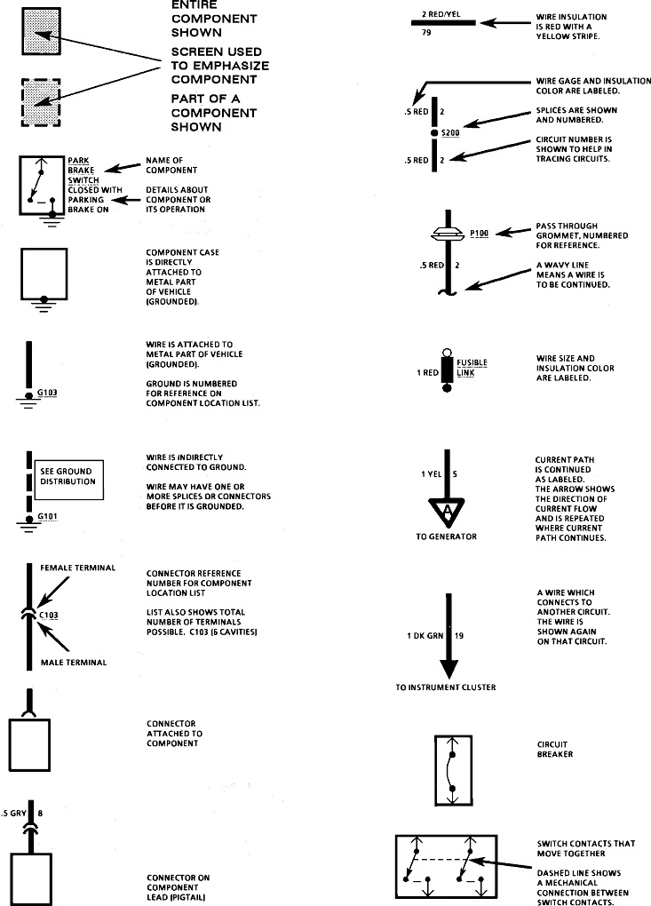

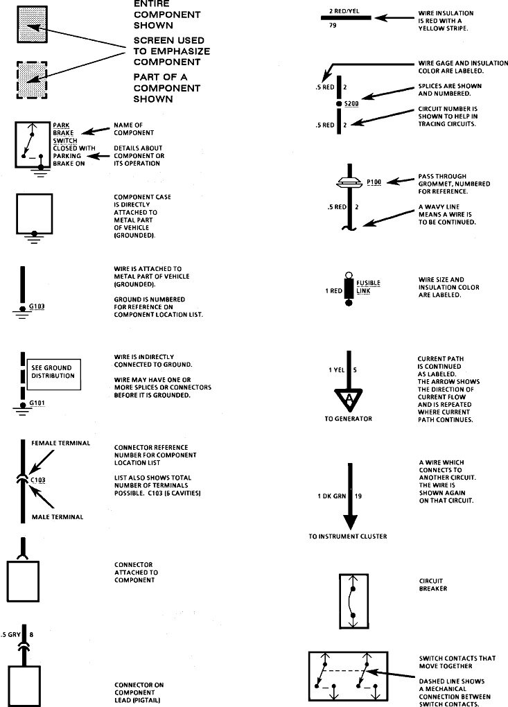

I can't read it, here are the wiring diagrams from Alldata. They don't tell us the gauge of the wires; can I ask what you are trying to do? Here is what they show us. Check out the images (below).

The numbers on that diagram are the metric diameter of the conductor inside the insulation. so a .6 would be .6mm or 22awg.

The wires from the battery to the starter are labeled as 19 BLK. Of course, these wires must have a large cross-section. Maybe the number 19 means the cross-sectional area? Maybe it means 19 mm? (The diagrams are taken from a 1993 US car repair manual).

19 mm2.

It is 19mm if you were to cut the wire and measure across the diameter of the exposed copper. The insulation isn't included in the measurement. The images I posted are from the same GM manual. The first three are the definitions for the items in that manual. However, that is not a universal guide as other makes and even other models in the GM line use some different symbols. Others just show the wire color in the diagrams and then use a call out list to give the sizes and others only show the colors. Then there are the various layouts as well, Imports for example use what are known as track diagrams like the attached.
If you want to really learn about how to read them there are multiple videos out there showing the various types and how to read them and what all the symbols are. Also, the diagram for one year may not be the same as another year.
One hugh thing to keep in mind about all wiring diagrams, there may be mistakes on them, that one can catch you really quick.

The diagrams are taken from the book (photo). There are a lot of wiring diagrams in this book. It is unlikely that there are any errors. The diameter of starter wires 19 mm for this car is too much. This cannot be. If we assume that the number 19 means the cross-sectional area, then the diameter will be about 5 mm without insulation. It seems to be realistic. Just in case, let's take one more designation. For example, wire 3Yel5 (or 3PPL6). Assuming that the number 3 is the cross-sectional area in mm2, the diameter is about 2 mm without insulation. Also, realistic. Similarly, you can take other wires, there is the same dependence. What do you think?

Believe what you want, I have seen errors in multiple diagrams over the years, both in the OE and redrawn diagrams. 19mm are the main battery cables, which was the design specification and on that vintage would be a heavy cable. It is not any measurement but the diameter. Nothing else.
Do you actually have a problem?

Most cars have battery cables with a cross section of less than 25mm2, which equates to a diameter of less than 6mm. A 19mm diameter would be fine for maybe a WW1 tank! Thanks, I've already made up my mind and don't need anything. Unfortunately, you are wrong.

Modern cars have the wires based on actual loads, which didn't start happening until the late 90's when companies also started splitting the cable so that one went to the starter, and one went to the fuse box. That allowed them to use a smaller main cables that you see on today's cars. The standard for years was a 4/0 AWG cable with some even larger. Those went to the starter main stud which was also the main power feed for the entire vehicle. They used the large size because of the larger engines taking high current to rotate the starter. These days many use 2 or even 3 cables that are between 4 and 6 AWG. That was all in a cost cutting plan, not really sure how that worked out because modern cars have about 4-5 times the amount of wire in them as pre OBDII vehicles and with the increased complexity of networking and security in 2018 and up vehicles is making them much harder to diagnose because of the multiple modules involved in a single system. This has also lead to the use of much smaller wire sizes, where it was common to see 14 AWG for things like taillights now you see a single power feed to a module and then an individual 20 or 22 awg wire coming from the module back to each function in the light.

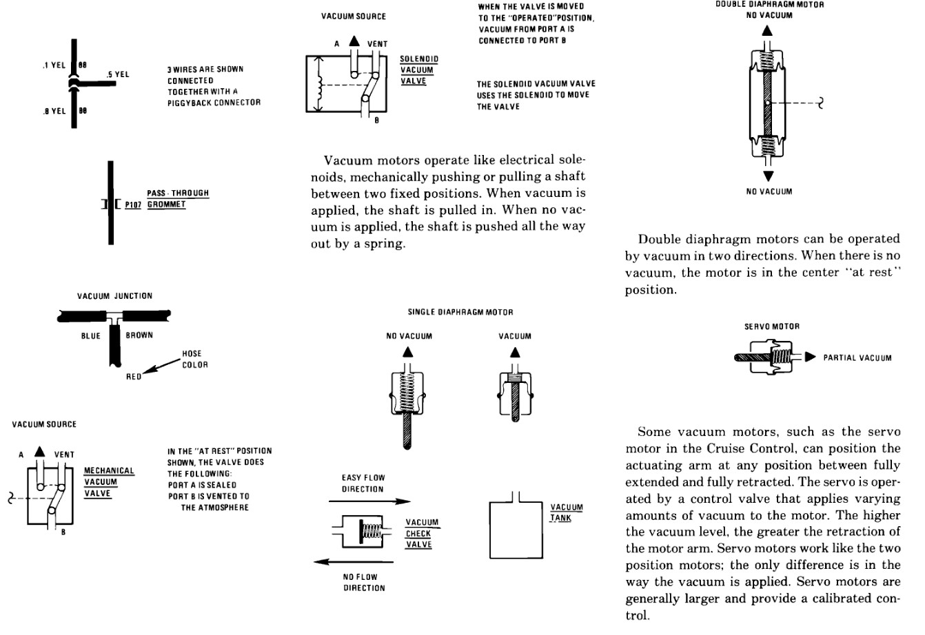

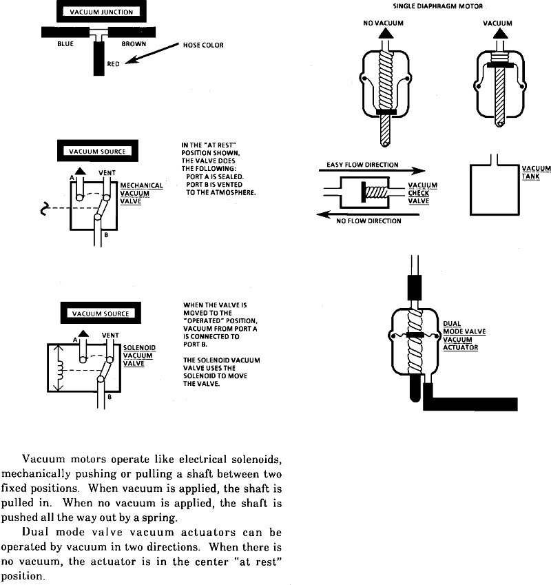

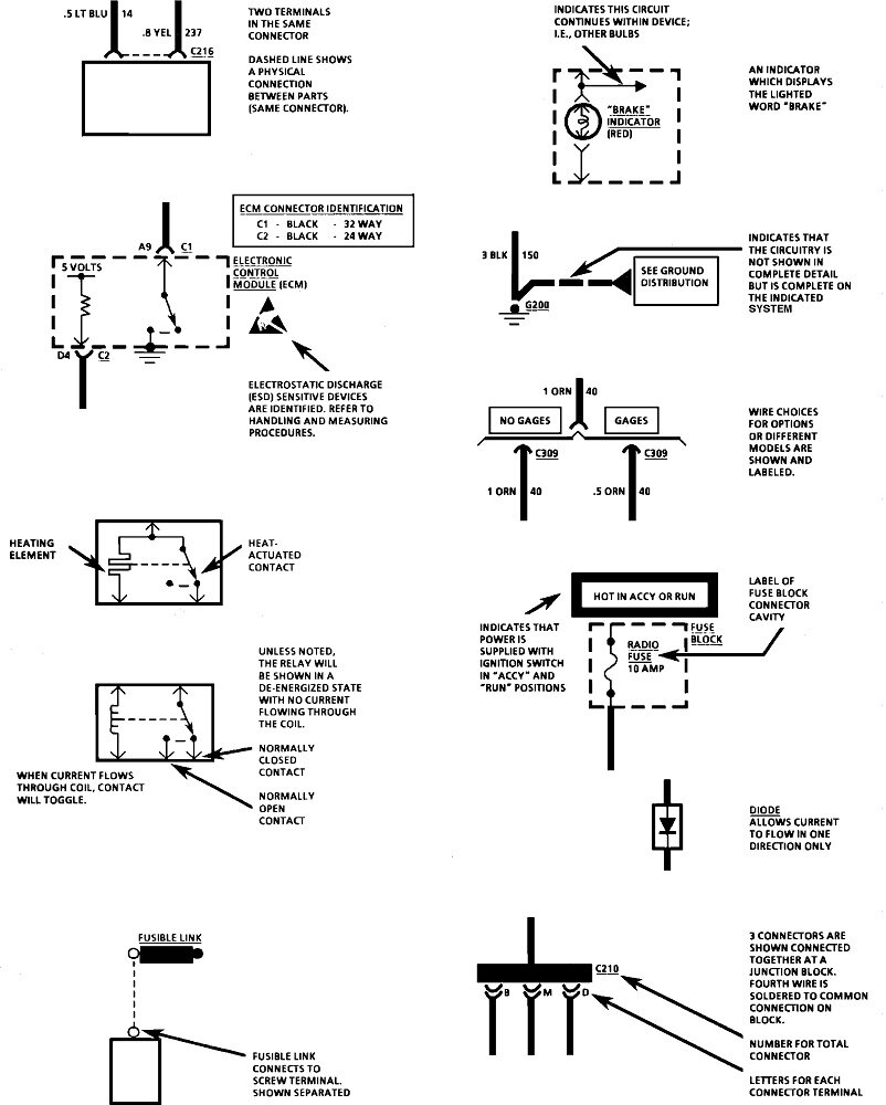

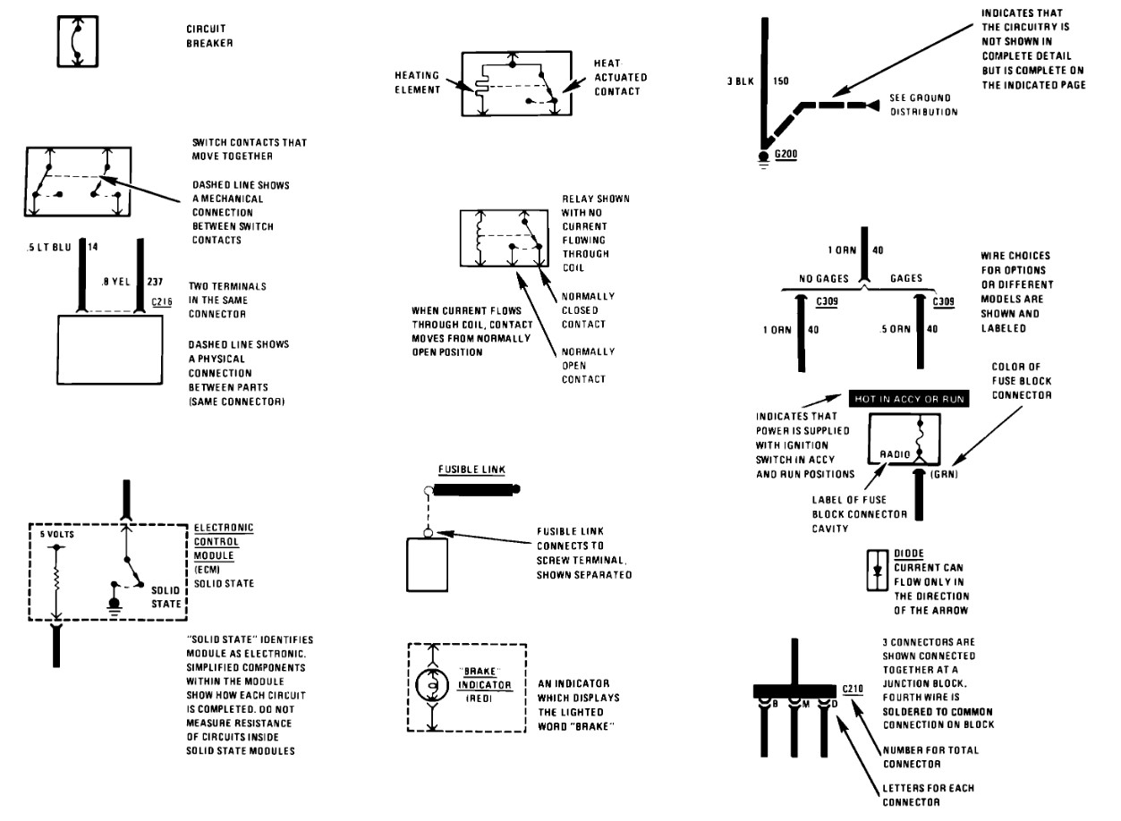

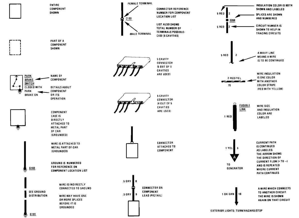

It occurred to me to look for this information for you. I found there's three choices for the 2.3L engine to select the right service manual. You have to use one letter from the VIN. Then, under general electrical repair, there's 15 articles, and within one of them, I finally found a subsection with the three pages I posted below. These would be the same in all GM manuals, regardless of engine size and options. I'm sorry that they show up too small to read. What I do is copy and paste them into a typing program, like MS Word, where they can be expanded. If you don't know how to do that, I can describe the steps, or I can try to cut them up, then expand each part for you.

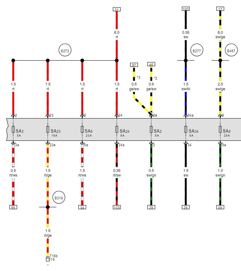

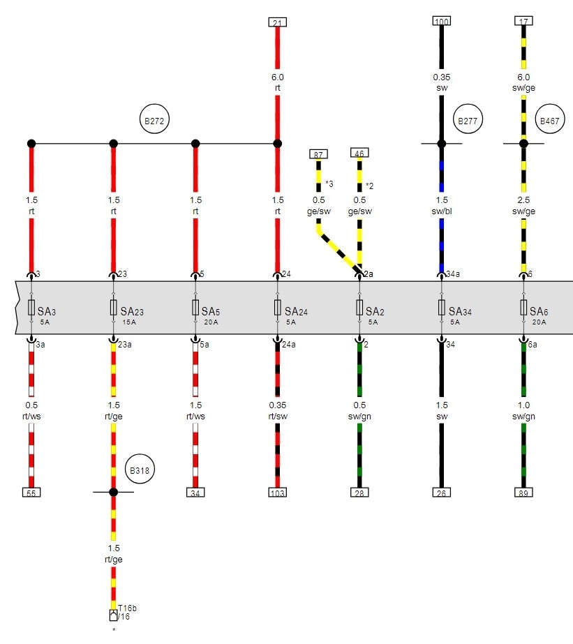

I merely asked what these numbers (.5, .8, 1, 3, 5, 8, 19) mean on the 90's automotive wiring diagrams published by General Motors Corporation for all GM vehicles in millions of copies. A person with a minimal knowledge of electrical engineering will easily realize that these designations cannot be diameters. I am not in the US and to repair my car I sometimes have to figure out some of the faults myself. I don't know American standards, but through arithmetic I have determined that these numbers mean the cross-sectional area of the wire in mm2. I was looking for cables from the battery to the starter (19mm2). And I found them. I won't be able to buy them, but I will find similar ones. You can look up what the cross section of these cables are to check. Here are the links:
https://www.gmpartsgiant.com/parts/gm-cable-12157227.html?vin=1G3NL5438PM025097&make=Oldsmobile&model=Achieva&year=1993&submodel=&extra1=&extra2=&filter=()
https://www.gmpartsgiant.com/parts/gm-cable-12157233.html?vin=1G3NL5438PM025097&make=Oldsmobile&model=Achieva&year=1993&submodel=&extra1=&extra2=&filter=()
https://www.rockauto.com/en/moreinfo.php?pk=1110616&cc=0&pt=2500&jsn=274
Best wishes for success.

I know this won't help, but for the benefit of others who might be interested, Ford puts a two or three-digit number next to each wire, then they put the color separately. In one diagram I was just using, the wire leading to a switch is number 238, and the wire leaving that switch is number 866. There's no rhyme or reason other than to show that every wire not labeled 238 is different than 238. Duh?
Chrysler's appear to be the most confusing until you understand them. A typical example would be "L18 12DB/RD". "A" circuits start out at the battery positive post, "Z" circuits end at ground, then each system gets its own first letter in between. "L" is for lighting circuits. The "18" is the circuit number to just differentiate it from other "L" circuits. "12" is for 12 gauge, and the color is dark blue with a red stripe, or "tracer". In their world, that wire might splice off into two or more smaller wires labeled L18 14DB/RD. The "L18" tells you it's the same wire with no switches or fuses in between.
