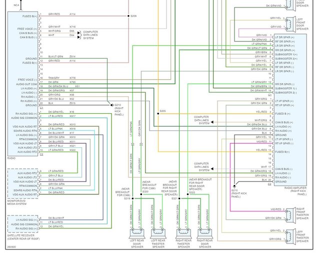

My vehicle had been stolen and they took the stock harness that bypasses the security system to the amplifier, so now when I put my aftermarket stereo in it will not run anything in the truck; none of the speakers will work whatsoever and it all shuts off from the amplifier.

I attached the diagram below for you to view.
What is the issue with the radio?

Just to jump in on this one. When you say they took the harness that bypasses the security system to the amp, is this something that you added to run your radio?
I understand the radio will not work but you said this was the stock harness that bypassed the system. So, I just want to make sure we are on the same page with which harness this was.
If this was the harness that runs from the radio to the amp, we are going to have to replace it so if you have done that and the radio still is not operating then we are going to have to start checking power and ground.
Please let us know a little more detail about what is happening, and we can go from there. Thanks
