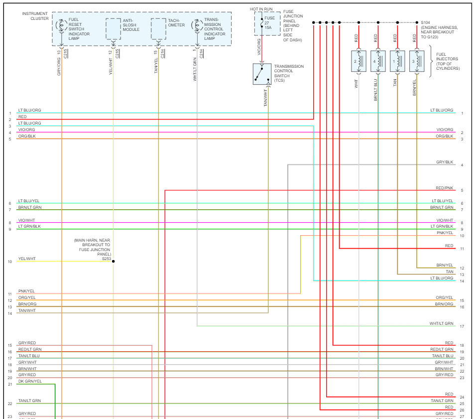

1999 ford ranger Mazda courier 2.5l, wiring schematics for dummies, lol.
Aug 4, 2023 at 7:35 PM
  • 55,456 POSTS

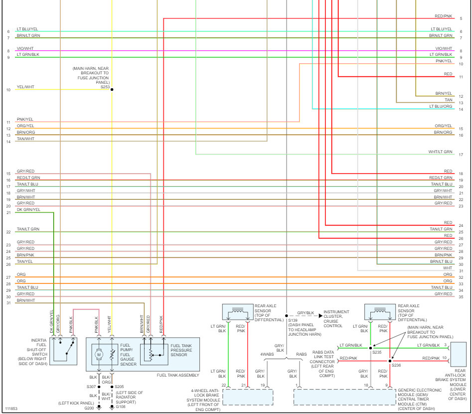

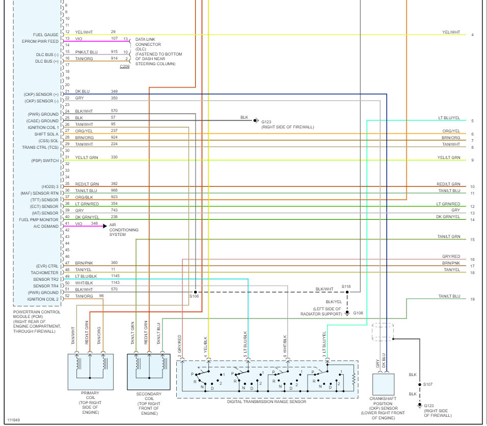

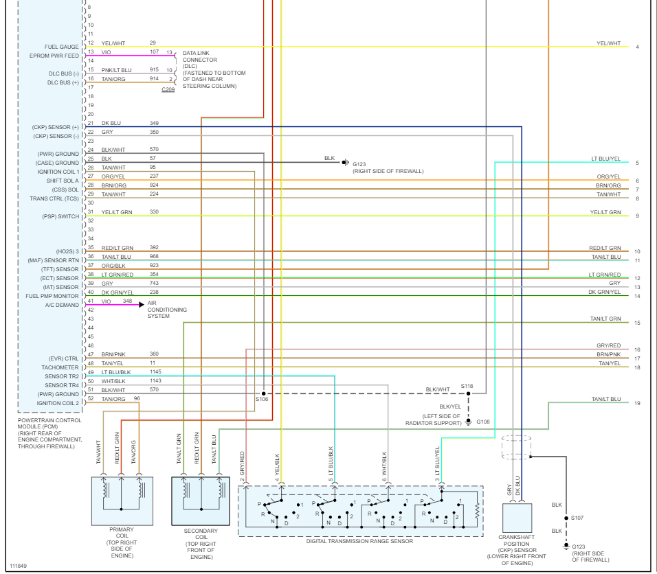

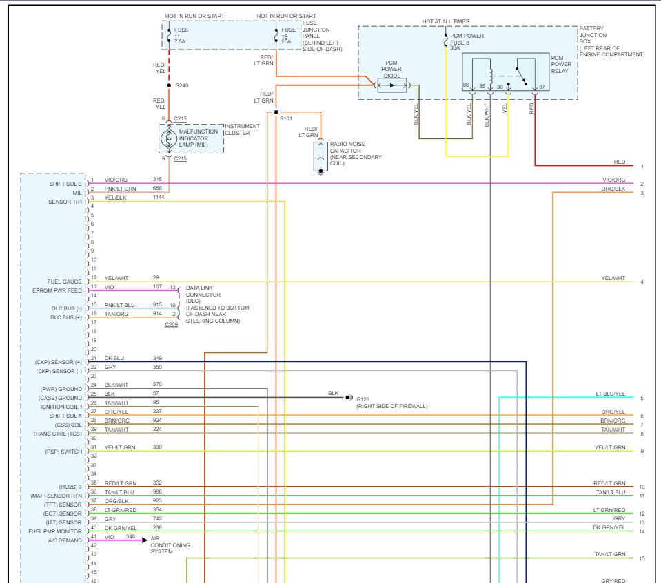

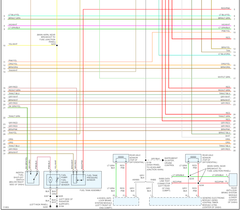

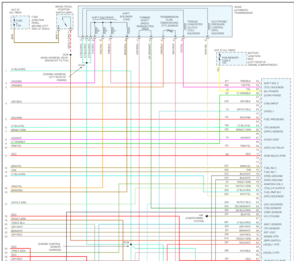

For what system or systems do you need the wiring diagrams for?
Aug 5, 2023 at 4:22 AM
RUSSELLJESSE2019

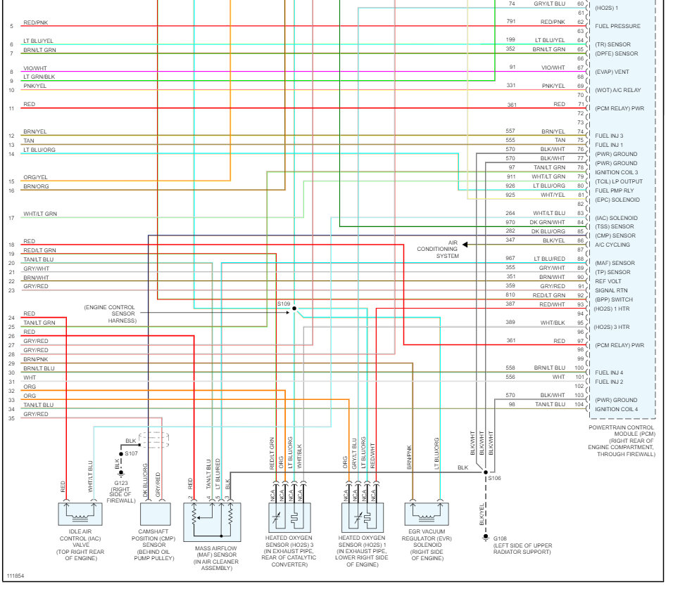

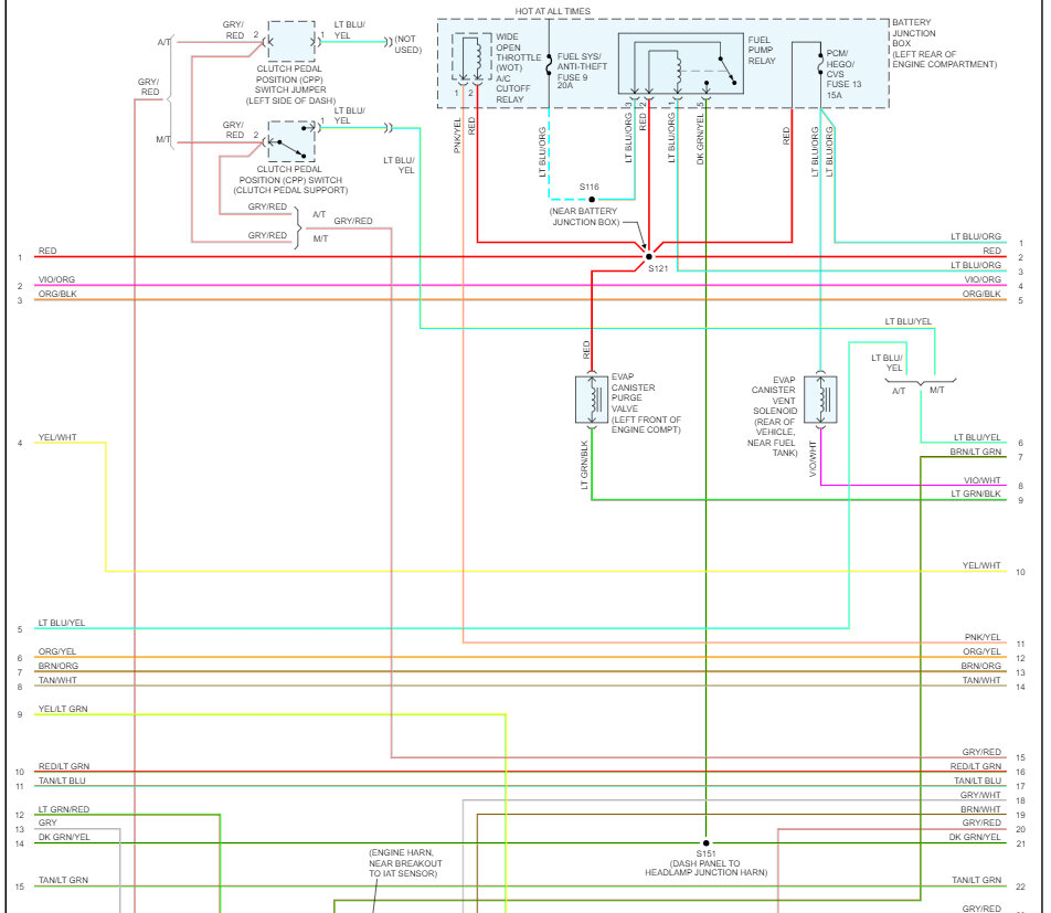

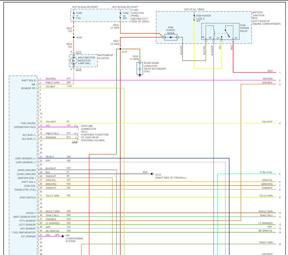

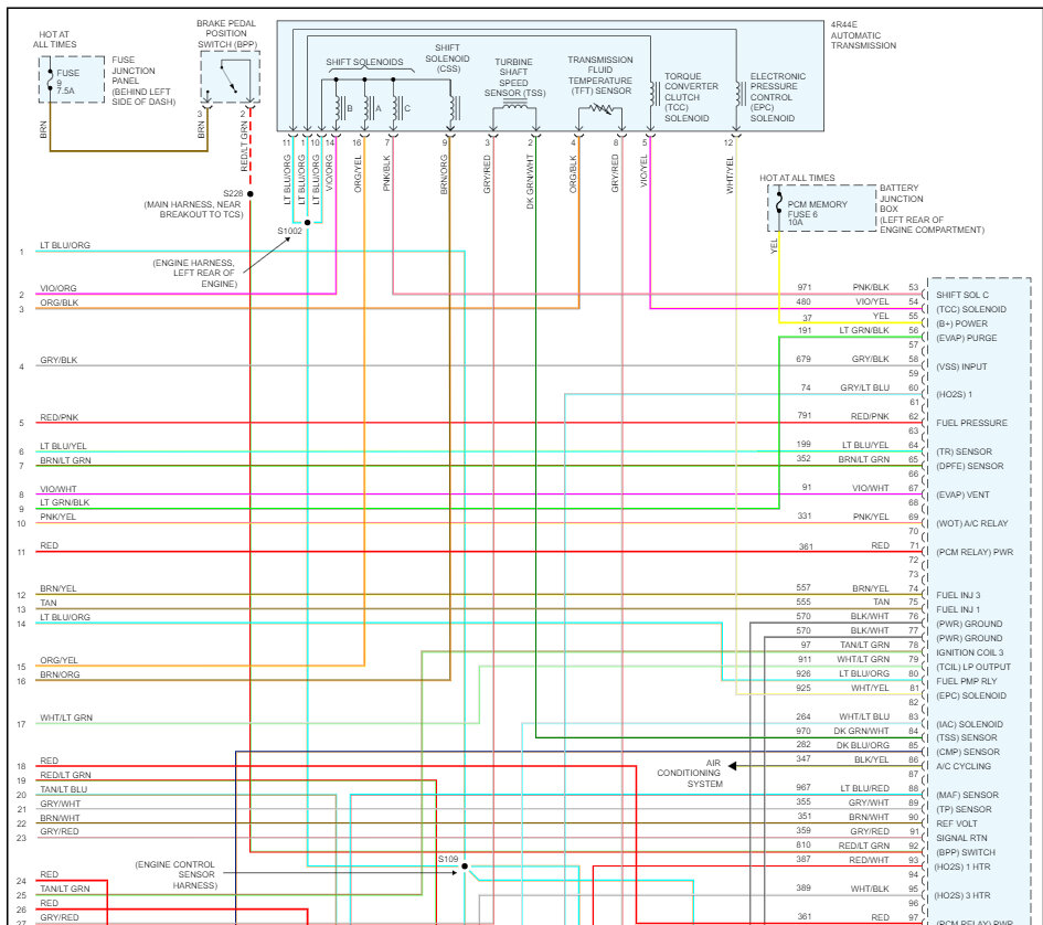

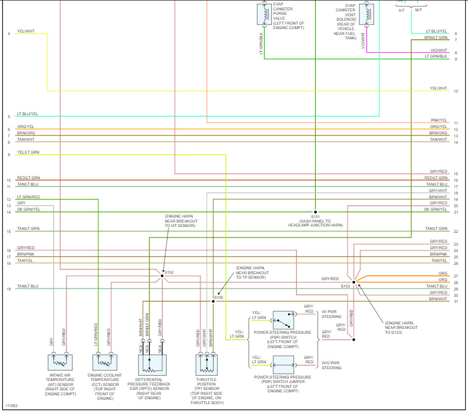

For the engine and under the driver’s side seat right before the gas tank there’s two plugs and they were both cut off. I bought a truck that some tweakers got a hold of and thought they could make it better it ran before then they cut all the wires and it wouldn’t start, so I bought it for $200. nice little light truck for me to just get in and go out instead of motorcycle.
Aug 5, 2023 at 5:21 AM
  • 55,456 POSTS
Good call, here are the engine wiring diagrams but I am not sure about the driver's side under the seat? Can you tell me what the wiring is going to? This guide can help you test the connections:
Check out the images (below). Please let us know if you need anything else to get the problem fixed.
