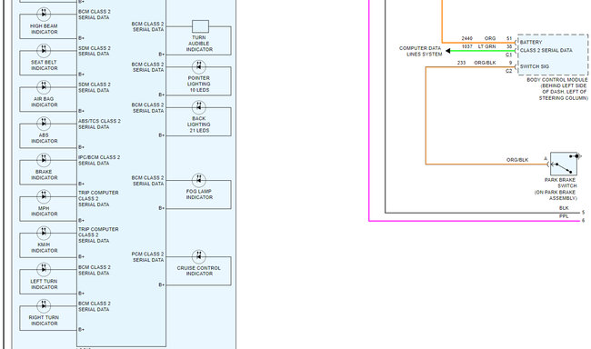

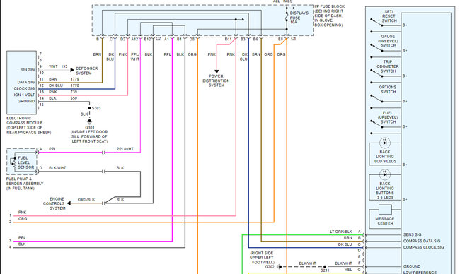

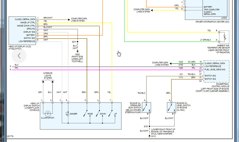

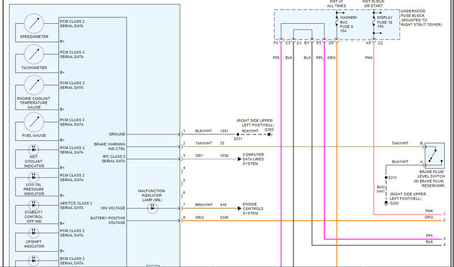

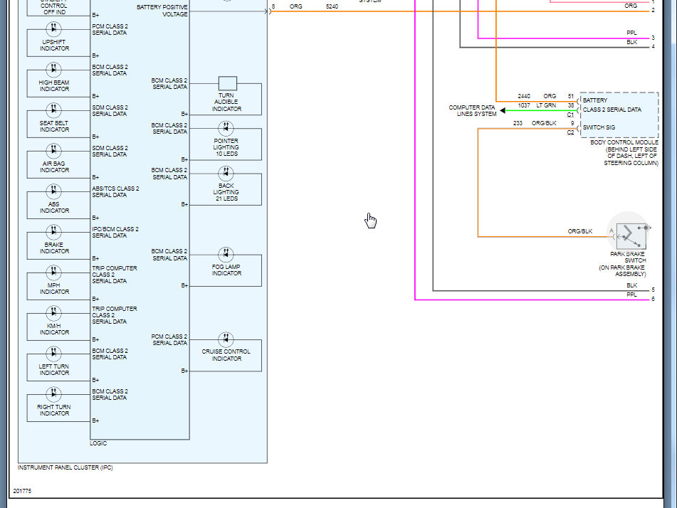

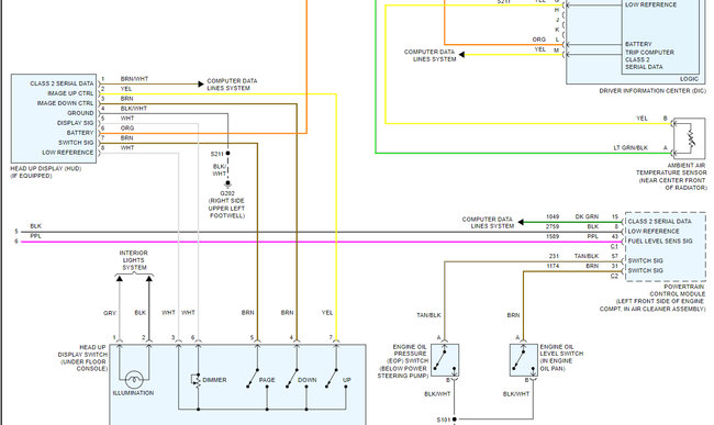

Good evening,
I attached the diagrams for the under dash cluster for the dashboard.
Is there a particular system that has an issue?
Friday, November 13th, 2020 AT 5:29 PM
Unfortunately, the way they break down the wiring diagrams is by system or component. So for example, here is the wiring diagram for the cluster and related components. This means getting you the under dash wiring would be quite a bit so it would be better if you tell us what system you are working on if not the cluster and we can provide that diagram.
