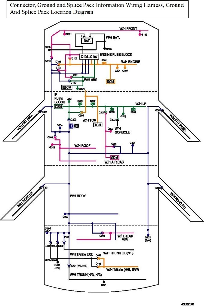

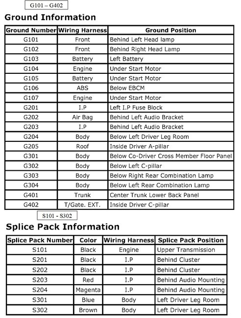

Yes sir. I need the ground points diagram.
Mar 7, 2023 at 2:04 PM
CARADIODOC
  • 34,321 POSTS
This drawing doesn't reproduce very well. If it's too hard to read, first try copying it into a typing program such as MS Word where it can be expanded, or I can cut it into pieces that I can expand for you. I find they look the best when using MS Word.
Which circuit are you working in?
