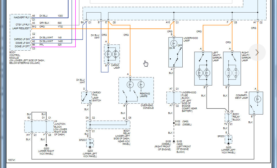

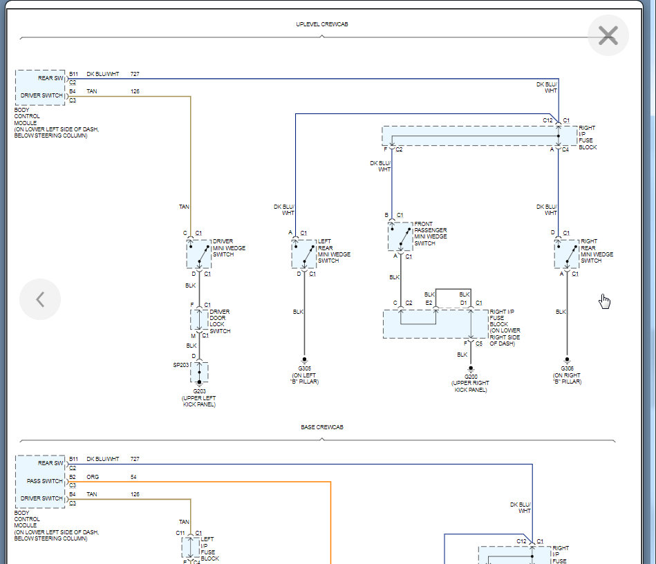

Is the vehicle a regular cab? Also, are you looking for interior lighting, instrument panel and things like that? I ask because the systems are broken up by component. For example, lighting, engine, HVAC, and so on. If we don't narrow it down, I'm be sending a ton of schematics that will likely drive you crazy trying to find what you need.
Let me know if it is a specific issue we need to address.
Nov 6, 2020 at 5:48 AM

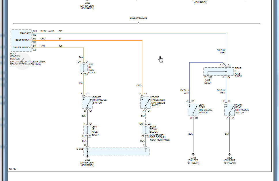

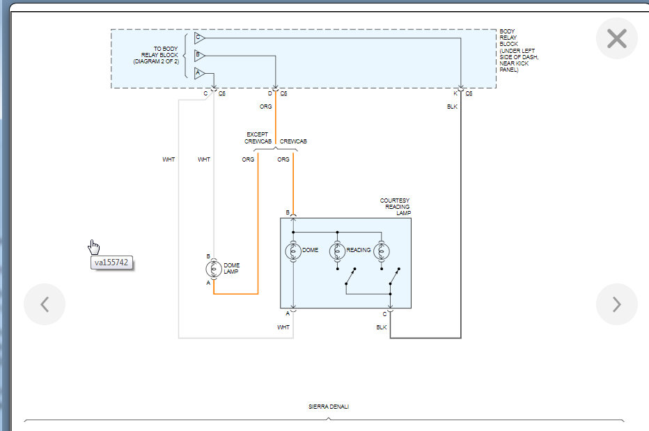

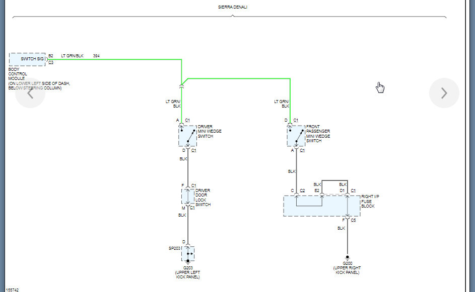

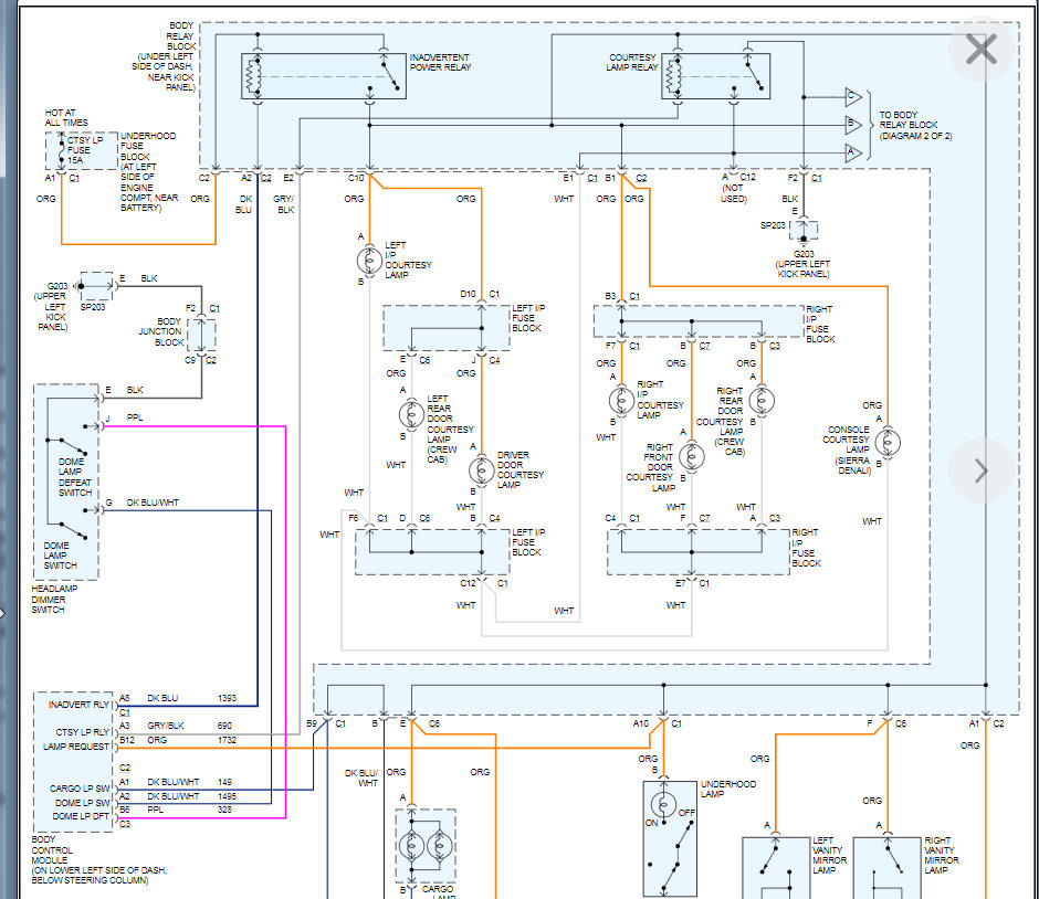

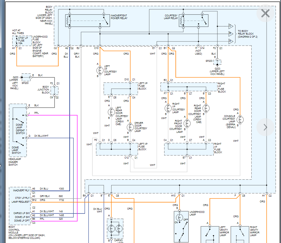

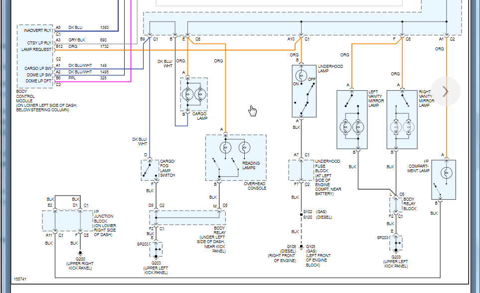

Here is the complete diagram for the interior cabin lighting. I am not sure if there are other things that you are looking for when you say complete cabin. If there are other systems that you need let us know. The wiring diagrams are broken down by system so just let us know and we can look them up. Thanks
Nov 6, 2020 at 5:49 AM
