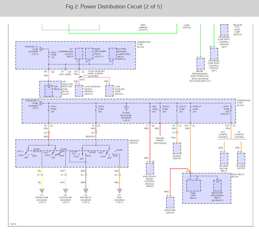

I am having electrical problems in my research I found out that the wipers, temperature gauge,and blower motor for the heater take power from the ignition switch. So I pulled the switch out and I jumped power between the switch and the blower motor, temperature gauge, an wipers all started to work. So I figured I had a bad ignition switch so I replaced the ignition switch and I am still not getting power to these things. The truck will turn over and start just fine but it seems like I am not getting power through the switch in run. Any help would be appreciated. Thanks

It sounds like you have an IGN B or IGN C fuse that is blow under the hood. Here is the ignition switch wiring diagrams (below) and a guided to help you run a test for power:
Check out the diagrams (below). Check for power at the red and red/white wires at the switch. Please let us know what happens.

I have checked for power at those to wires yesterday and there is power there.

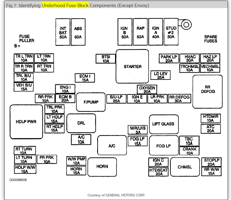

And I have checked all fuses under the hood they are all good.

With the key on do you have power at the white, brown and orange wires? (at the switch)

With the key on there is no power to the white brown or orange wires.

With the key off do you have power at the orange and red wires? If so the switch is bad and needs to be replaced. If not then check for power at fuses IGN C and IGN B.

Do you have power at fuses IGN C and IGN B? Here is the locations.
