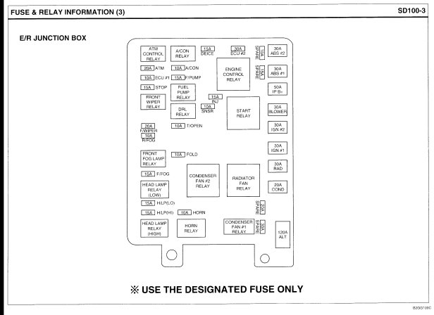

The wipers only work when you use the wash mode. They do not turn on during regular modes.
May 31, 2018 at 3:32 AM
  • 110,194 POSTS

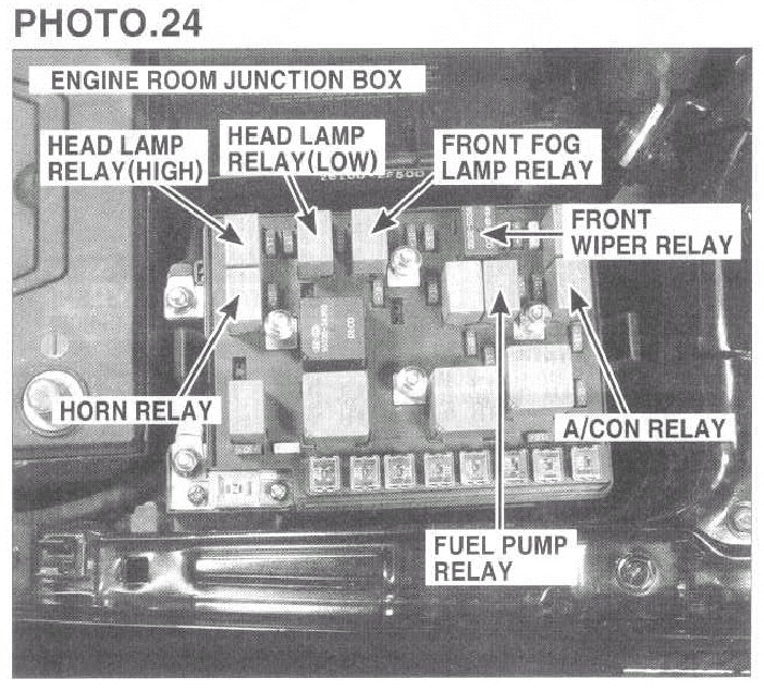

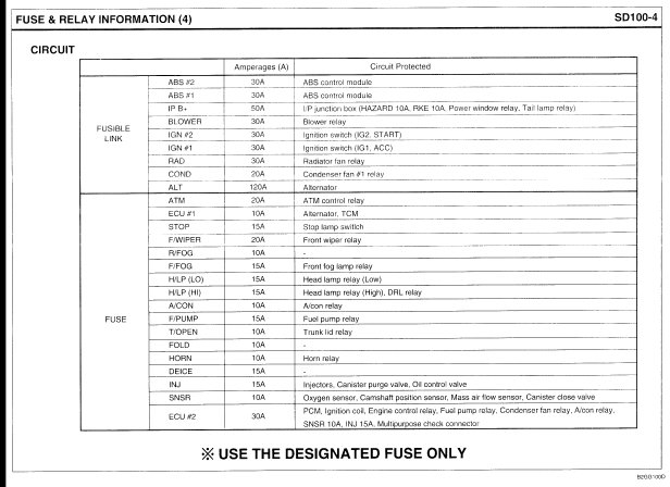

Hi and thanks for using 2CarPros.com. Since the wipers work when you wash the windshield, we know the motor and ground for the motor are good. The next easiest thing to check is the fuse. The first two pictures I have attached are of the fuse box (under hood) and fuse location and allocation. Take a look at that first.

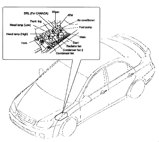

If the fuse checks good and there is power to it, next check the wiper relay. Pictures 3 and 4 are related to that component.

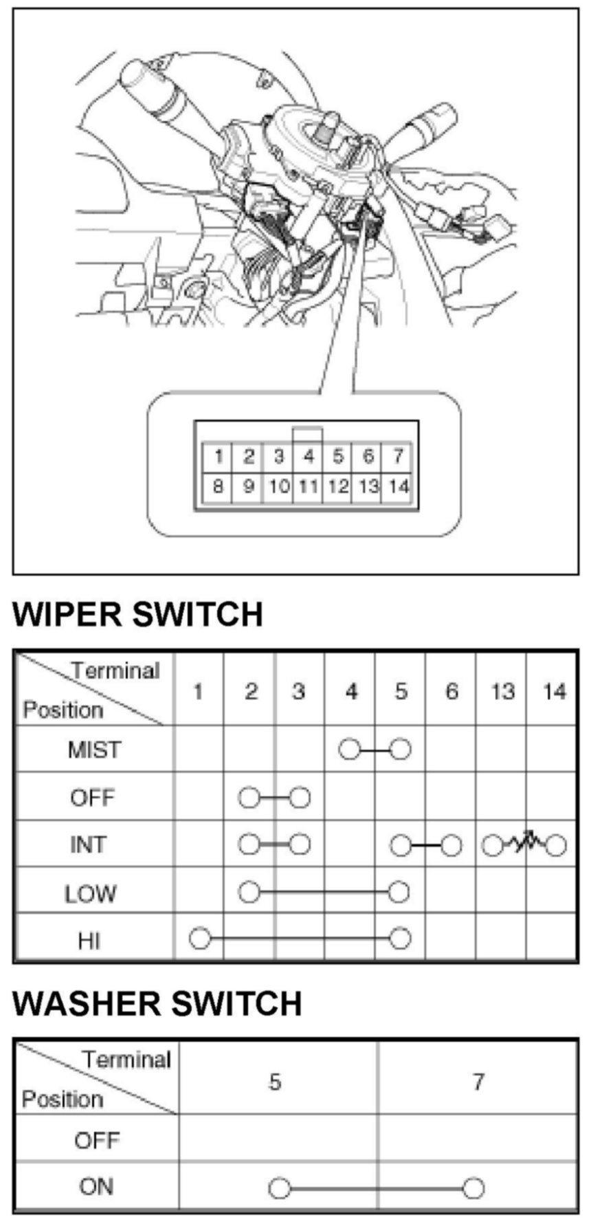

If all tests correctly, then you need to check the switch itself. Here are the very basic directions for checking it. (see picture 5)
2006 Kia Spectra L4-2.0L
Vehicle » Sensors and Switches » Sensors and Switches - Wiper and Washer Systems » Wiper Switch » Testing and Inspection
TESTING AND INSPECTION
Windshield Wiper/Washer Switch
INSPECTION
Check for continuity between the terminals while operating the wiper and washer switch.
