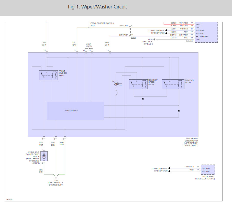

Wipers quit working. I have changed the fuse, relay, and switch

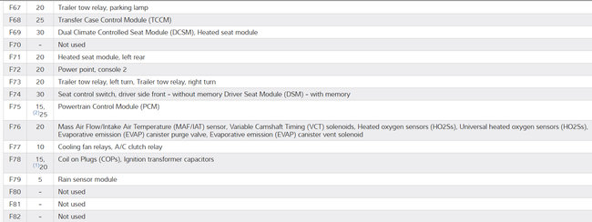

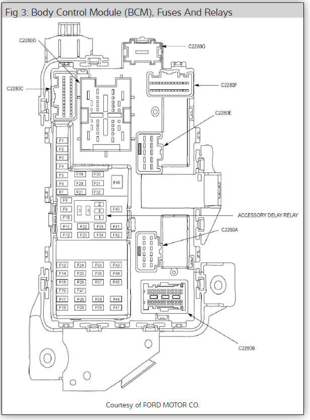

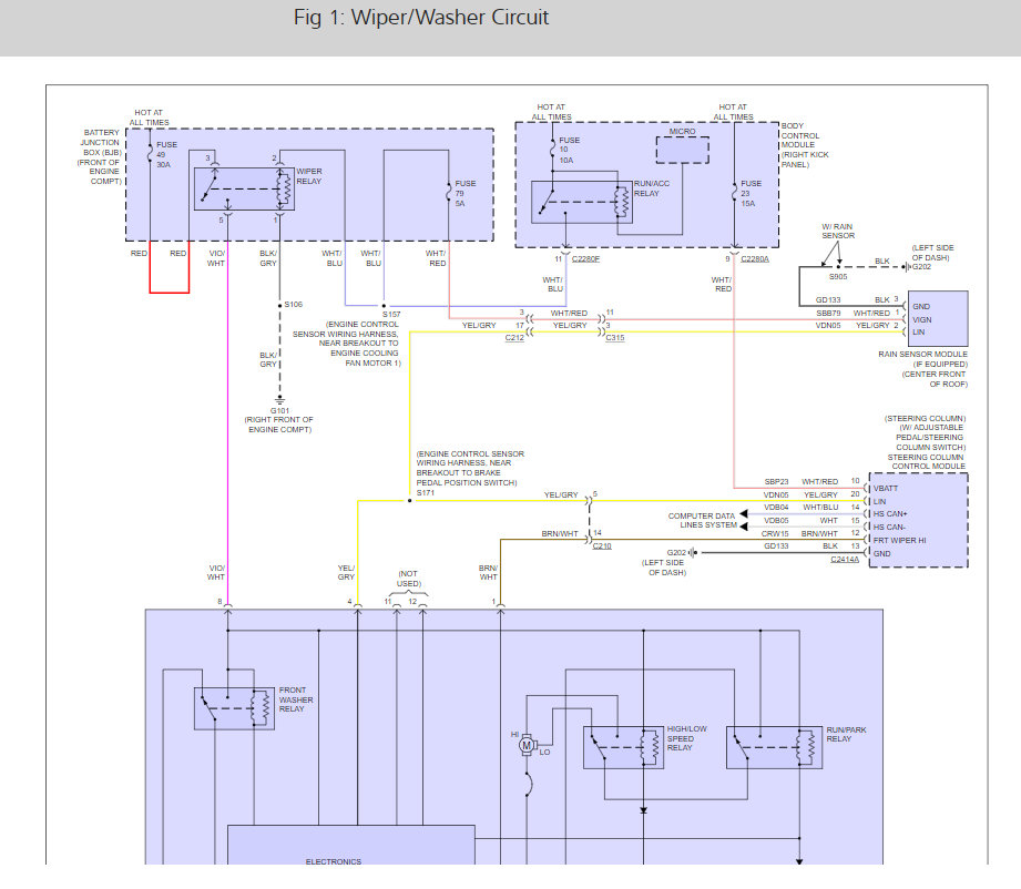

Wipers quit working. I have changed the fuse, relay, and switch and nothing fixed it. I found that the Rain Sensor Fuse is not getting power and when I go directly from the battery to the fuse everything works how they should. What would cause the fuse not to get power if I do not have the rain sensor option on my vehicle?

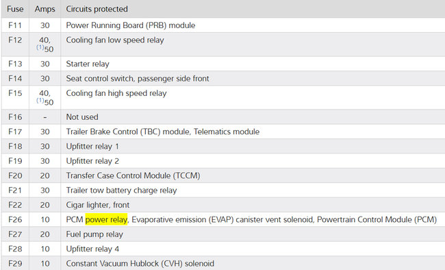

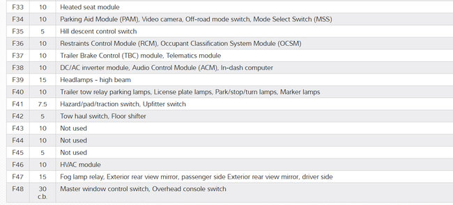

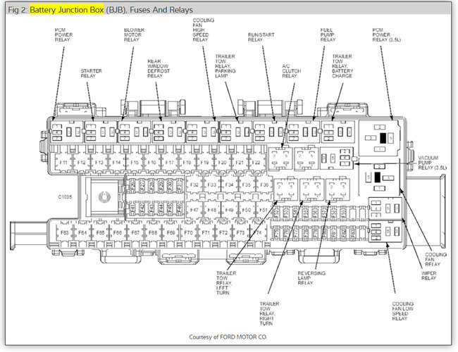

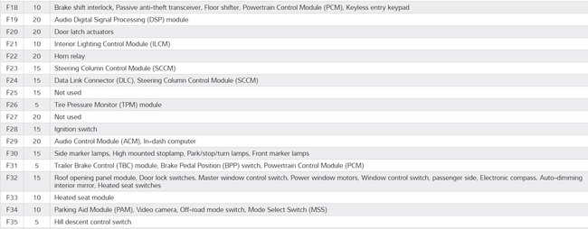

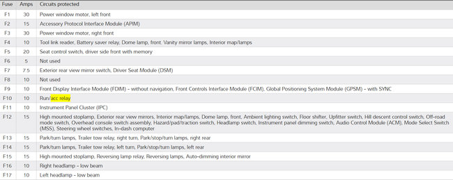

There is an ACC RUN relay that needs to be checked here is giudie to help and the wiper wiring diagrams so you can see how they work also the relay location.
Here are the fuse panel diagrams and the location of the relay. Check out the diagrams (Below). Please let us know what you find. We are interested to see what it is.

It was the RUN/ACC fuse #10. Thanks for the help. I figured there was somewhere it was getting power from but was not sure where to look.
