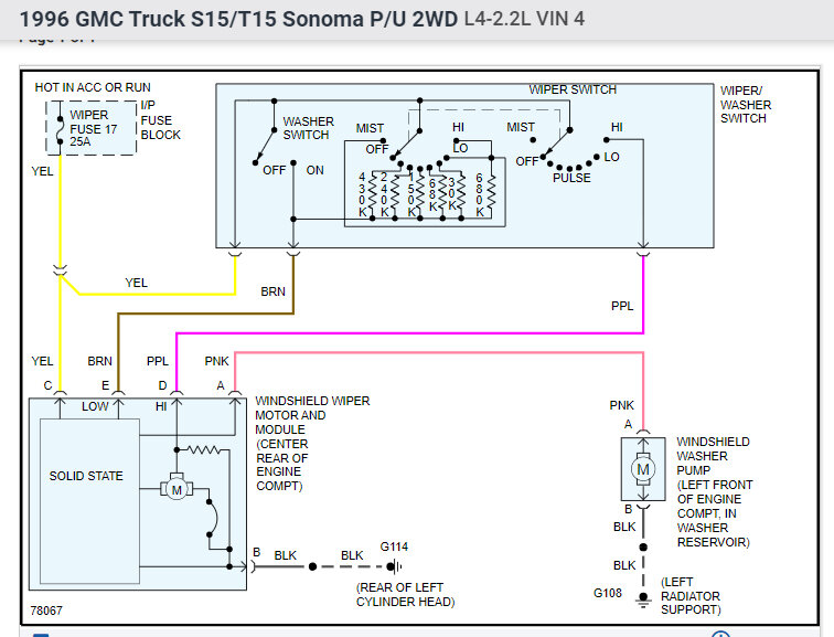

Where is the wiper relay and fuse located?
1996 GMC SONOMA
238,765 MILES • 4 CYL • 2WD • MANUAL
JRHD777
Wiper relay and fuse location needed.

I attached the wiring schematic for the wiper/washer circuit below so that you have a reference.
I'm not seeing a relay in the schematic. If I recall, it is controlled integrally within the motor.
Can you explain what is happening? If it isn't working at all times, there is a solder joint that is known to crack in the motor assembly's circuit board. They are not too hard to repair.
If that is the case, the wipers will usually work sometimes and not others, so let me know.
