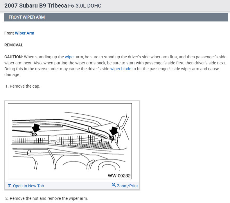

If you are looking for the actual arm that is typically only available at the dealer.

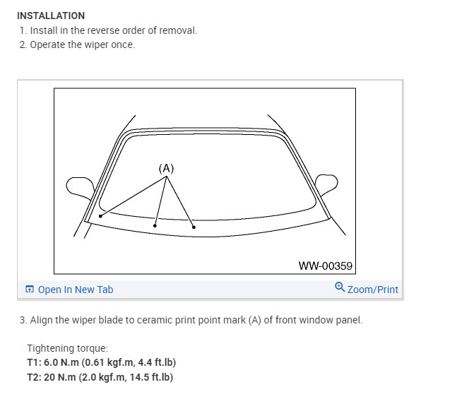

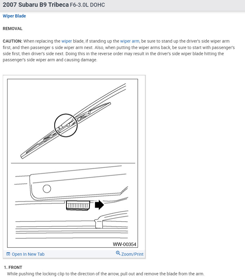

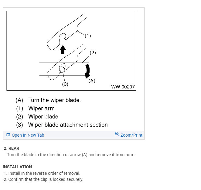

I have attached diagrams below for your reference.
