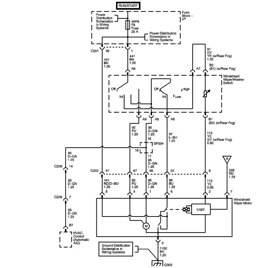

windshield's fuse keeps getting damaged every time I replace a new one. wipers are not working.

It sounds like you are having a problem with the wiper motor, please unplug it and try a new fuse to see if it blows when you turn the switch on with the key in the on position. Here is a wiring diagram so you can do some testing.
Please run this test and get back to us so we can continue helping you.
