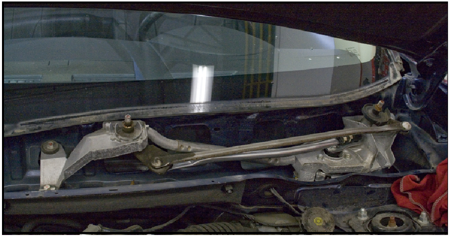

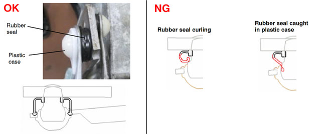

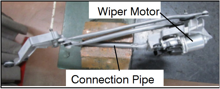

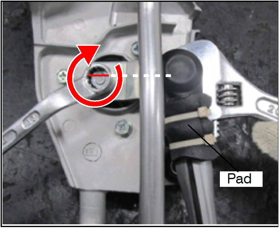

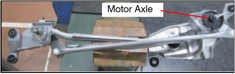

The back one does. I can hear a noise but no movement with the noise. The fuse is good.
Apr 22, 2019 at 11:33 PM
  • 110,194 POSTS
Welcome to 2CarPros.
If you can hear the motor running, chances are the linkage has come disconnected on the wiper motor. There is a manufacturer's recall on the ball joint corroding, causing excessive bushing wear, and coming disconnected. Here is the recall and the procedures for repair. Keep in mind, if this is the problem, and most likely it is, it will be repaired for free by a Mitsubishi Dealership. Here is what needs done. The attached pics correlate with this recall and repair instructions. I'm adding this so you have the recall info, and if the vehicle has a reconstructed title, it won't be covered. It's just in case you need to do the work.

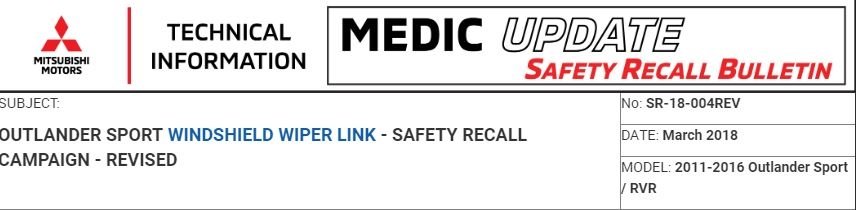

OUTLANDER SPORT WINDSHIELD WIPER LINK - SAFETY RECALL CAMPAIGN - REVISED
SUBJECT:
No: SR-18-004REV
DATE: March 2018
MODEL: 2011-2016 Outlander Sport / RVR

This bulletin supercedes SR-18-004, to correct the wiper motor part number on page 8, and to clarify that Part # 8250B137 cannot be used on Outlander Sport Windshield Wiper Motor recall.

In the event that water drops down through the back side of the front deck garnish (the body piece between the hood and windshield), the front wiper link ball joint may experience excessive moisture and corrode. If this occurs, the resin case of the ball joint will wear prematurely due to the ball joint corrosion and the wiper link may ultimately separate causing the windshield wipers to stop operating.
If wiper link separation occurs, the windshield wipers will become inoperative which could reduce driver visibility under certain conditions and increase the risk of a vehicle crash.

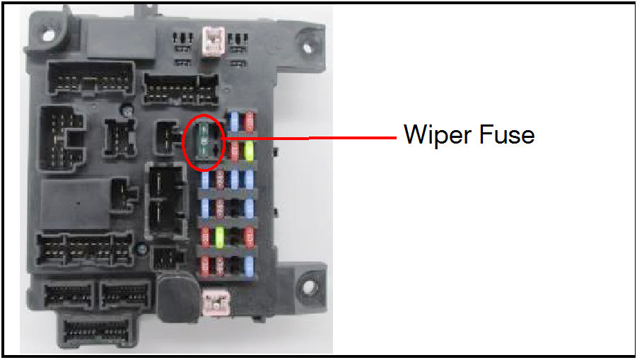

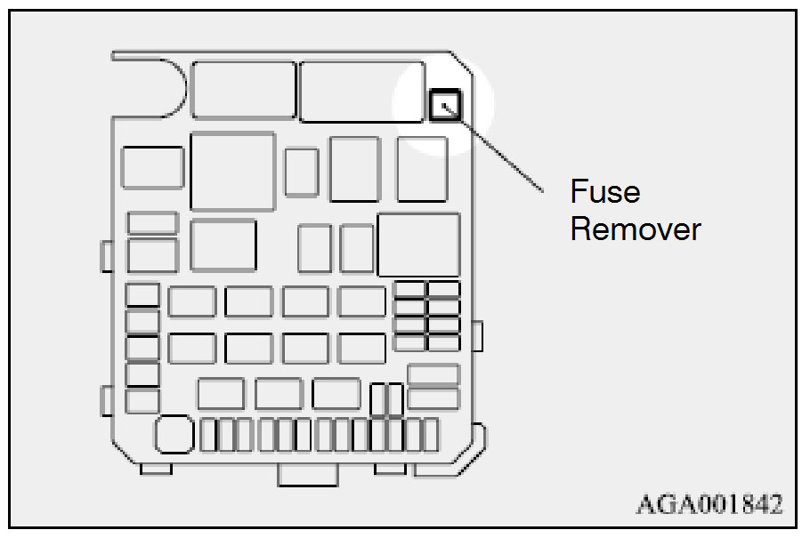

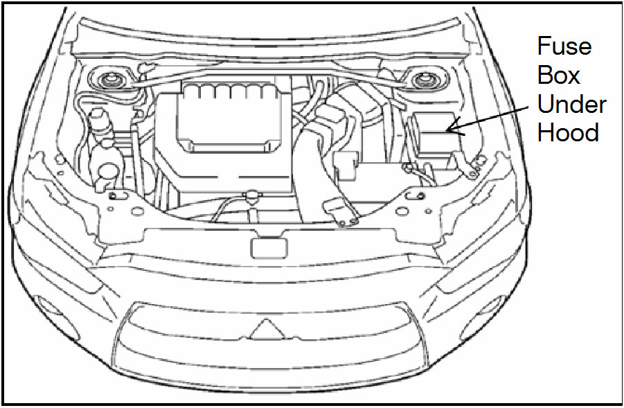

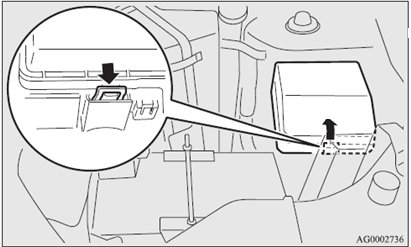

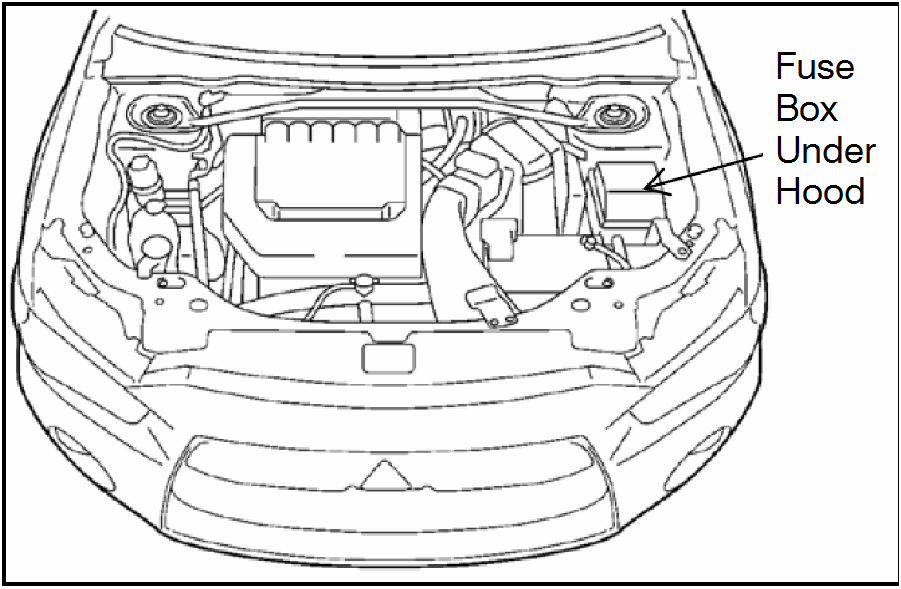

Obtain the Fuse Remover from the engine compartment fuse box.
Open the hood.
Unlock the fuse box cover by pushing on the lock lever.
Remove the Fuse Remover.

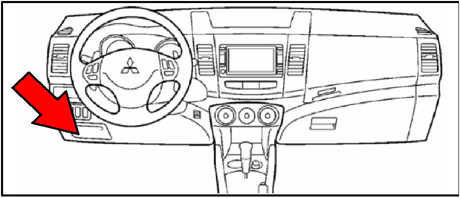

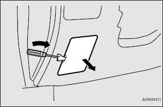

Locate the passenger compartment fuse lid.
Remove the passenger compartment fuse lid.

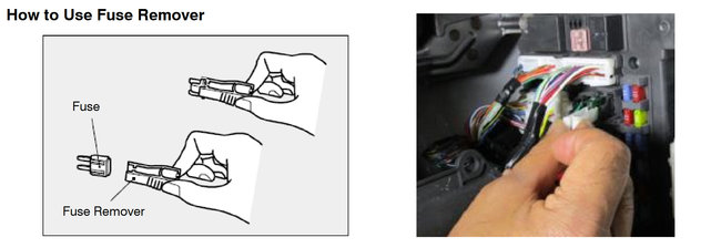

Using the Fuse Remover, locate and remove the green (30 A) Wiper Fuse.
Refer to “How to Use Fuse Remover” instructions below.
image A Fuse Remover MUST be used to remove fuses. Use of other tools such as pliers can potentially result in thermal incidents.

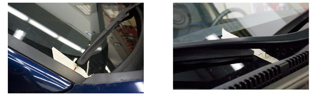

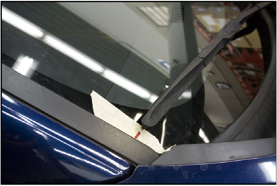

IMPORTANT: Before marking the windshield wiper positions, lift the wiper blade from the windshield and set it back down to ensure that they are resting in their intended positions.
IMPORTANT: Use a fender cover, towel, or similar accessory to protect the fender.
Attach masking tape to the windshield and mark the wiper blades' positions as shown.

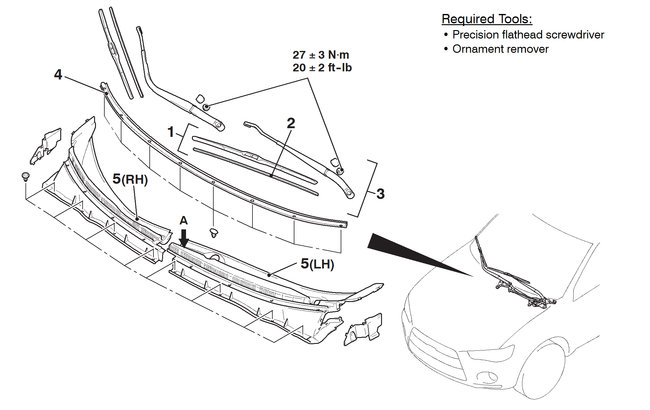

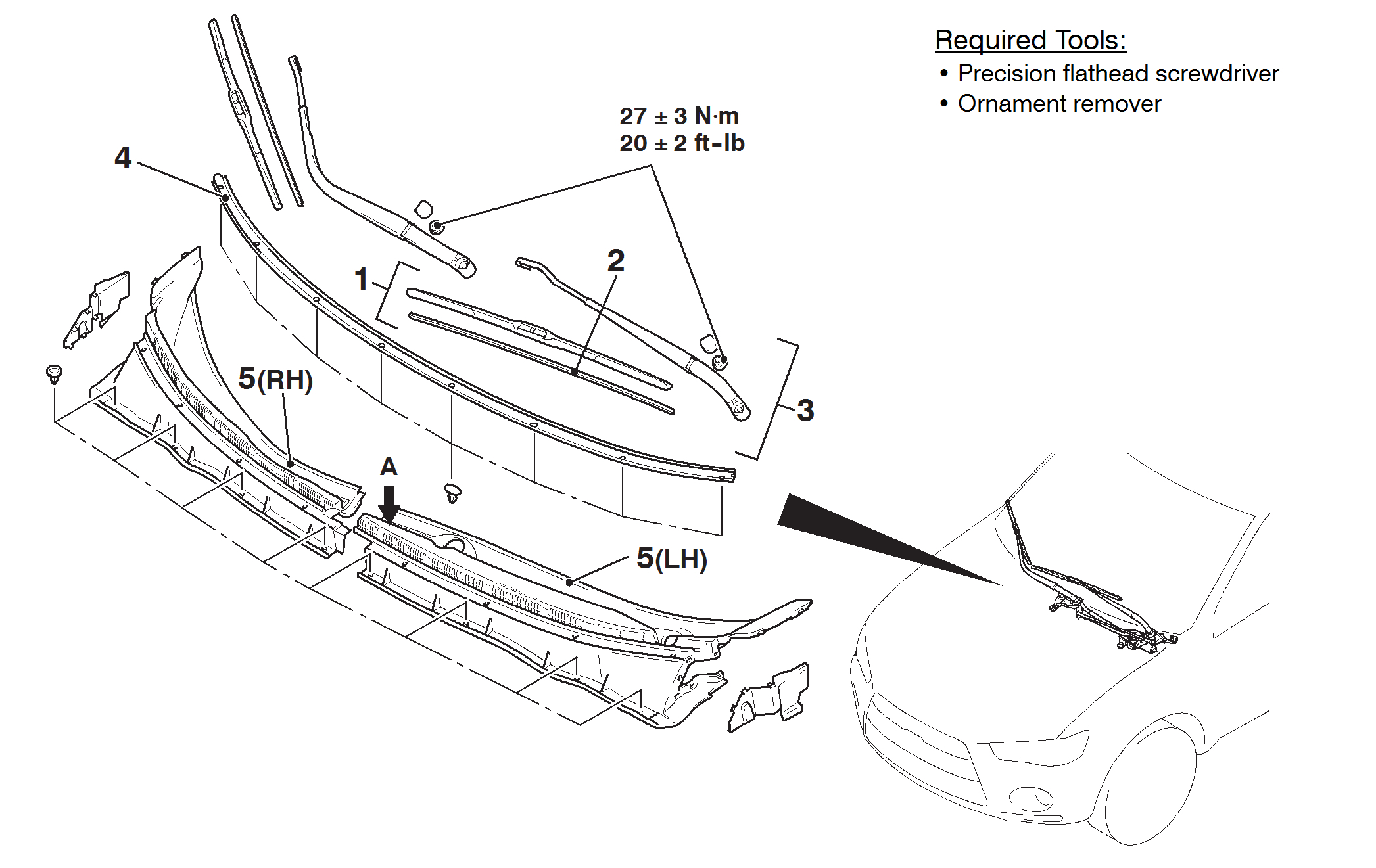

Remove the wiper arm blade assemblies.

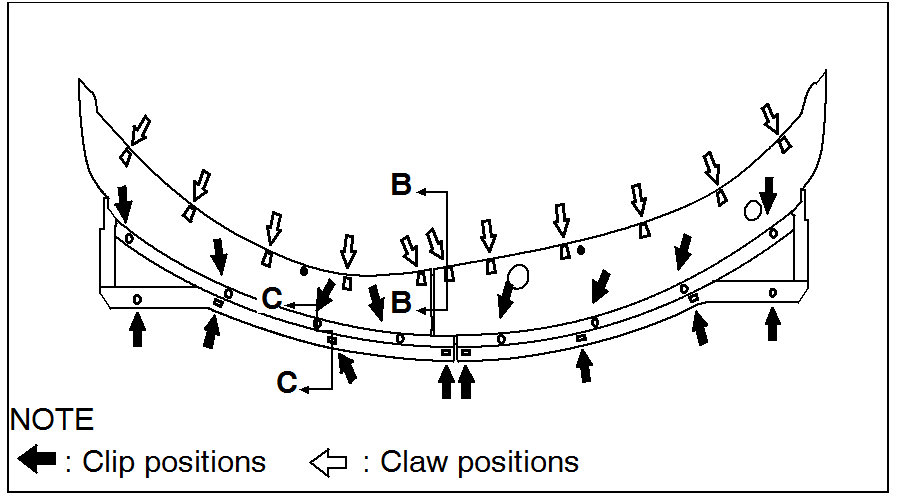

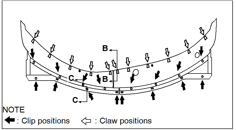

Remove front deck garnish.
Remove the passenger side hood rear weatherstrip from the deck garnish.
NOTE: Do not remove the driver side hood rear weatherstrip from the deck garnish (for easier reassembly).

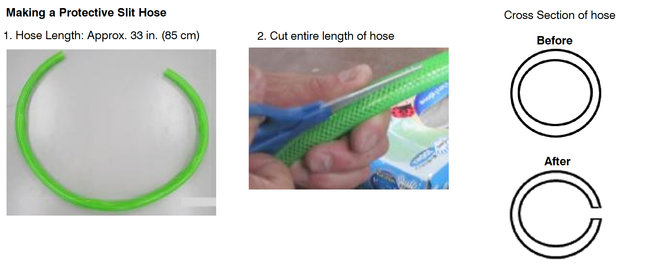

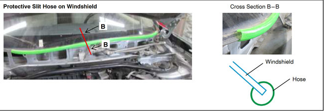

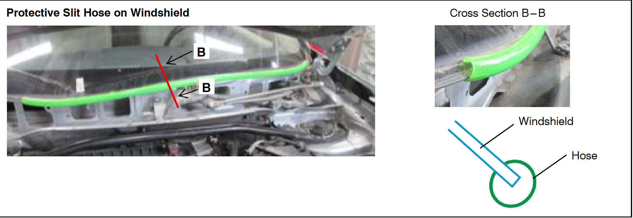

Protect the windshield with a protective slit hose.
Make a protective slit hose as shown below.
Cover the edge of the windshield with the protective slit hose.

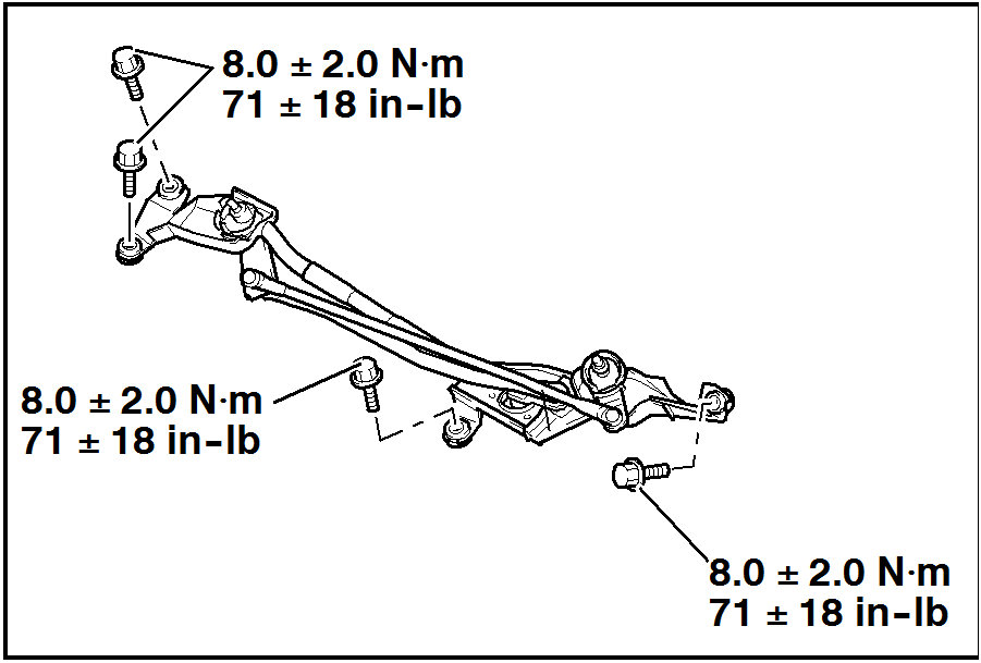

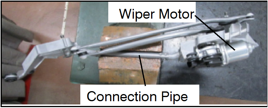

Unbolt the wiper link assembly, disconnect the wiper motor connector, and remove the wiper link assembly from the vehicle.

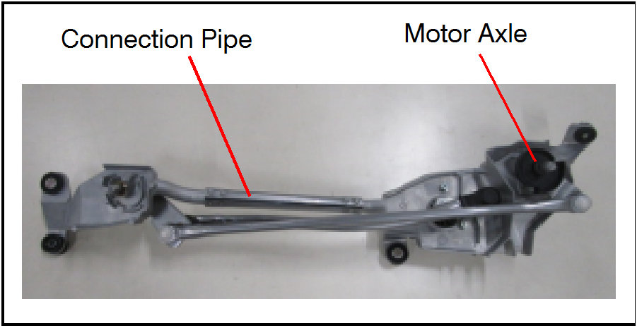

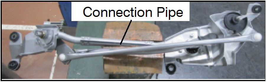

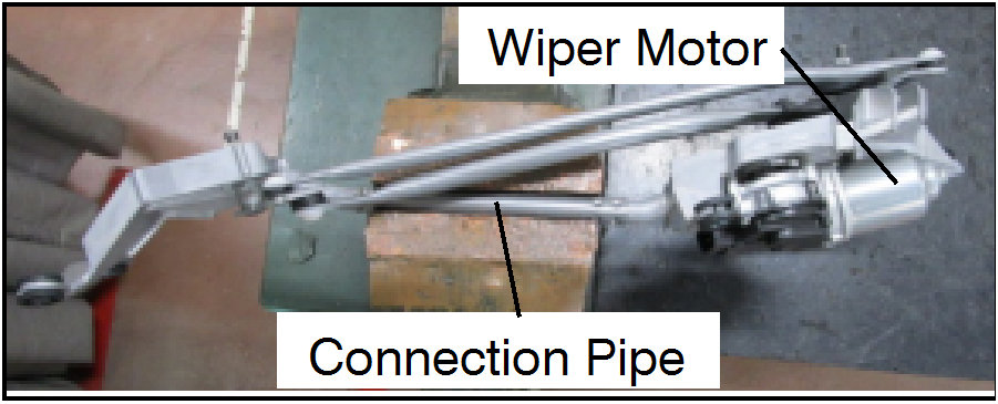

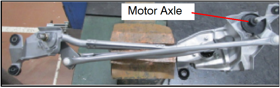

image Clamp the wiper link assembly at the connection pipe only.
Place the wiper link assembly in a vice with the motor axle pointing up.
CAUTION: Clamp ONLY the connection pipe section.

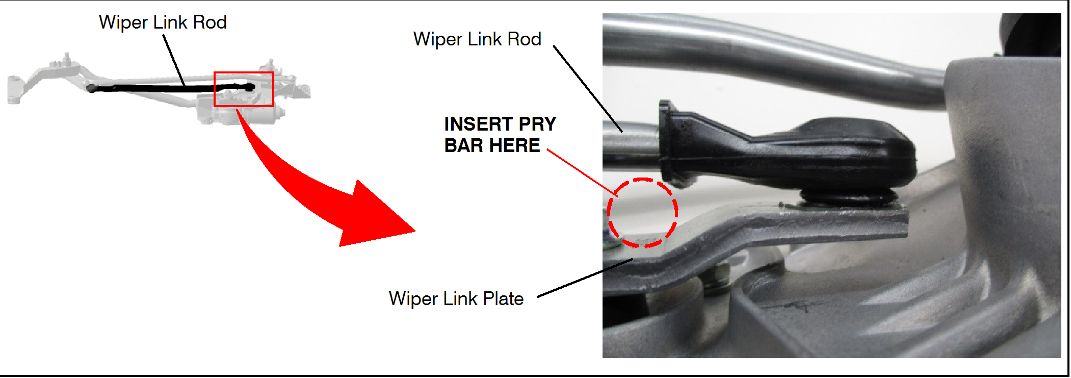

Use a pry bar or similar device to separate the wiper link rod from the wiper link plate.
Insert the pry bar and lift using leverage in area shown below.
image Turn the link plate slowly to avoid internal damage to the wiper motor.

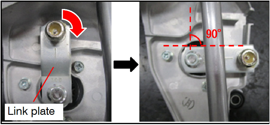

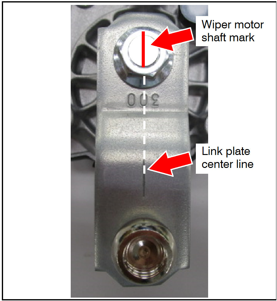

Use a straight edge to line up the link plate center line and the center of the wiper motor shaft, and use a marker to create a visible marking on the wiper motor shaft.
Turn the link plate approximately 90 degrees clockwise.

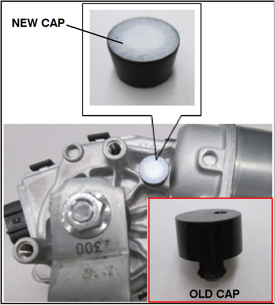

Remove and discard old wiper motor.
Obtain the new countermeasure wiper motor (part # MW400223).image
Verify that the new wiper motor has a breathing hole cap with a water proof cloth, as shown.
NOTE: Part # 8250B137 cannot be used on Outlander Sport Windshield Wiper Motor recall.image

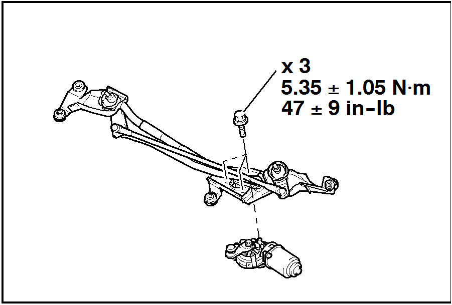

For vehicles with recall SR-16-010 open:
Install the new wiper motor to the wiper link assembly as illustrated, and tighten the 3 bolts to 47 ± 9 in-lb (5.35 ± 1.05 Nm).

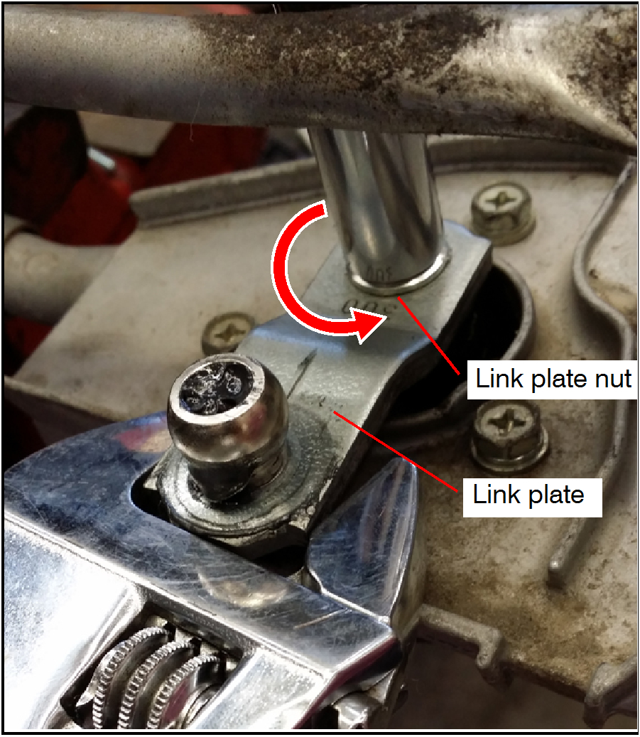

Hold the link plate in place with an adjustable wrench while loosening the link plate nut.
Remove the link plate and link plate nut.
NOTE: The link plate nut will be reused. Do not discard.

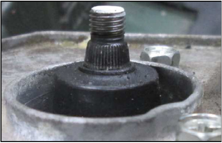

Check the knurling on the wiper motor shaft for any damage and/or debris. Clean off any debris with a clean rag.

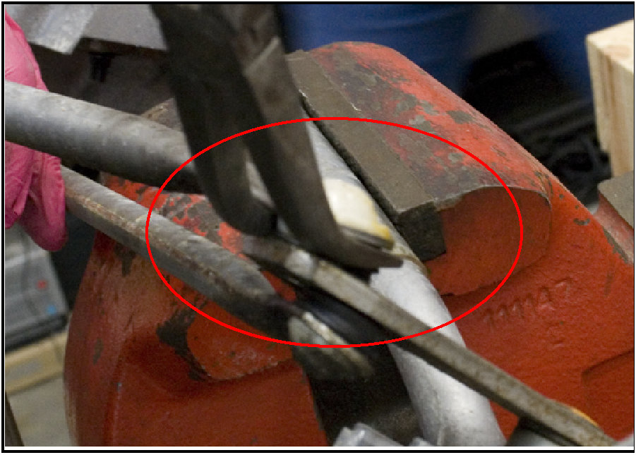

Rotate the wiper link assembly 90 degrees upward so that the wiper motor is directly visible from the top.

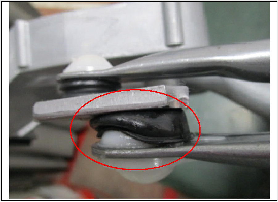

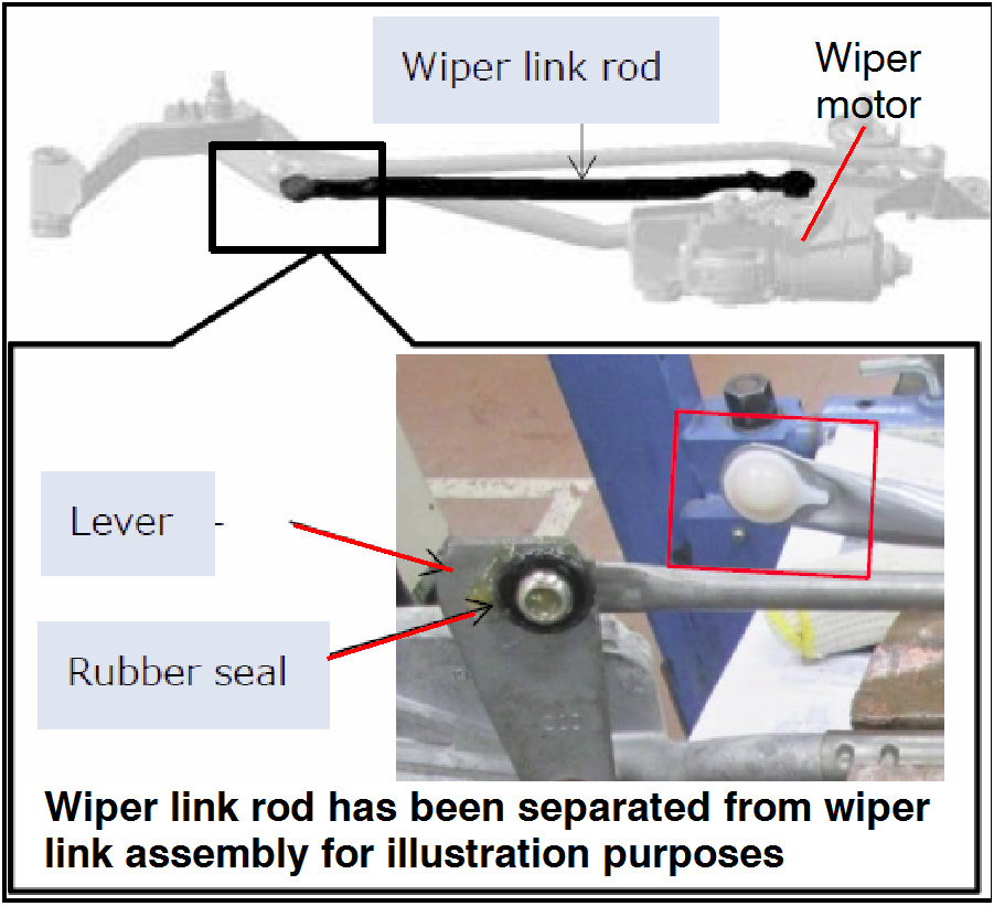

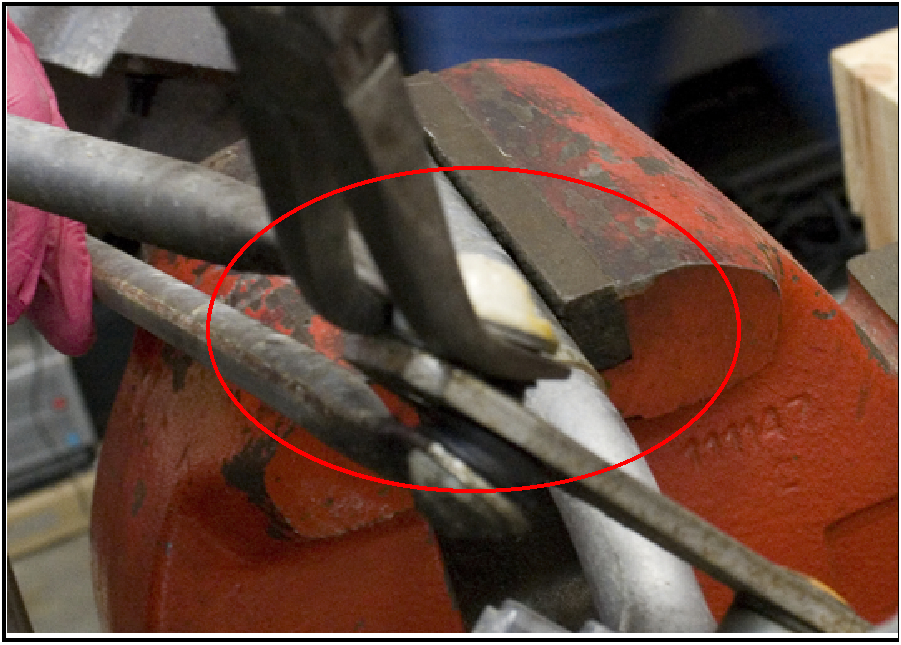

Locate the joint to be separated.
image Do not remove the wiper motor side joint.

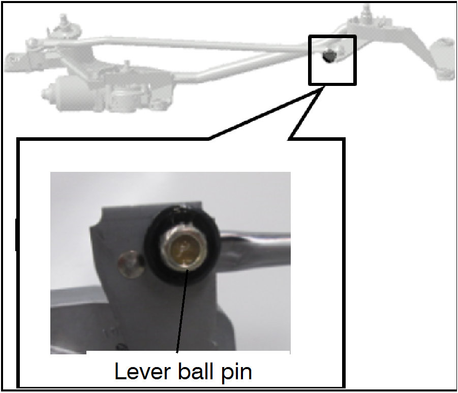

Pull back the rubber seal to prevent damage when performing the following steps.
Use bent needle nose pliers to separate the wiper link rod from the wiper link assembly.
Use a rag to clean dirt and grease off of the lever ball pin and rubber seal.
image Do NOT install link rod assembly if there is presence of water. If there is presence of water, remove excess water and dry thoroughly prior to re-installation.
Verify that the rubber seal is not damaged. If rubber seal is damaged, replace it with a new rubber seal (part # 8251A098).

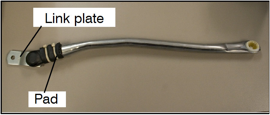

Obtain new wiper link rod (part # 8251A100).
Verify that the new wiper link rod appears as illustrated, complete with pad and link plate attached.

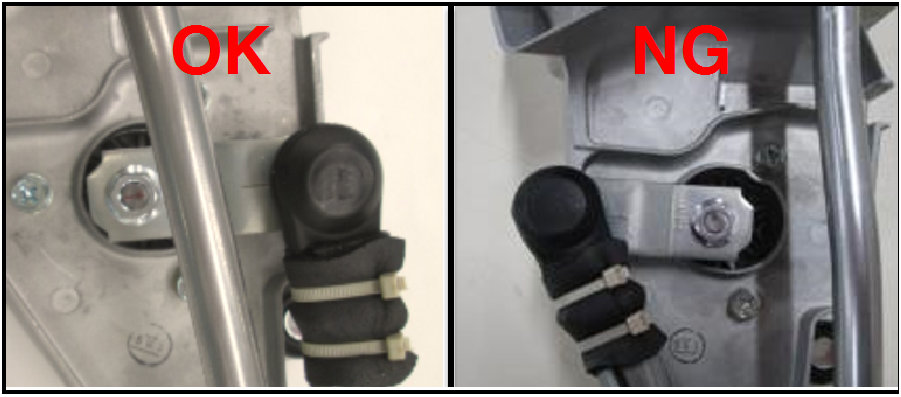

Install the wiper link plate to the wiper motor shaft. Make sure that the link plate and wiper link rod are in the correct orientation.
image Do NOT install link plate in a slanted position.
image Do NOT damage the pad.
Make sure that the wiper motor shaft mark and the link plate center line are lined up. Use an adjustable wrench to hold the link plate in position, to prevent link plate rotation.
Tighten the nut to 12.5 ft-lb ± 1 ft-lb
(17.2 ± 1.0 Nm).

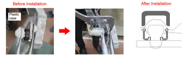

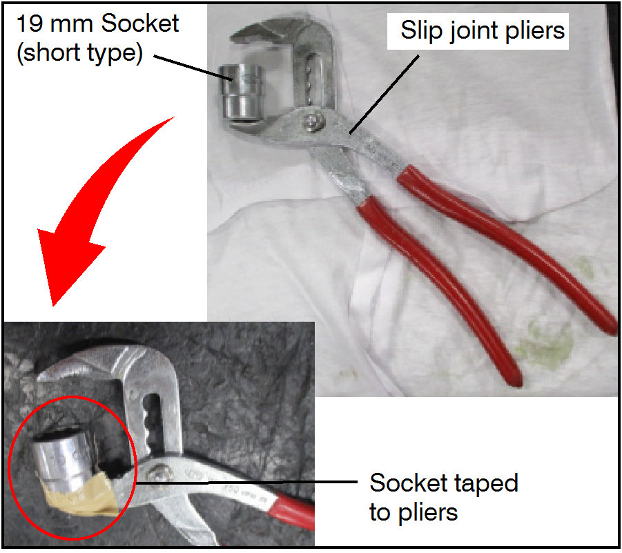

To prevent damage to the plastic case, improvise a tool using a 19 mm socket taped to slip joint pliers as shown.

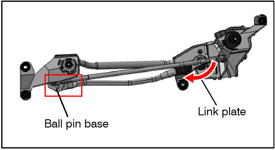

Turn the link plate slowly in the direction shown by the red arrow, so that the ball pin's base is visible (for easier installation).
Install wiper link rod, using the improvised tool, to the lever end that is opposing the wiper motor.

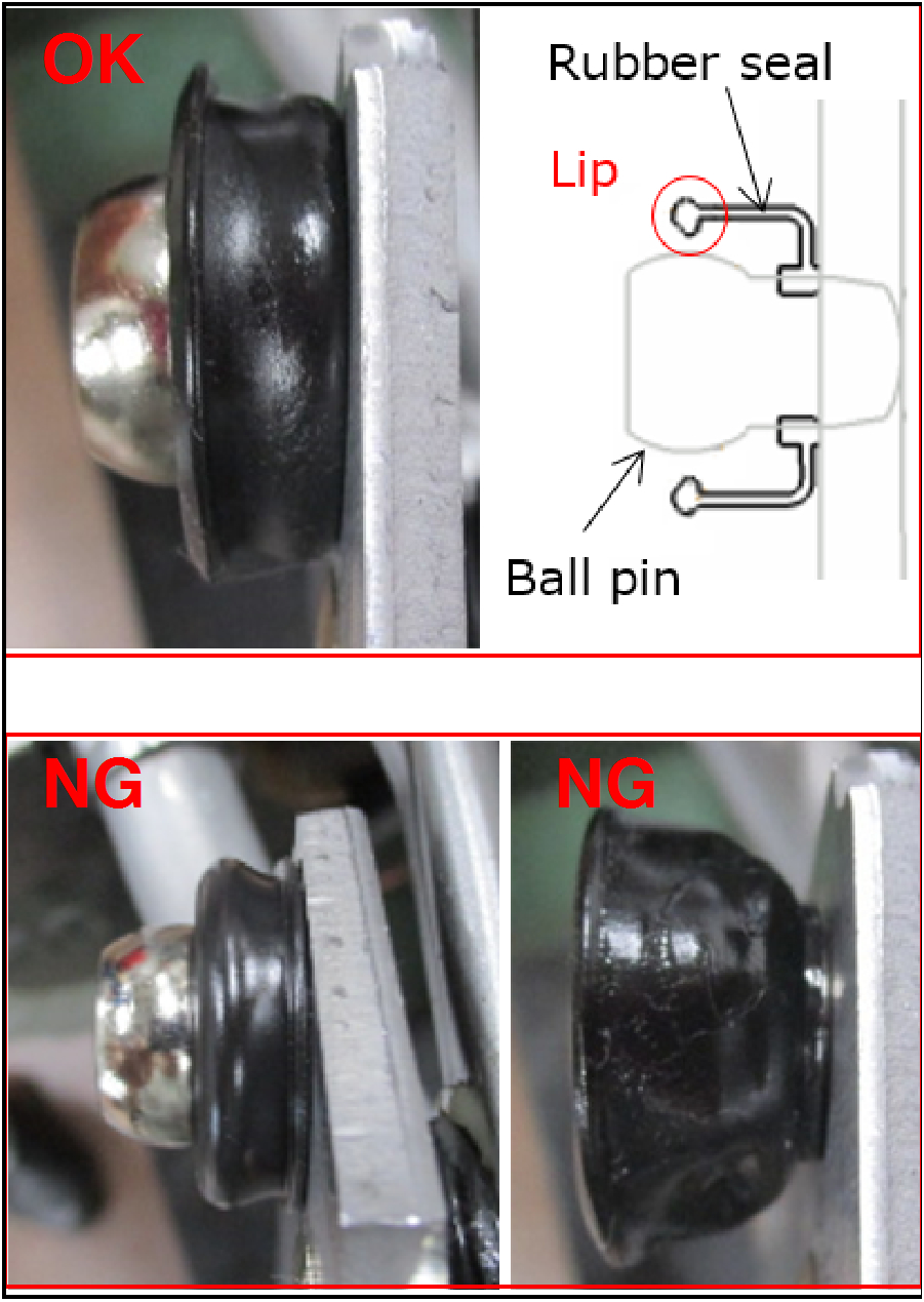

image The rubber seal must be properly seated. Confirm good condition of the rubber seal.
Verify that the rubber seal is properly seated.
image Confirm that the plastic case is not damaged or cracked.

Reinstall the wiper link assembly to the vehicle and connect the windshield wiper motor connector.
Torque bolts to 71 ± 18 in-lb (8.0 ± 2.0 Nm).

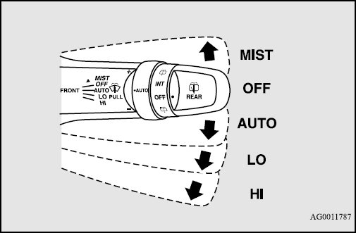

Switch the windshield wiper switch to “LO” and back to “OFF” to move wiper link to initial position.

Reinstall the front deck garnish.
Reinstall hood rear passenger side weatherstrip.
Reinstall the wiper arm blade assemblies to the marked locations.
Tighten nuts to 20 ± 2 ft-lb (27 ± 3 Nm).
Verify wiper motor operation by turning the vehicle ignition to “ACC” or “ON” and activate the windshield wipers in “LO” and “HI” positions.

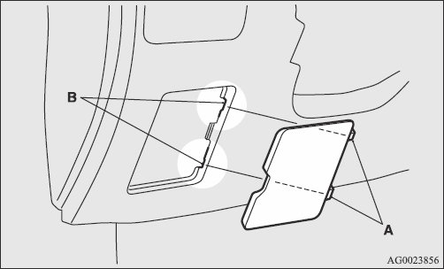

Reinstall the passenger compartment fuse lid by lining up the fuse lid hook (A) with the clamp (B) on the instrument panel and push the lid back in.
