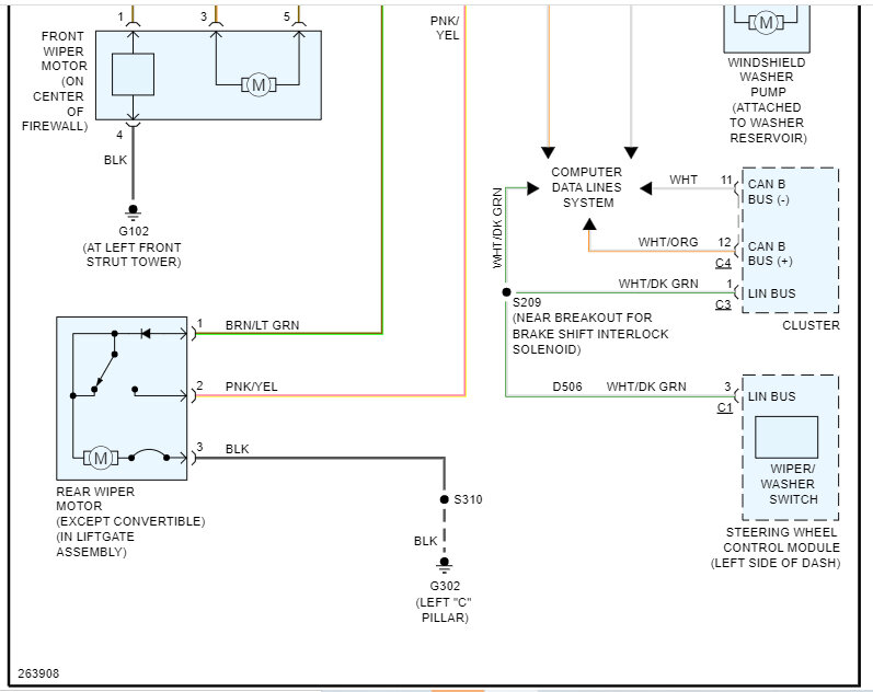

it's cold/ice cold. i tried to turn the wiper on, it tried and stopped. the windshield is clear, i can't find that specific fuse description in the IPM, there is no interior fuse box that i can find.
Jan 26, 2023 at 1:09 PM
  • 110,194 POSTS
There is no specific fuse for the wipers. Power supply is provided by the TIPM printed circuit board.
If you look at pic 1 below, I attached the schematic showing the wiring for the wiper motor. With the key on and the wiper turned on low speed, check to see if there is power to the brown wire with a white tracer at the motor connector. Do the same on high speed but check the brown wire with an orange tracer. If power is present, the motor itself is the first suspect. If there is no power, we need to work backward.

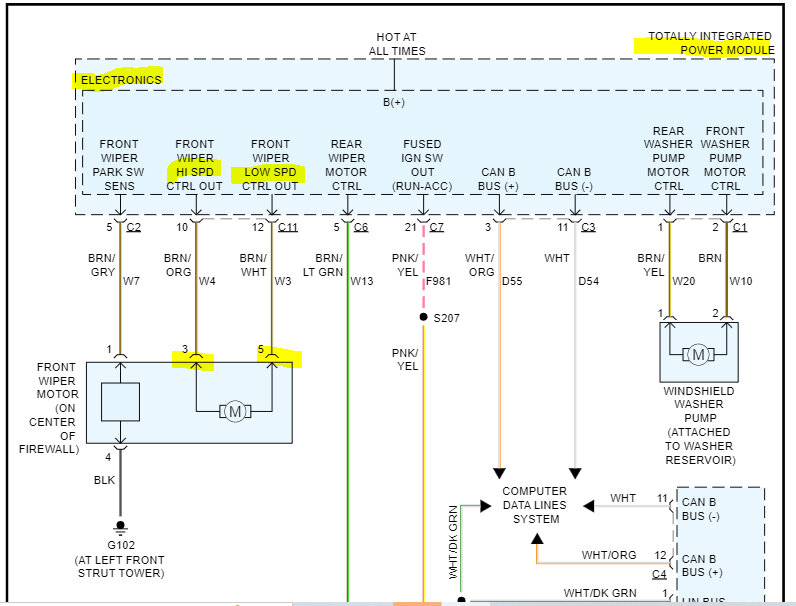

i have voltage at bn/wt on low and bn/or on high. i tried another motor and it still doesn't work. Is it possible that a pin/socket connection could read voltage but not carry enough current to run the motor?
Feb 7, 2023 at 12:36 PM
  • 110,194 POSTS
Yes, that is possible, or you have no ground. I have had the TIPM on these vehicles show power with the component disconnected, and when a load is placed on them, they fail.
You can test this by having the connection made at the wiper motor and back probing the power supply to see if it maintains voltage.

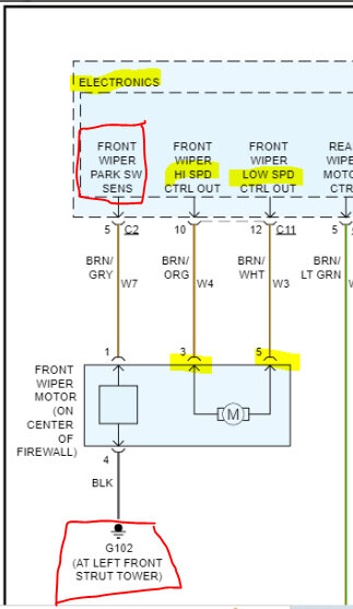

There is no ground at the motor, i took apart and cleaned both ground points near the left front strut tower to no avail. i added a ground to the black wire on the motor connector and the wipers work, so there is probably a broken wire between the connector and G102. i assume the park sw sens, W7 is an input to the TIPM, is that correct?
Feb 8, 2023 at 3:34 PM
  • 110,194 POSTS
Yes, the park switch is powered by the TIPM and grounded at the same ground, G102. See pic below.
I would simply make a new ground. What are your plans at this point?
See pic.
Feb 8, 2023 at 3:47 PM
JERRYSIDDOCK
  • 65 POSTS
i did make a new ground, i spent some time tracing down the existing ground but never found the break, unless it's in the bundle coming through the firewall. thanks for your advice and direction . . .
Feb 8, 2023 at 5:56 PM
  • 110,194 POSTS
Yep, it is likely hidden. In this case, I would do just what you did. Make a new ground. If it is working properly, that is what we want. LOL
