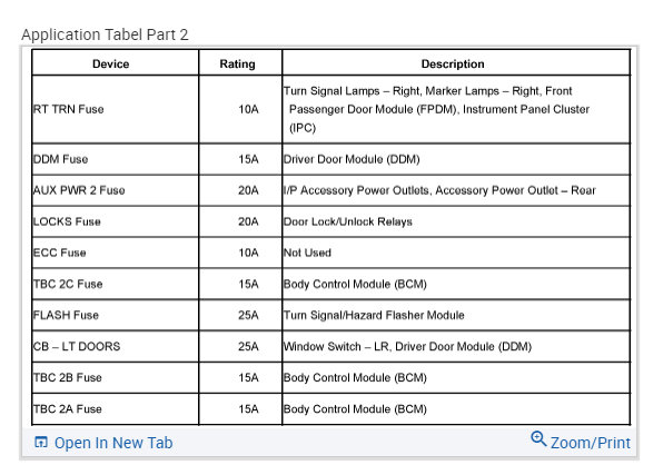

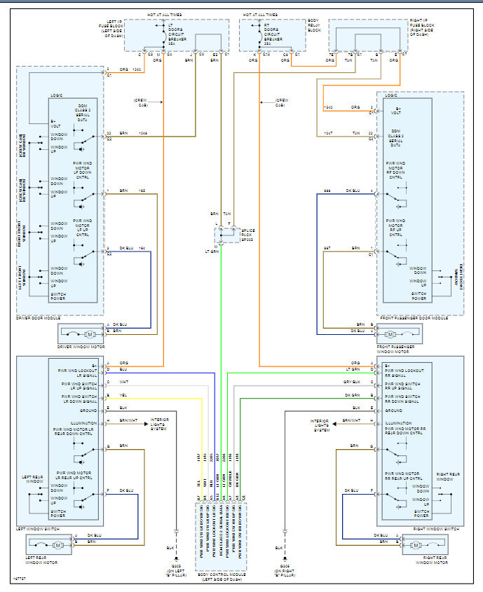

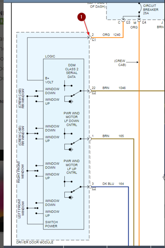

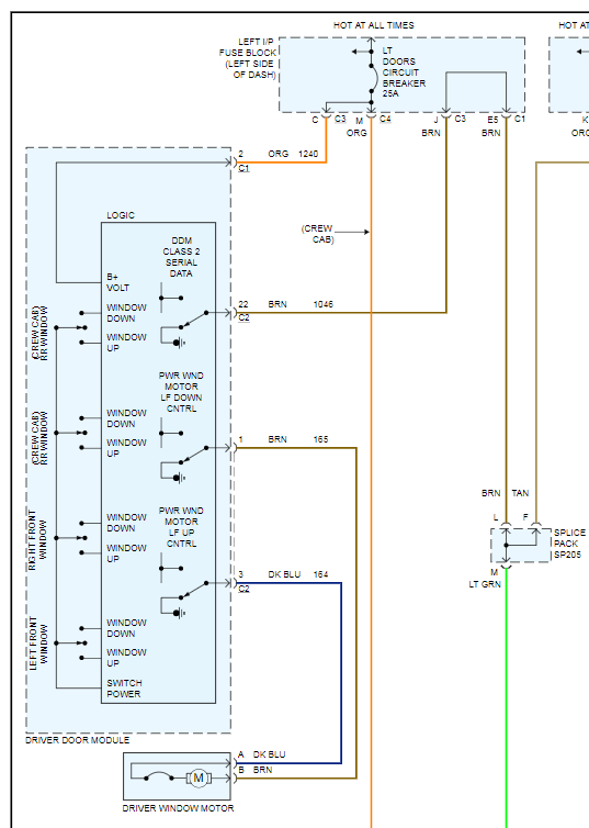

I included the wiring diagrams that we need to verify voltage to the door module on the power feed wire. If not we need to check the 25 amp fuse shown.

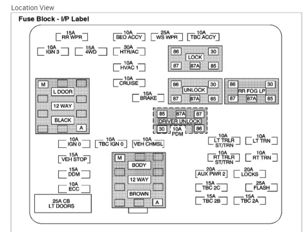

We need to check the CB-LT door fuse labeled in the IP fuse block. Let me know if that checks out and we can go from there.

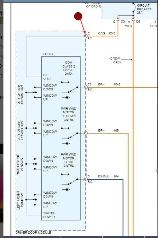

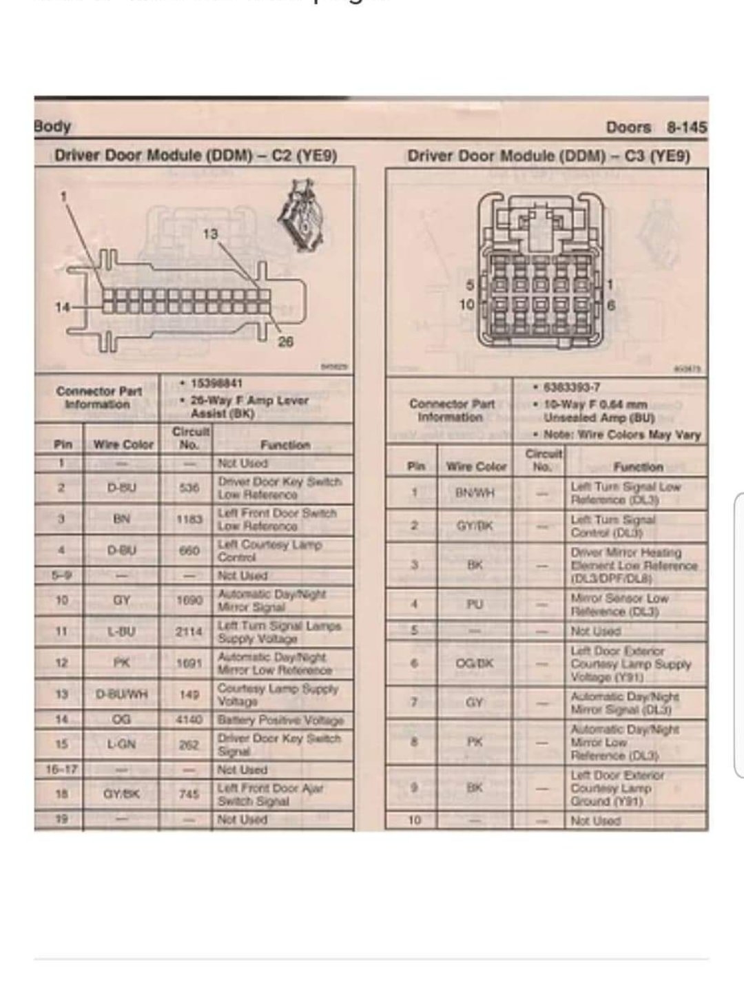

Cleaned all contacts and control module.I have checked power to the fuse panel.(That's good) I have checked power on the 4 wire connector. (That's good) the main brain connector (orange wire) has no power though. Also, is there a relay that I am missing?

Just to be clear you are on the driver door module with the orange wire and you have no power? If that is the case and the fuse is okay, you have a wiring issue. Try jumping 12 volts to the driver door module orange wire and see if it starts operating. If you do then you have a wiring issue again, assuming the fuse is good.

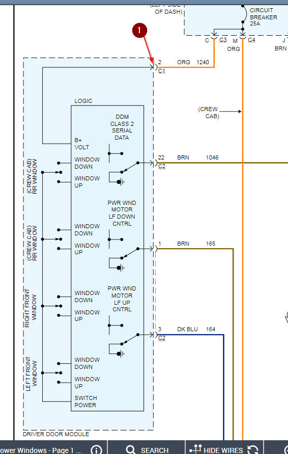

The plug on the left. I do not have power to that one. But I do have power to the window motor. Just doesn't work. No lights on the control module either.
I check the Ohms on the fuse, and changed it with another.

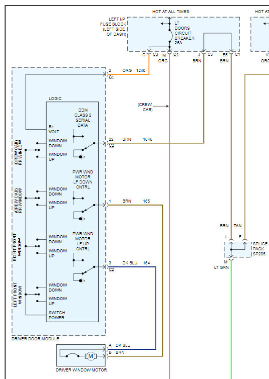

Okay. Those are different circuits. The power for the driver door module window circuit is on C1 pin 2. That connector that you show in the picture is C2.
If you have no power to that connector then that may explain why you have no lights as the courtesy lamp circuit on it for the left side.
As for the window, if you have power to the motor then the motor is most likely the issue.

Well the driver door control module controls each of these items but they are all separate. Unless something happened to short this out it just doesn't seem to add up with what was done for it to all happen as once.
If you look at the wiring diagram it shows that the windows and switches for each side have separate fuses to each door module.
Let's just focus on one issue and fix that and see if the others get fixed as well.
Go to the DDM and check voltage on each of these wires when using the switch. Or just measure voltage at the motor when you are rolling up/down the window and tell us if you have voltage there.
I think you said earlier that you did have voltage at the motor. If you do then the motor is the issue. Let's start here and then move on. We basically just need to start somewhere and fix one of them and hope they are all related and they all get fixed. Trying to figure out the common component does not seem like it is going to pan out as there is nothing obvious.
