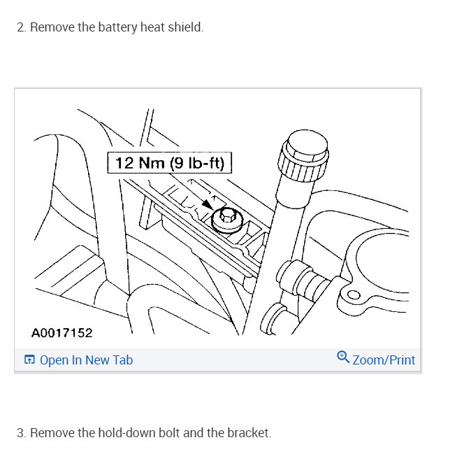

Parked it last night. Have not had any problems. Today the ignition does nothing but got lights and power. no sounds or clicks when turn the key. doesn't do anything.

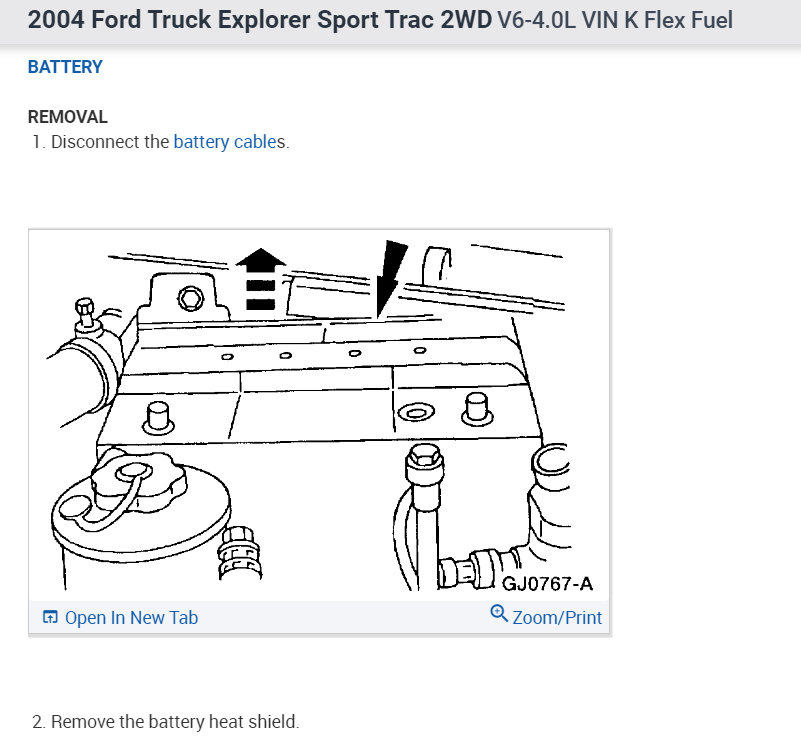

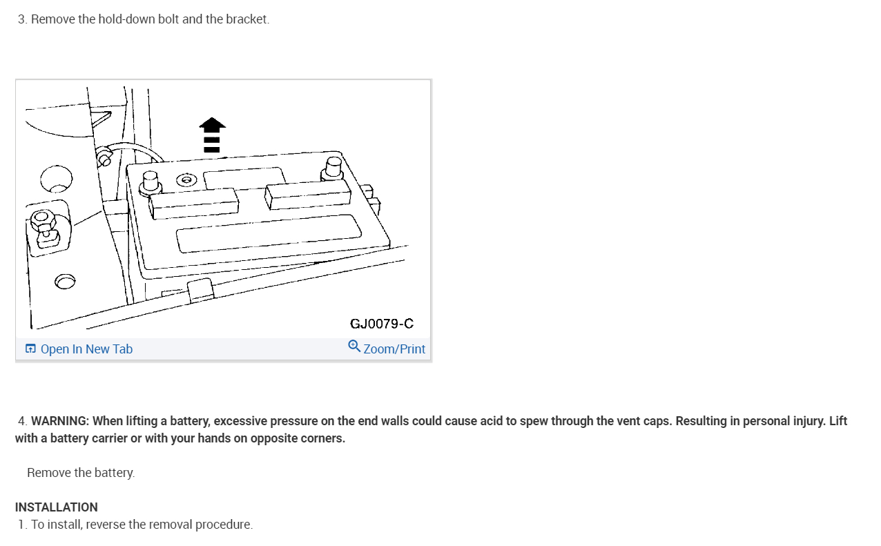

Yep, this can be one of two things, either the battery is drained, or you have a bad connection at the battery, I would try to clean the connections the battery first which this guide can help with:
then load test the battery which you can do with no equipment by following this guide
If the battery fails let's install a new battery which this guide can help with, and I have included specific instructions for battery replacement in the diagrams below:
