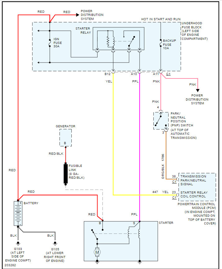

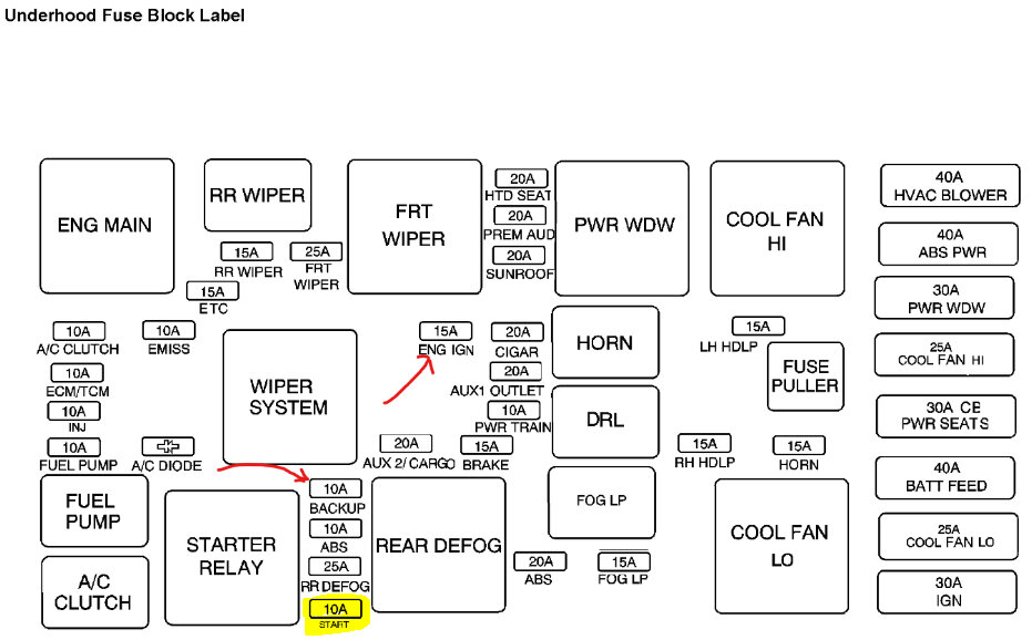

When checking the purple wire the key must be in the crank position. We need to check the IGN and backup fuse for power.
This guide can help:
Here is the wiring diagram for the starter so you can see how the system works and I have included the fuse location as well. Also, there is an outside change the engine is locked up so please go over these guides to get an idea on what is wrong and how to fix it.

I have checked all the fuses again, both in the engine compartment and console. The only fuse not getting power is the Start 10 amp fuse, either when the ignition is in run or attempting to start.(highlighted Pic included) I have power from the Battery (which is good) to the starter, but still no power through the purple wire when the ignition is engaged.( Ignition module replaced) The starter motor makes no noise at all.(starter has been replaced) The engine turns, and is not locked. We also replaced the neutral safety switch during this process.

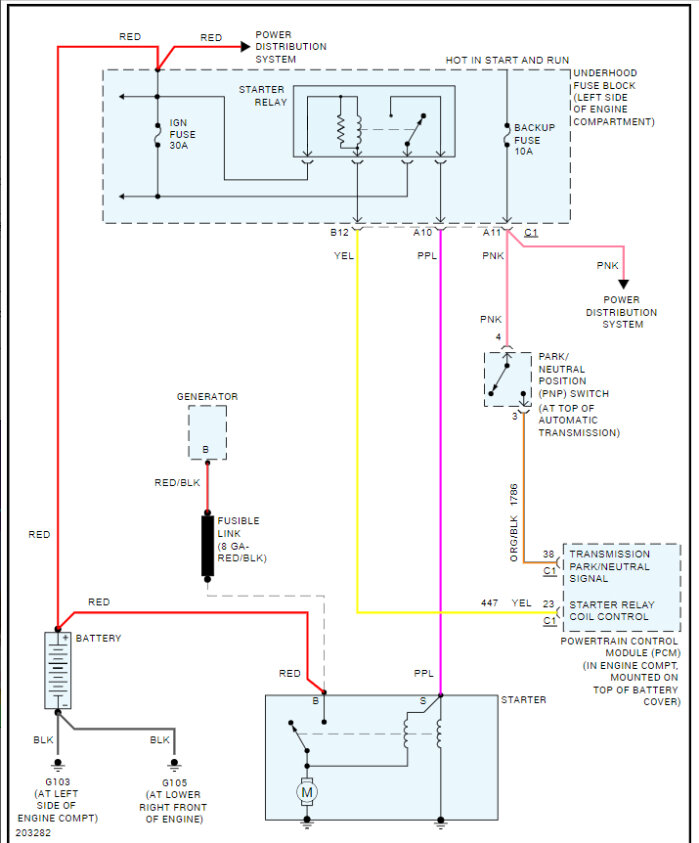

No power through the purple wire is the problem. I assume you checked the fuses I motioned earlier. The PCM closes the relay to give power to the purple wire. Do you have a security light flashing when you try to crank the engine over? The org/blk wire must have power to the PCM terminal #38 on the C1 connector. Can you please test for that and go over this wiring diagram to understand the system?
