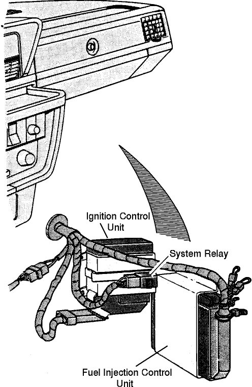

The main relay has always been a problem on these cars. It is located behind the sound proof panel on passenger side (underneath glove box). The main relay turns on the computer and energizes the fuel pump. Check it next time it wont start. Open up the main relay by removing t he cover. When you turn the switch on, you should see both contacts close. When it wont start and one of the contacts fails to close, gently close the contact. If it starts up replace the main relay. Hope this helps.
Jul 5, 2016 at 11:24 AM
JIS001
  • 3,412 POSTS
Added a picture.
