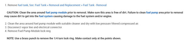

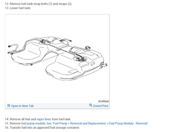

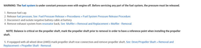

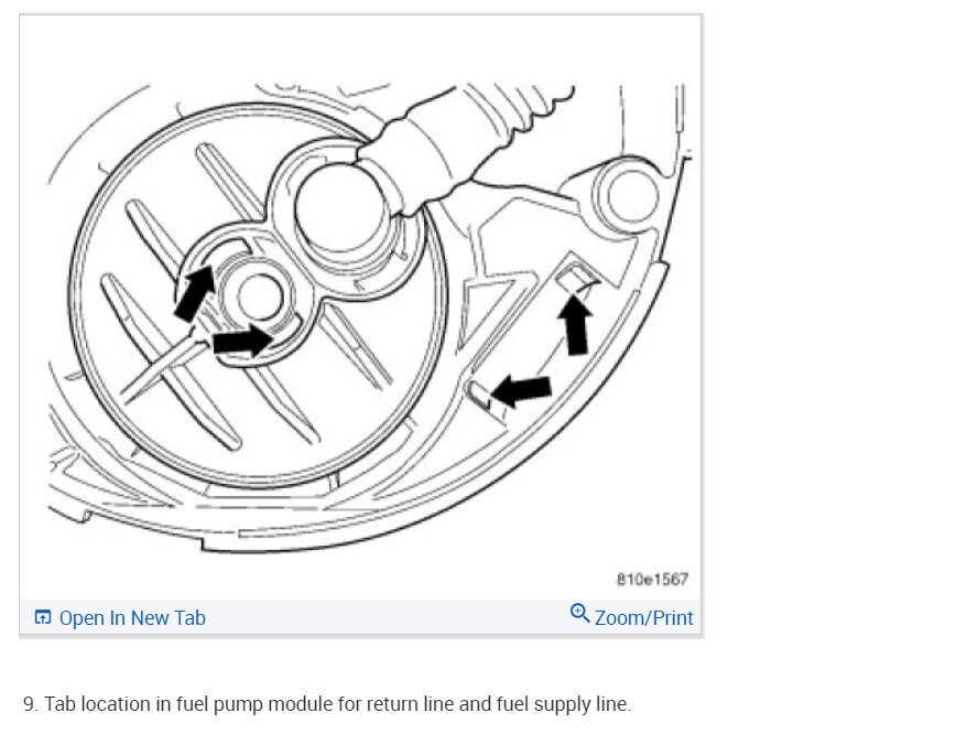

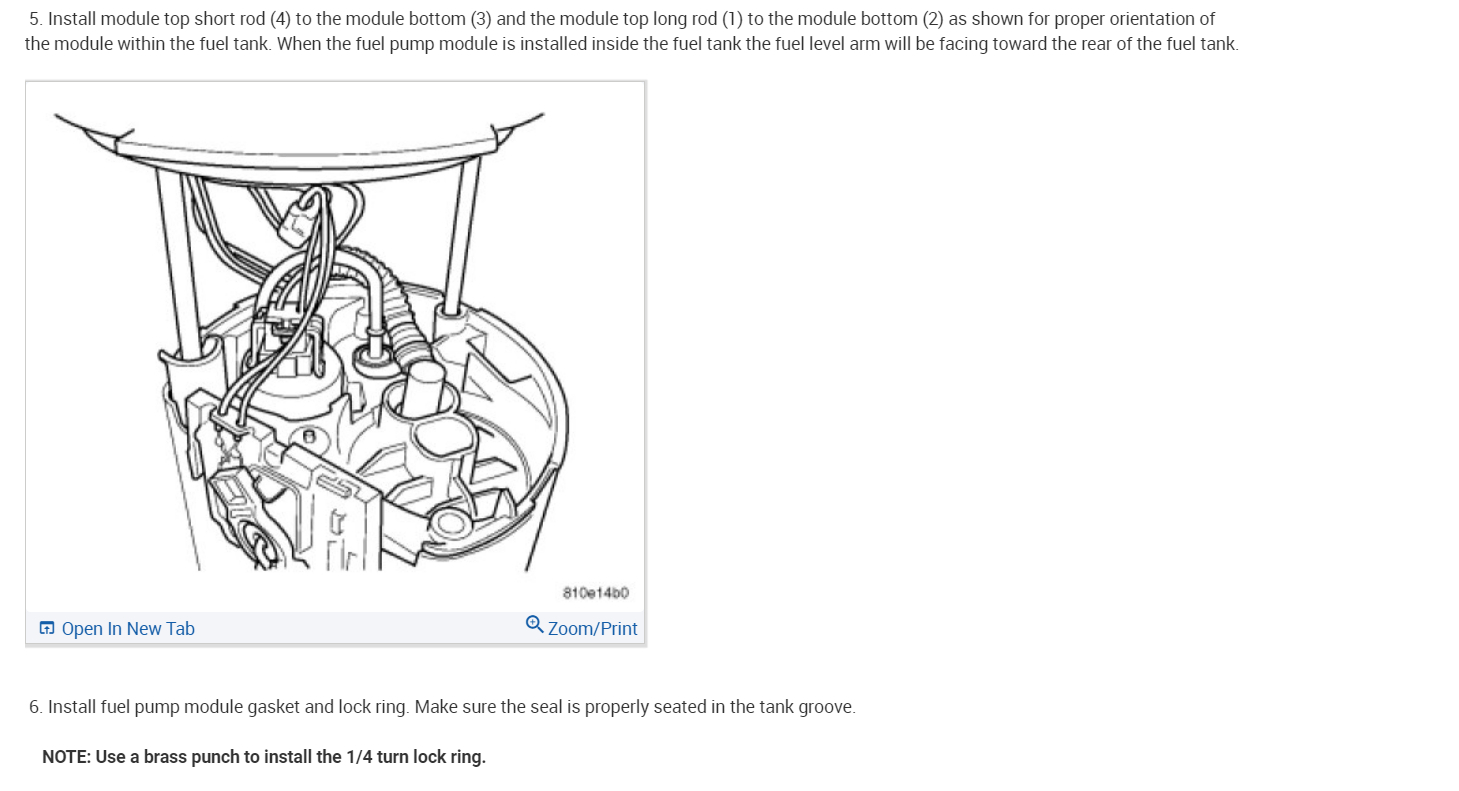

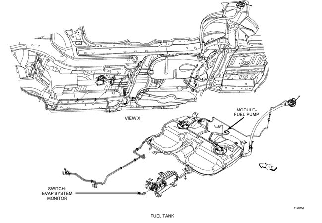

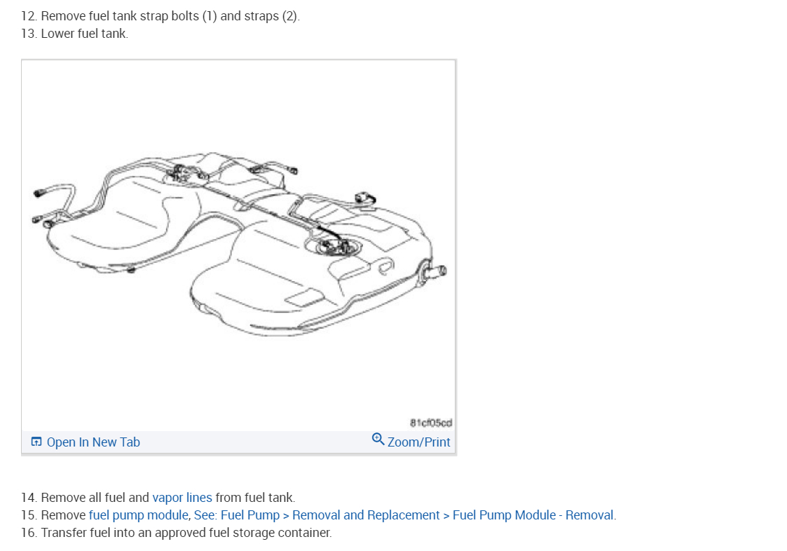

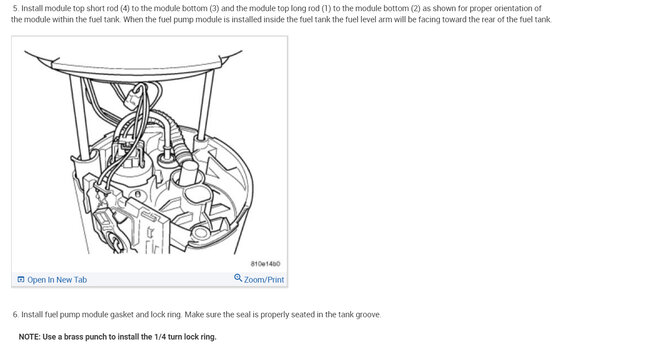

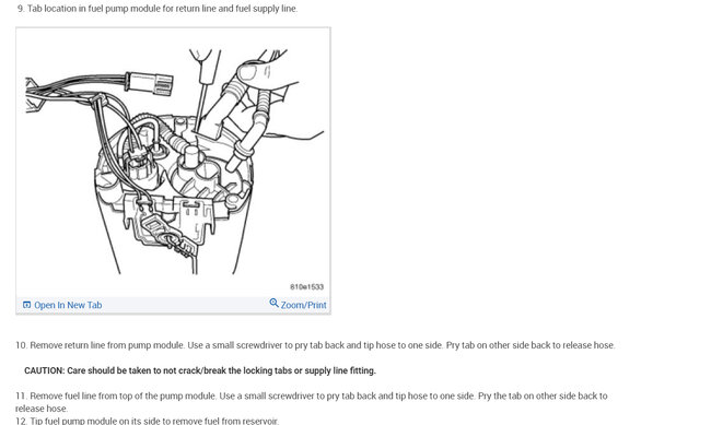

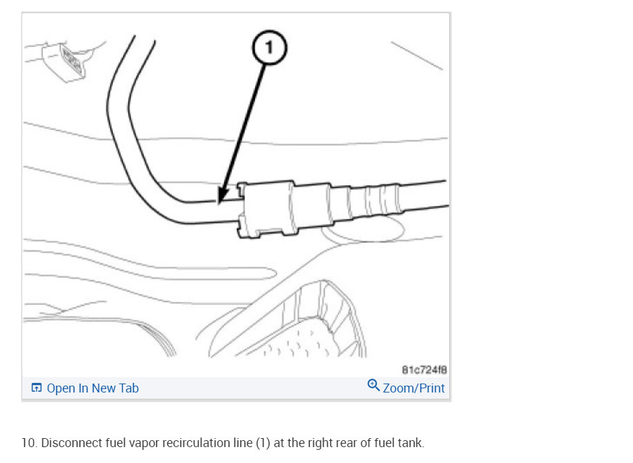

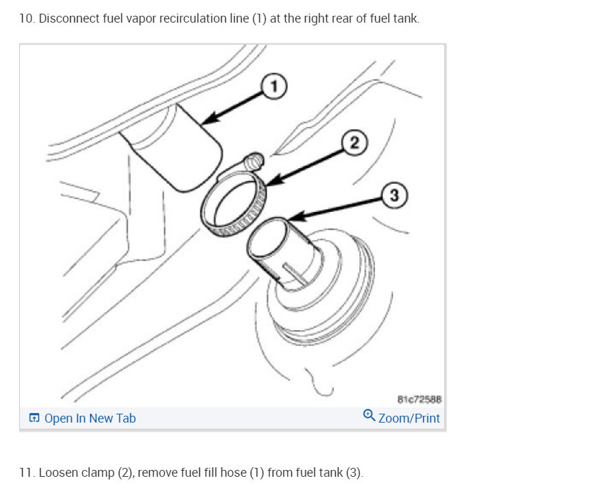

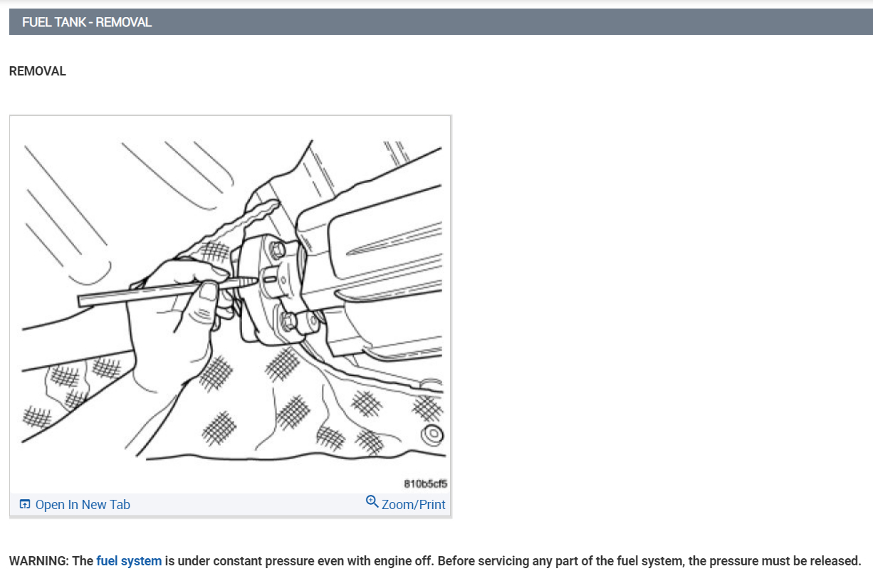

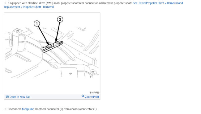

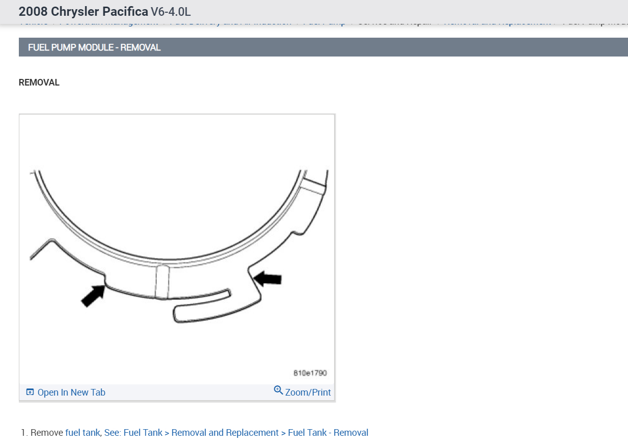

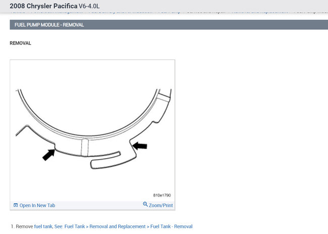

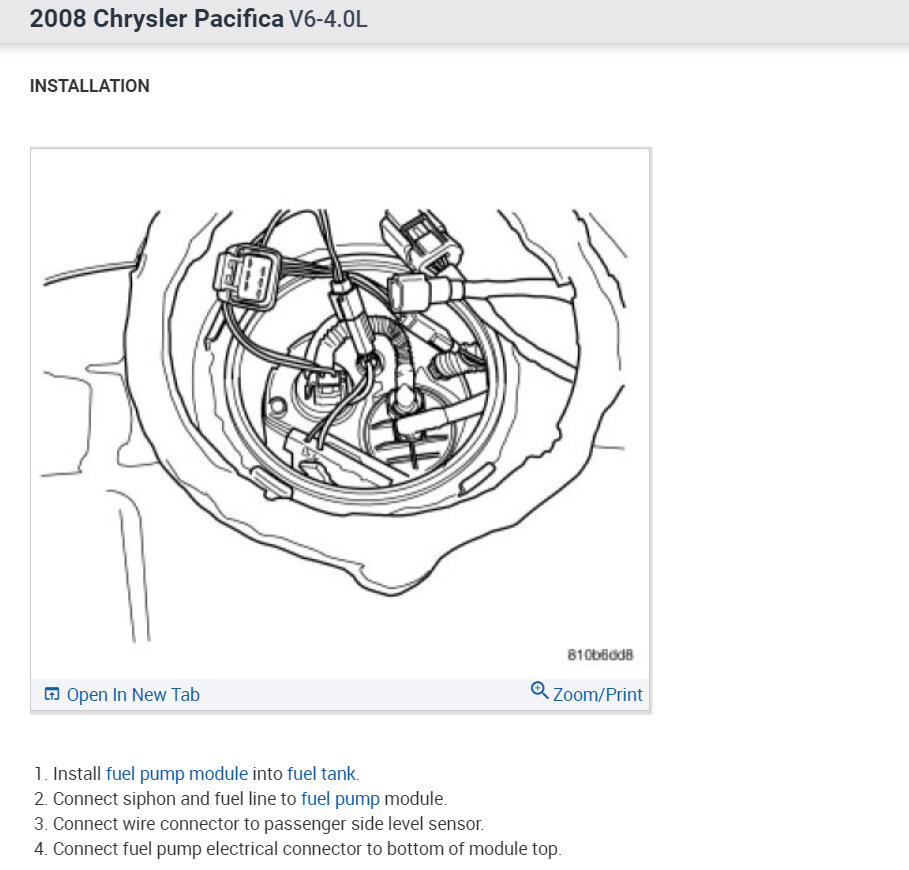

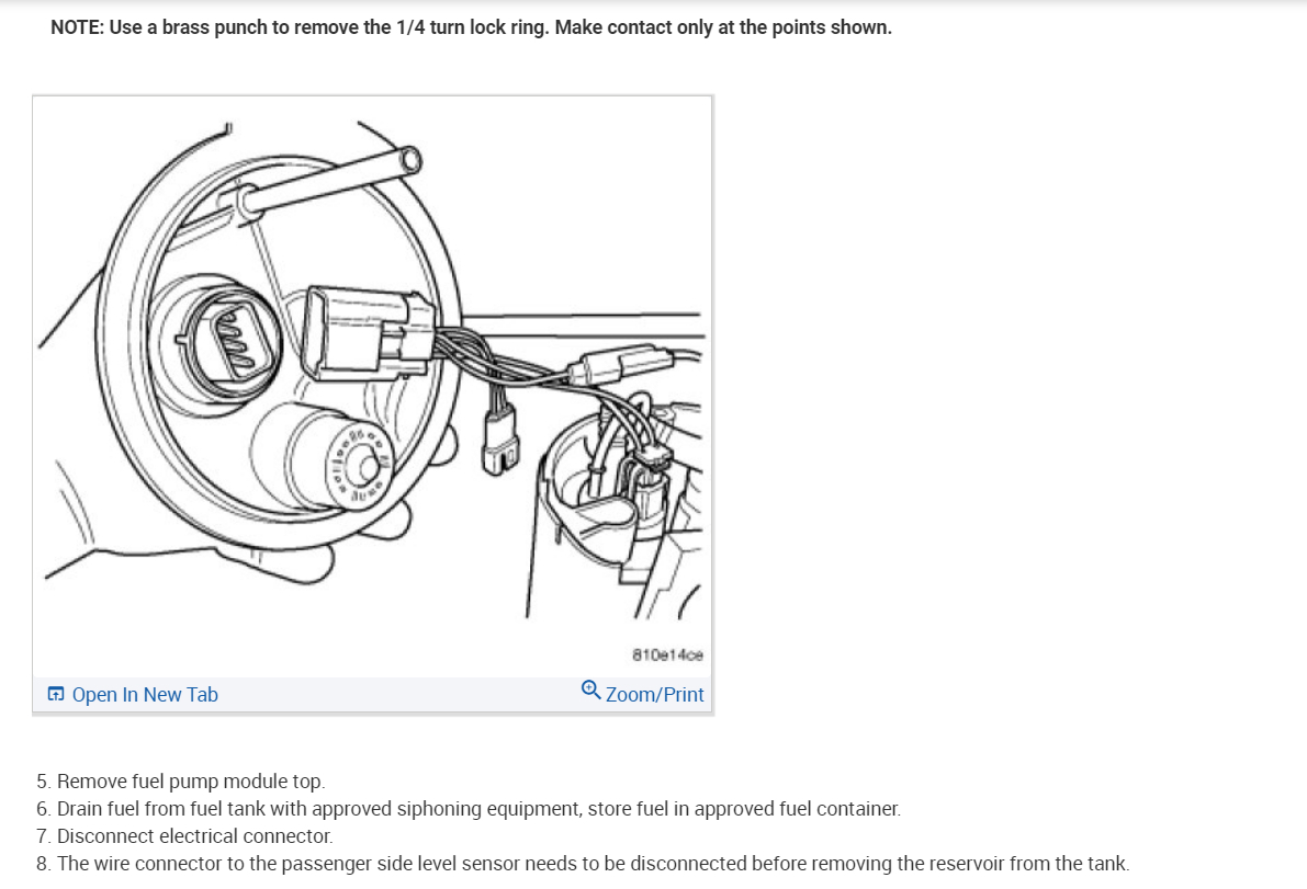

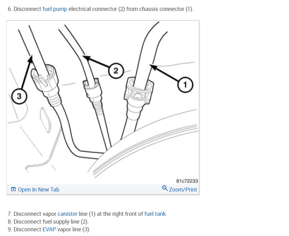

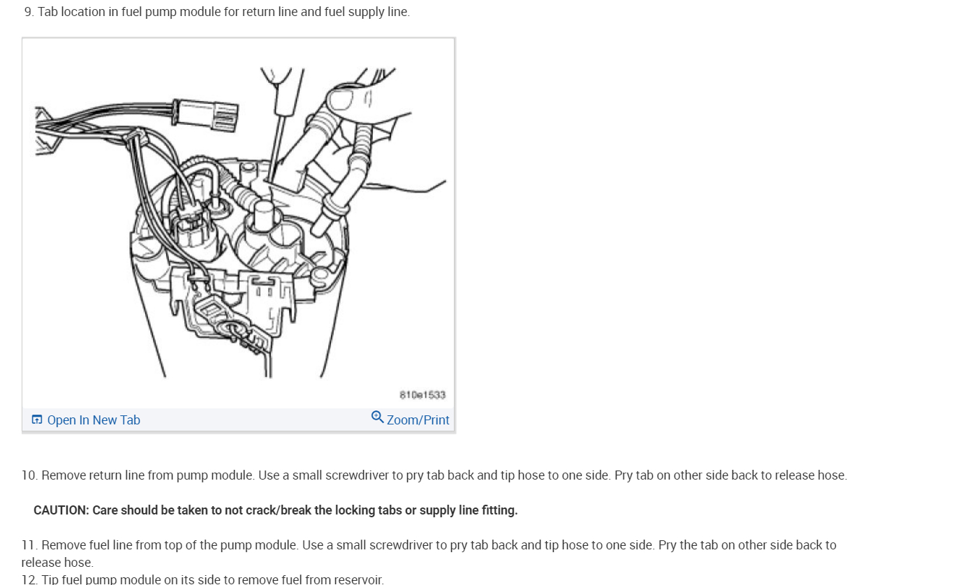

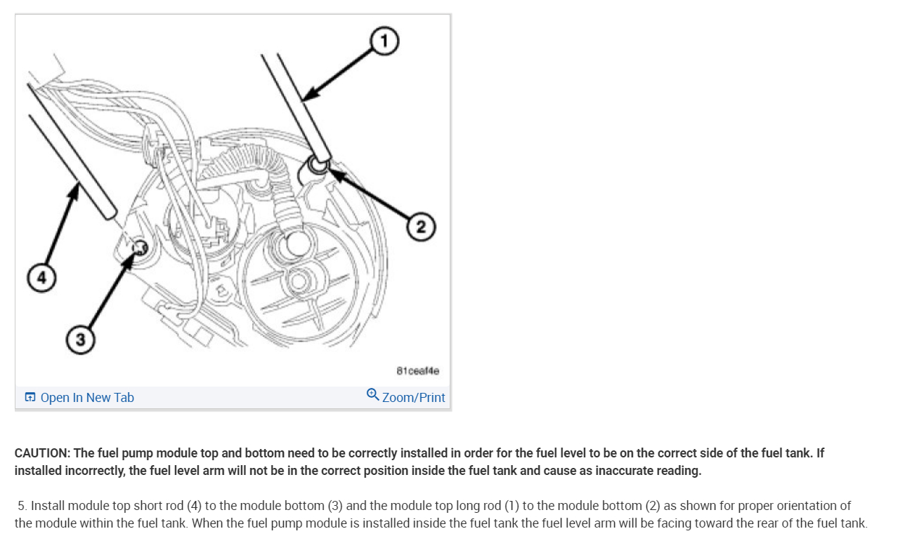

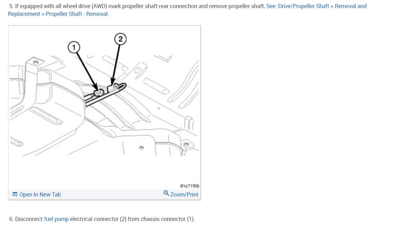

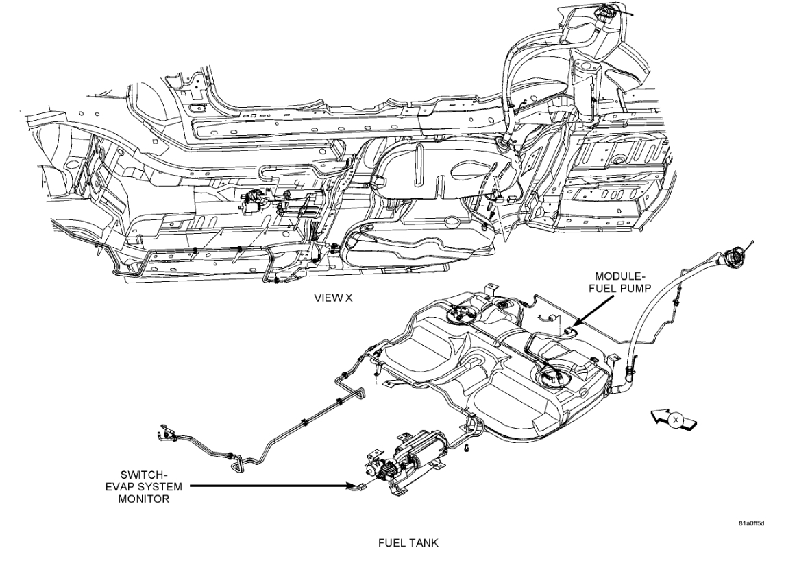

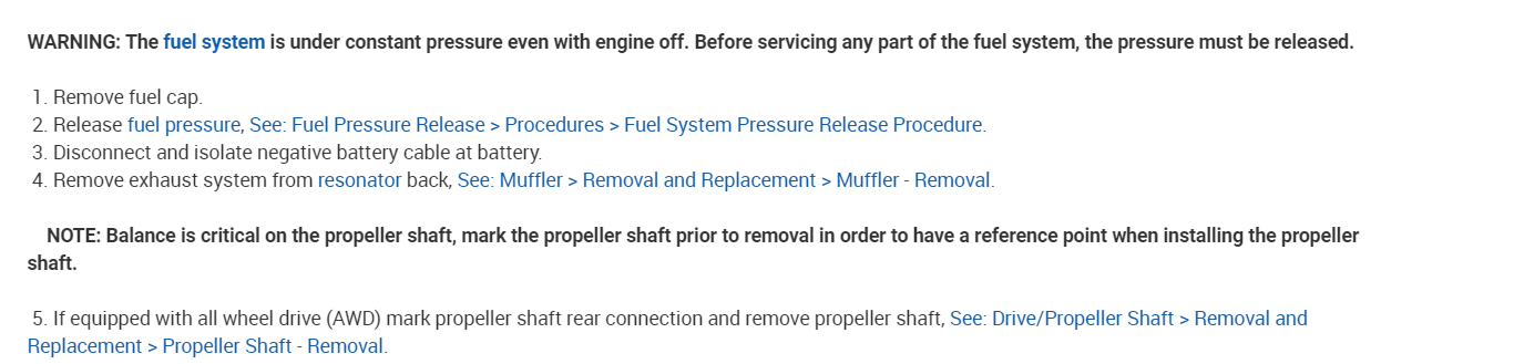

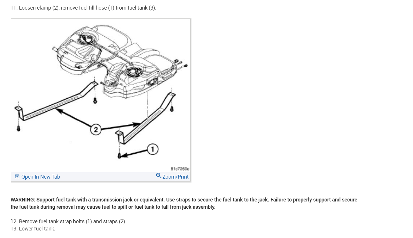

It does sounds like the fuel pump is getting weak, but to be sure please follow this guide:
You can rent a fuel pressure gauge kit from the local auto parts store.
Fuel System Pressure
400 kpa ±34 kpa (58 psi ± 5 psi)
May 22, 2023 at 8:46 AM
