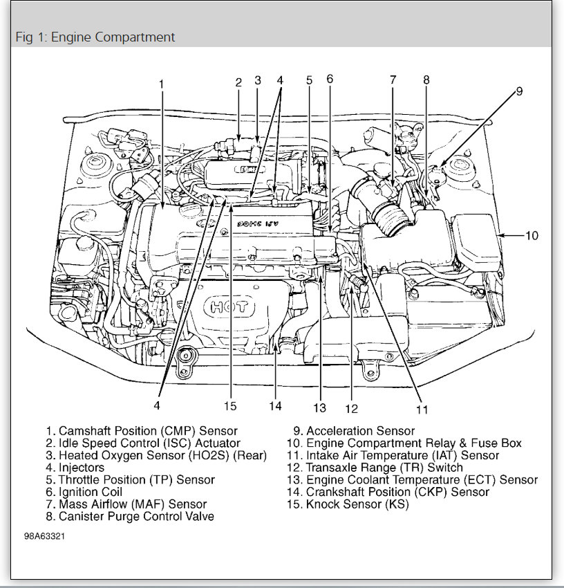

GLS model. Sometimes after driving at 60 kphs around the town, revs really high all of a sudden and then becomes sluggish to drive for a while. The transmission has been serviced, and I don't use transmission oil at all. I am wondering if it could be the fuel pump, the transmission solenoid or running the car too low with the fuel. It only does this every now and again, and I don't do many open road drives. Could this be the problem? I look forward to your reply. Cheers. I also have a bottle of Lucas Transmission Fix and do I need to let some fluid out to add that or just add it? Robyn

it sound like engine idle control is not working properly. because if the problem was vacuum leak engine rpm is always be high. check fault codes first.

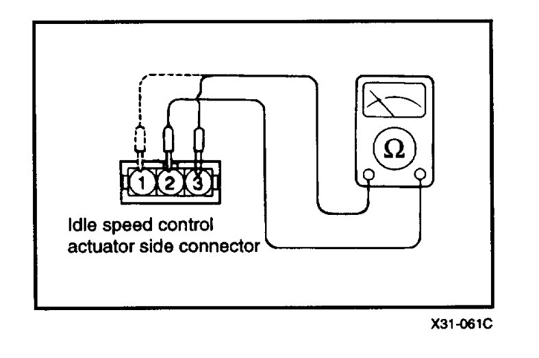

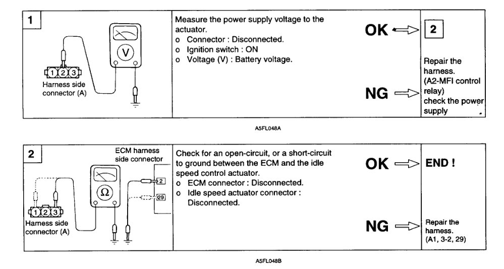

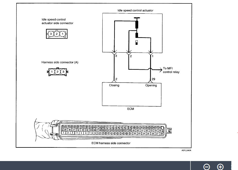

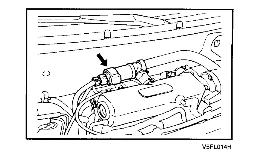

The idle speed control actuator is the double coil type and has two coils. The two coils are driven by separate driver stages in the ECM. Depending on the pulse duty factor, the equilibrium of the magnetic forces of the two coils will result in different angles of the motor. In parallel to the throttle valve, a bypass hose line is arrange, where the idle speed actuator is inserted in.(check its location at picture 1)(circuit diagram picture 2).

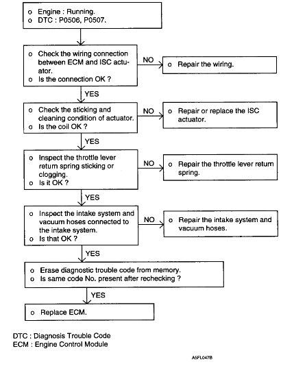

check harness inspection procedure(picture 3).
actuator inspection.(picture 4)
1. Disconnect the connector at the idle speed control actuator.
2. Measure the resistance between terminals.
Standard value
Terminal 1 and 2 16.6-18.6 Ohms
Terminal 2 and 3 14.5-16.5 Ohms [at 20 °C (68 °F))

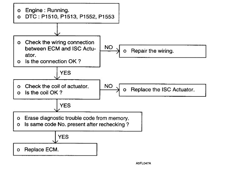

Troubleshooting Procedures(picture 5)
Trouble shooting hints
Open or short circuit is observed in idle air control system when ignition switch is turned on.(picture 6).
please run down these troubleshooting and report back.
