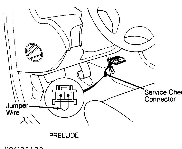

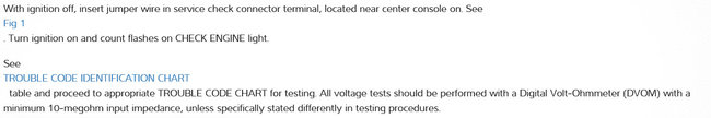

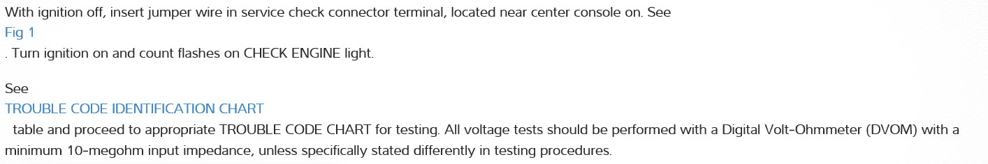

HMAC300
  • 48,601 POSTS
scan for codes and check fuel pressure with a gauge auto parts rent it. see pics for code scanning for code definitions look under engine OBD1
