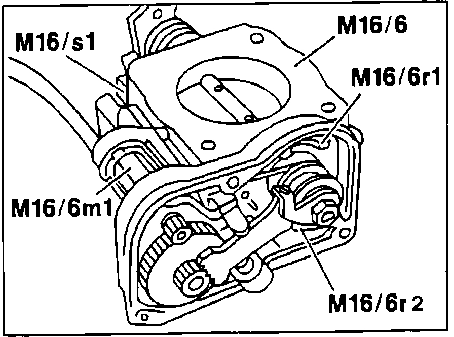

If this is happening when you make a hard turn at idle, it sounds related to a idle speed control actuator (ISC). Do you ever notice it if you are in gear at idle and turn the AC on?
The ISC is what maintains idle speed. Now, when you turn hard left or right, the power steering pump places a heavier load on the engine. If the ISC doesn't react to the added load, the engine can stall. I mentioned the AC. That places a heavy load on the engine as well. That's why I questioned if you ever noticed it happen when the AC is turned on.
What I would like you to do is simple. Pay attention to the engine RPM's when you make the turns or turn the AC on. If you notice the RPM's dropping to a degree that it could stall the engine. The ISC is my first suspect.
This component is mounted on the throttle body of the vehicle. I attached a pic of it. Basically, it consists of a throttle valve (which is what increases and decreases the engine speed and a small electric motor which responds to engine load only at idle.

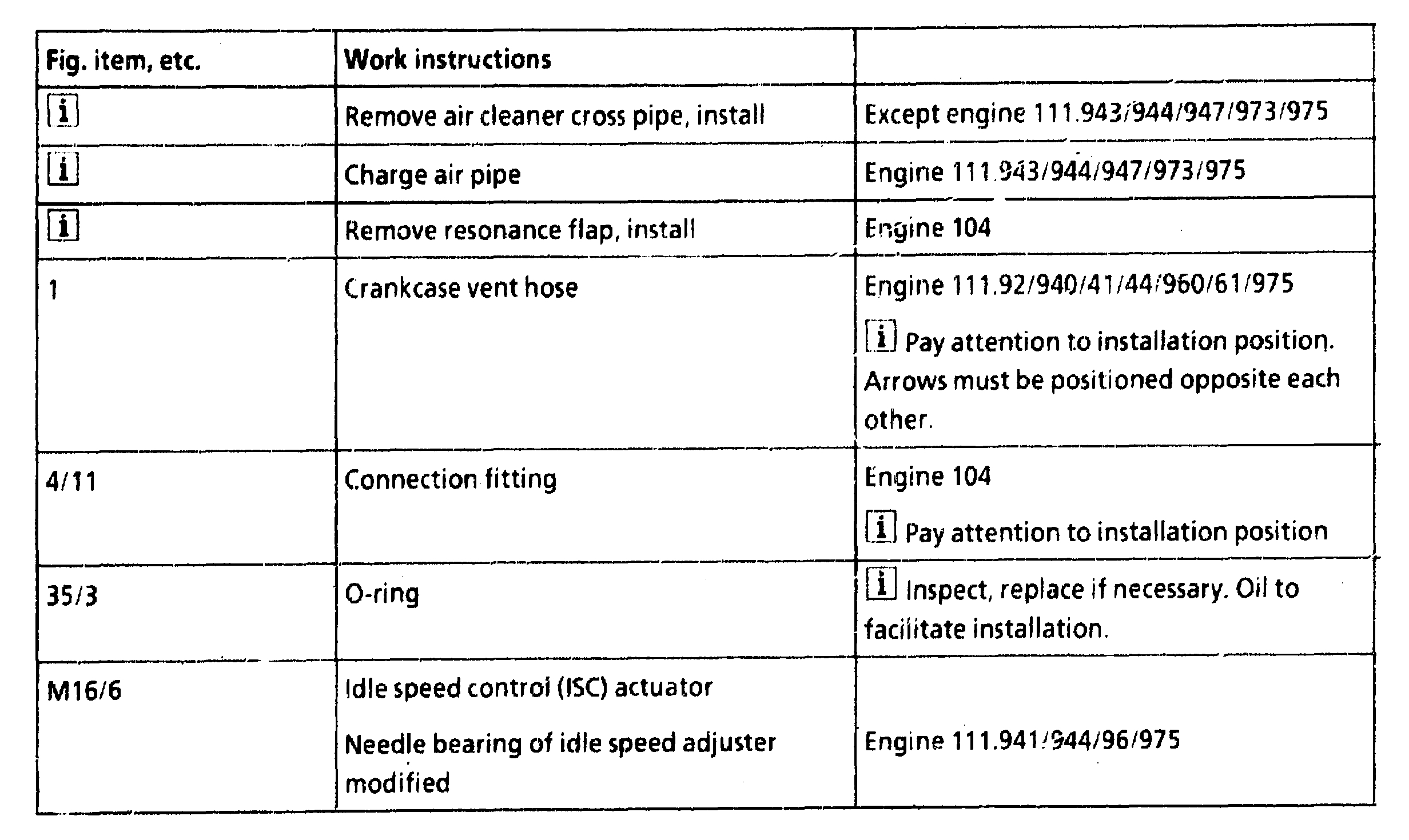

Here are the directions specific to your vehicle:
_________________________
1995 Mercedes Benz C 220 (202.022) L4-2.2L (111.961)
Remove/Install Idle Speed Control (ISC) Actuator
Vehicle Powertrain Management Fuel Delivery and Air Induction Idle Speed/Throttle Actuator - Electronic Service and Repair Removal and Replacement Remove/Install Idle Speed Control (ISC) Actuator
REMOVE/INSTALL IDLE SPEED CONTROL (ISC) ACTUATOR
see pic 2

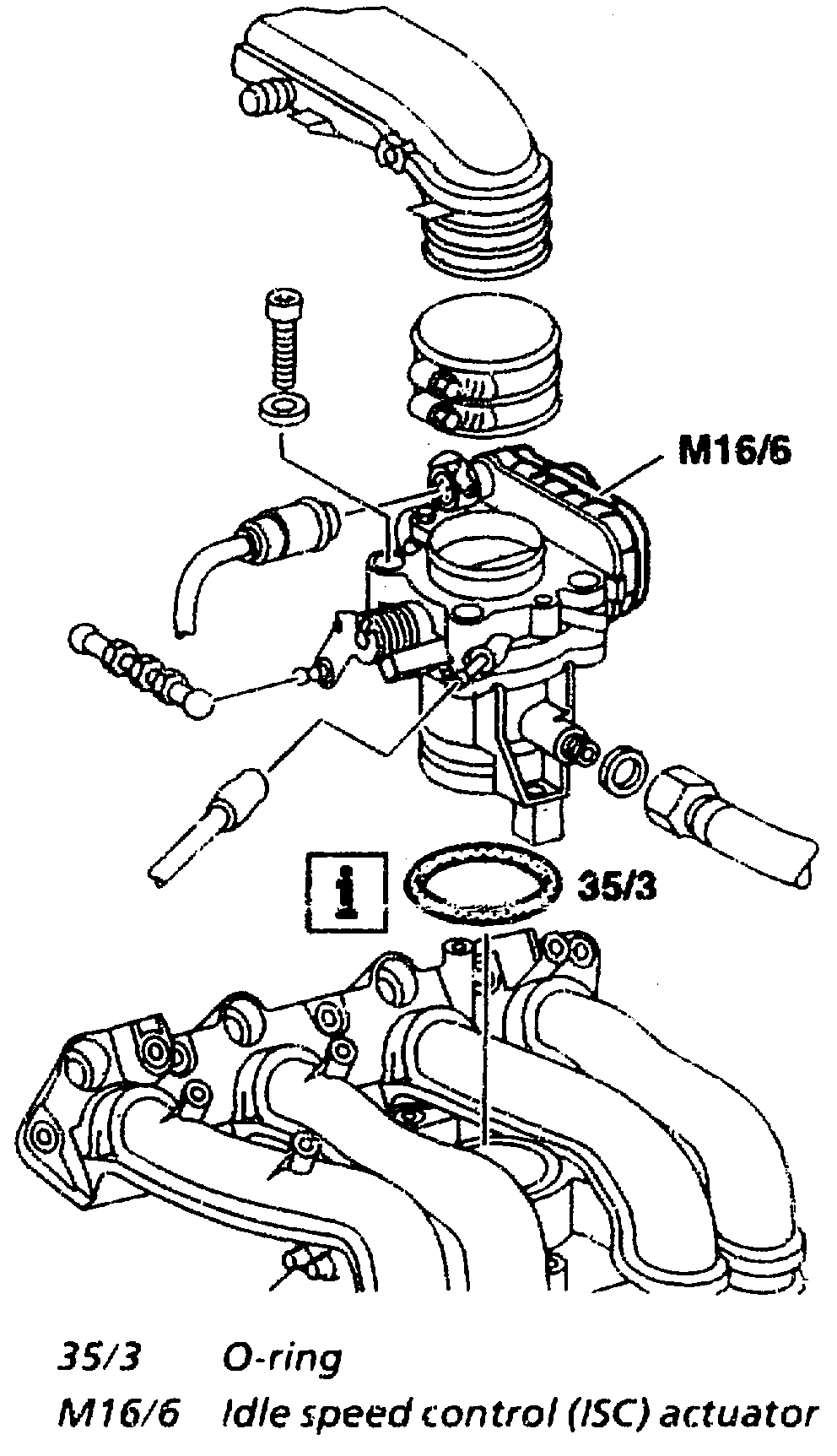

Engine 104
see pic 3

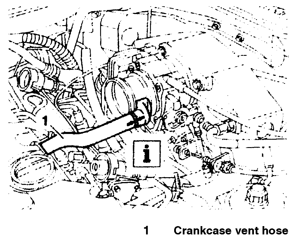

Shows engine 111.942/70
see pic 4

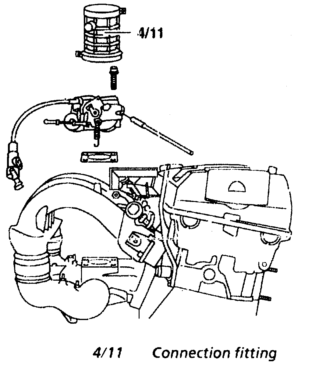

Engines 111.92/940/41/44/960/61/975
see pic 5 (the actual procedure for replacement)
