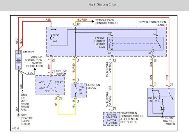

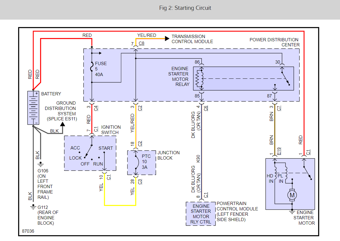

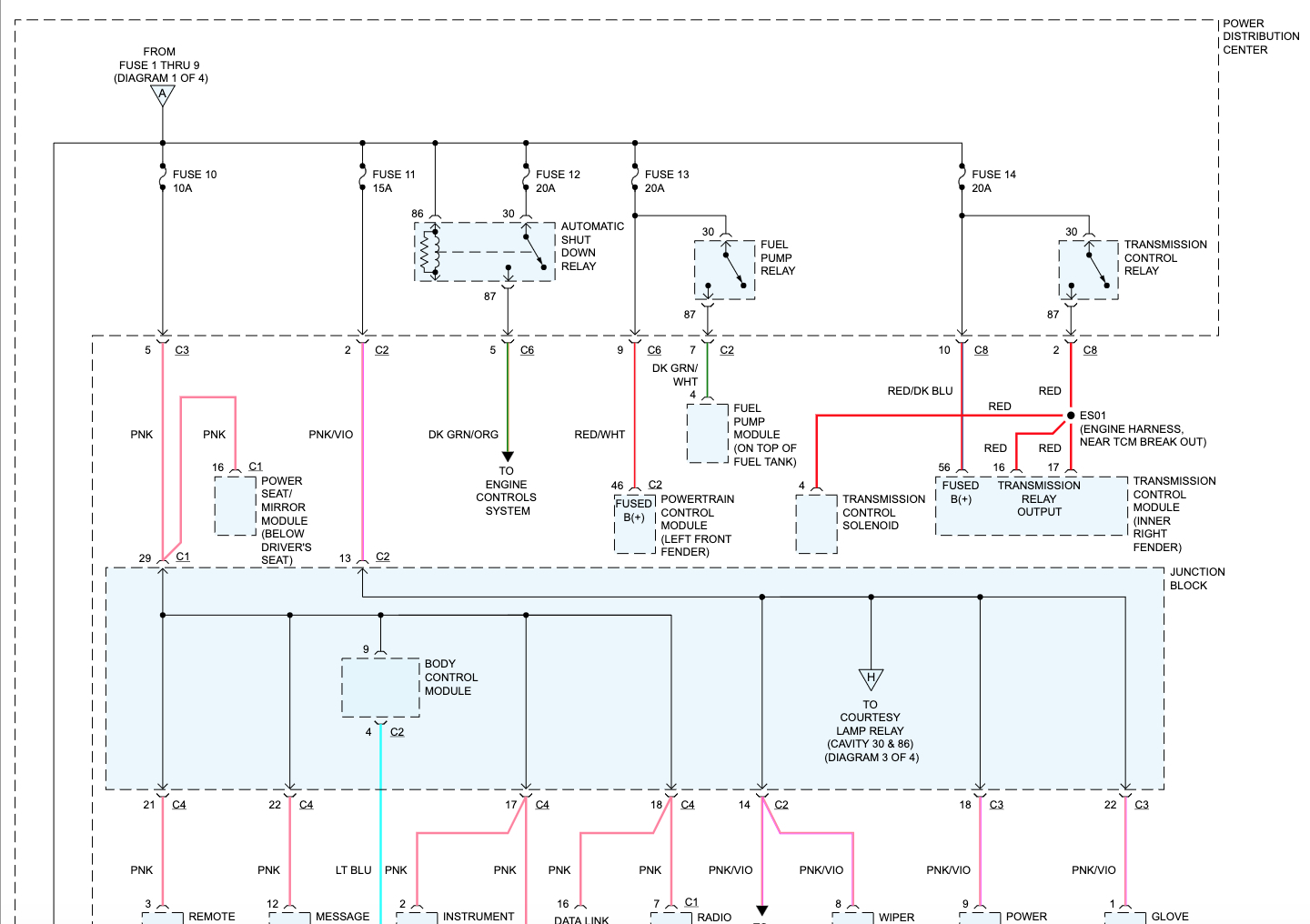

  • 54,840 POSTS
Is the security light flashing when you try to crank it over? If so here is a guide to help you reset the system if not here is a guide and the starter wiring diagrams so you can see how the system works:
https://www.2carpros.com/articles/how-to-reset-a-security-system
and
Mar 23, 2019 at 2:13 PM
