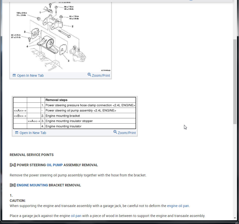

Car drives just fine in reverse. I can gun it no problem, but when I put it into drive and drive for a very short amount of time and mainly when I make a left turn it seems as if the transmission disengages and engages all while the whole engine and transmission shake out of control. It feels like something is almost stuck in my wheel and makes it jolt to the right. You can also feel it in the gear shifter. It all stops when I put it in park. Any ideas? I’m really not trying to replace this transmission. Please help! I’m stumped as to what it could be!

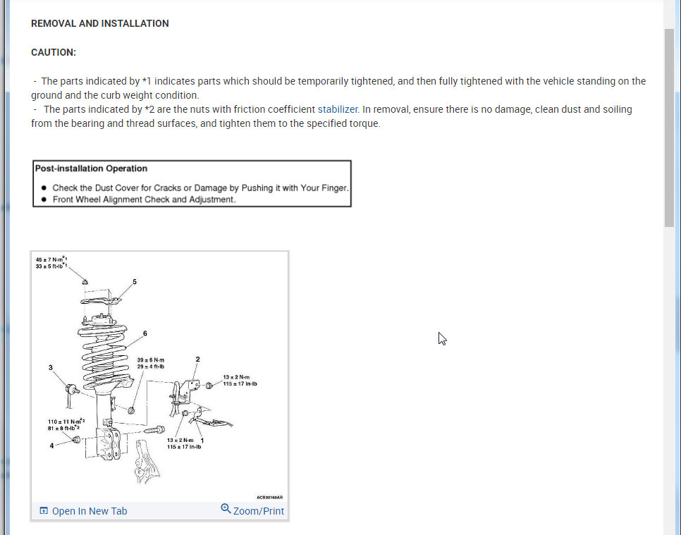

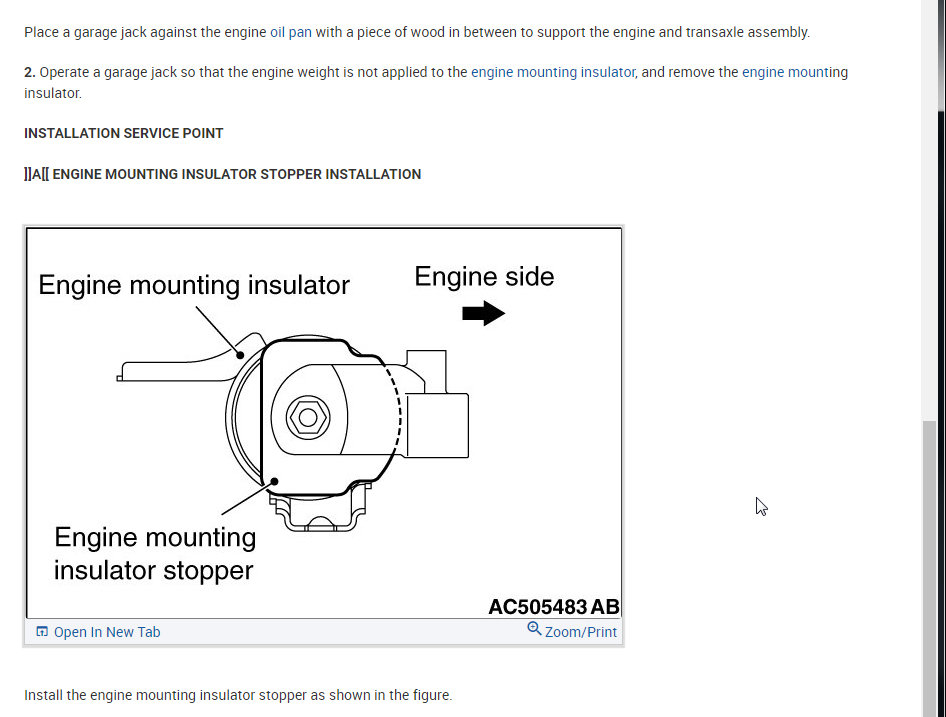

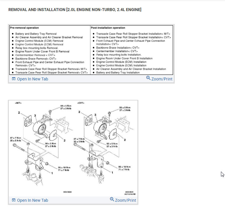

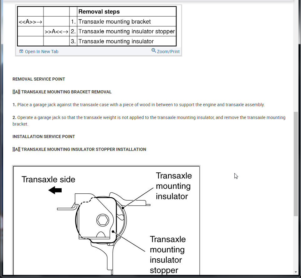

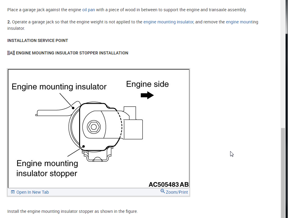

This sounds like it is something in the transmission just based on what you are describing however, it could also be a mount issue. Clearly this would be a better issue then a transmission issue so let's start there.
I am attaching the info on how to replace the mounts but I would just use this to inspect them and make sure they are not grounded.

Okay, so I’ve checked the mounts and all of them seem to be fine. I will upload a video of what’s going on as soon as I can.

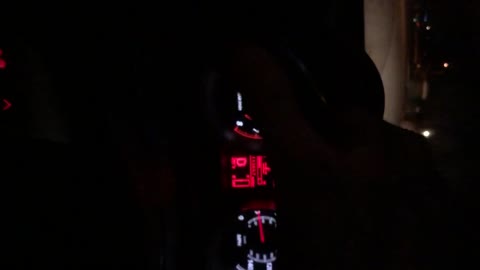

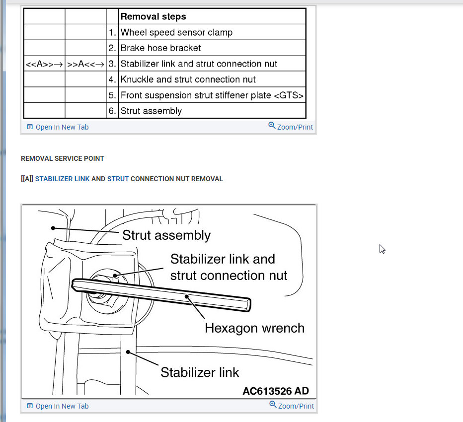

Sorry It took so long for a video but here it is. You can really hear what’s going on at about 1:21-1:24 it sounds like a hard shake or bump. If I have to upload something better I will.
Jan 23, 2021 at 7:07 PM

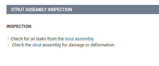

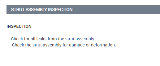

Just to be clear, this is the loud noise when you hit a speed bump or whatever that was in the road? If that is the case, this is the shocks bottoming out and the loud noise is the actual control arms of the suspension hitting the bump stops.
However, it looked like you hit that pretty hard so I am not sure new shocks will prevent that but I would definitely change those first and foremost then make sure there are no broken suspension components.
I included the process below for your review.

No, it’s definitely not suspension related. It does it after driving not even a mile. It’s nearly not as bad as it was since I just did a transmission drain and fill. Right before this video.
Jan 24, 2021 at 5:33 PM
Interesting. Then I would think this is a harsh engagement. Does this happen when you are shifting between gears? If so, what gears? If there is only one gear then I would think you have a solenoid issue but if it is multiple gears then you most likely have internal issues that were caused by burnt fluid.
What was the fluid like when you changed it? Was it dark and smell burnt?
