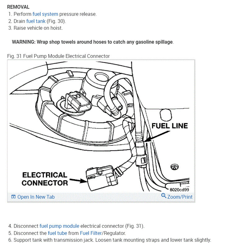

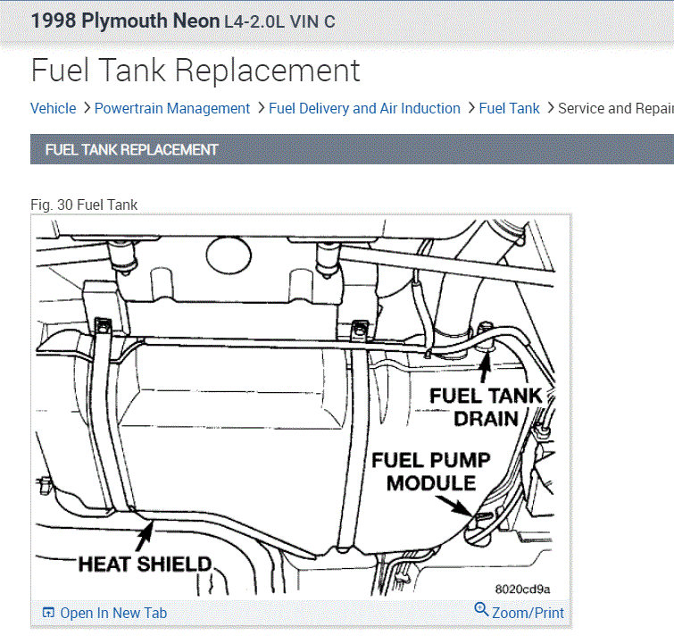

Test it. When you first turn the key from off to run, (engine off) see if you hear it, and then it stops and then starts again after starting the engine.
Really, that is the only thing that would make a whining noise. However, since the pump prims for a second when the key is first turned on, it may help you confirm.

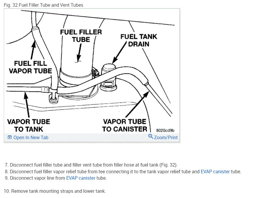

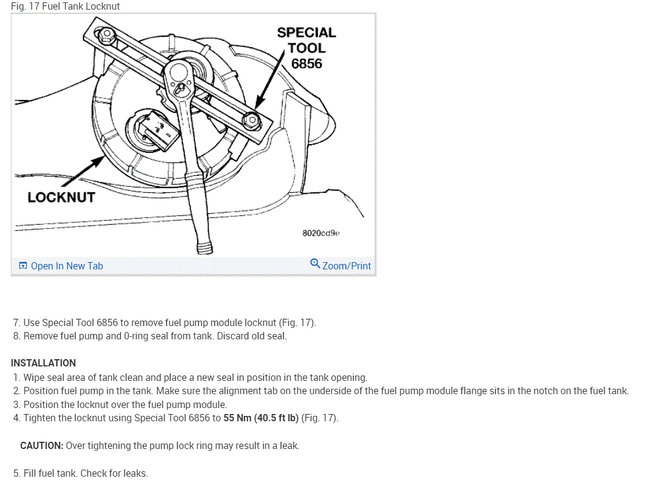

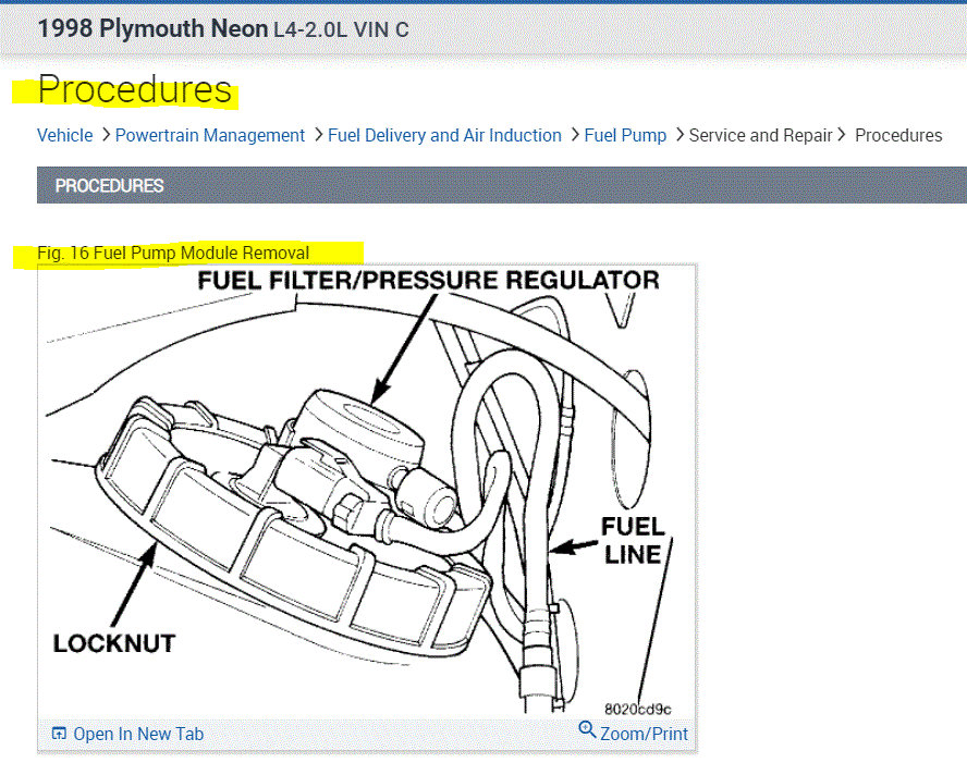

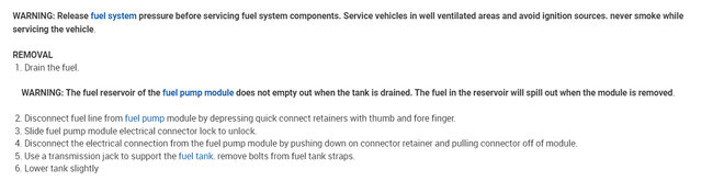

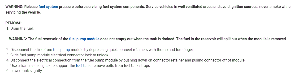

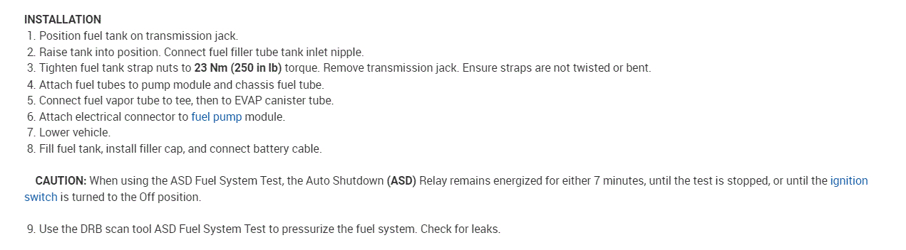

As far as replacing the pump, the fuel tank needs to be removed to gain access. If you look below, I provided the directions for tank removal and replacement first and then the removal and replacement of the pump.

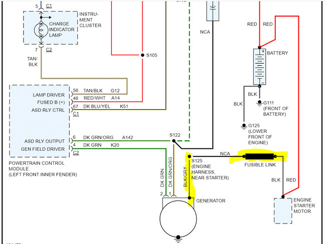

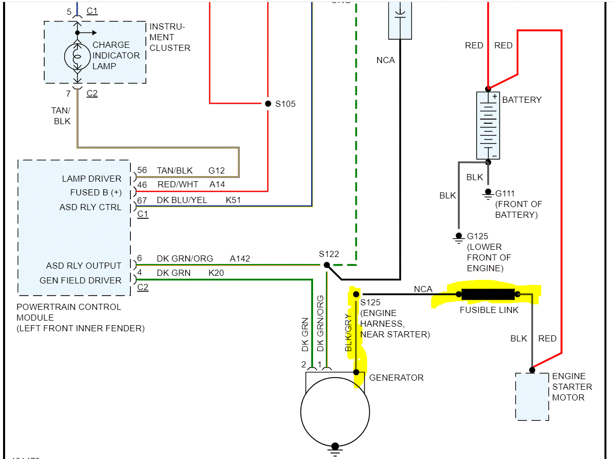

I had an afterthought. If you find the alternator isn't producing, I need you to check something else. There should be a black wire with a gray tracer at the alternator. That wire should have 12v at all times. So, if it fails the aforementioned test, confirm that the wire gets power.

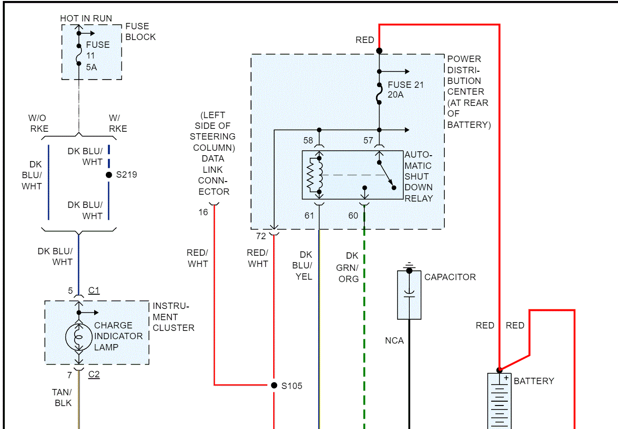

If it does, I then will need you to disconnect the battery, remove the alternator, and take it to a parts store to have it bench tested. I really recommend having it bench tested for one specific reason. This charging system doesn't have a traditional voltage regulator which is part of the alternator. Instead, voltage is regulated via the powertrain control module (PCM).
I want to be 100% sure the alternator is the problem and not the PCM.
I attached the wiring schematic below for the charging system, so you have a reference. Note the wire I mentioned comes straight from the starter motor but in the middle of the wire, there is a fusible link.
A fusible link functions the same as a fuse but looks like a regular wire. If it failed, the alternator will not be getting battery voltage and won't charge.

Mission accomplished! It's the alternator, I already changed it, and it's all good... but, there's another issue to address. Looks like the ignition switch is broken too. Looks like the contact in the switch is giving way, last night it took me a x3 to start the engine, and this morning I was able to start the engine x2 with 1 try, but on the third time, looks like there's totally no contact in the switch.
