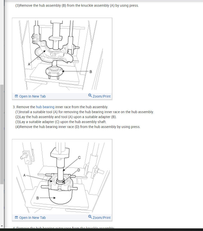

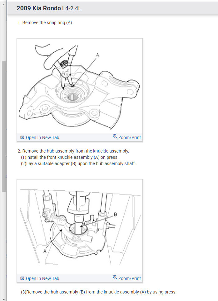

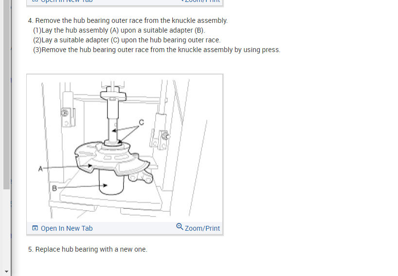

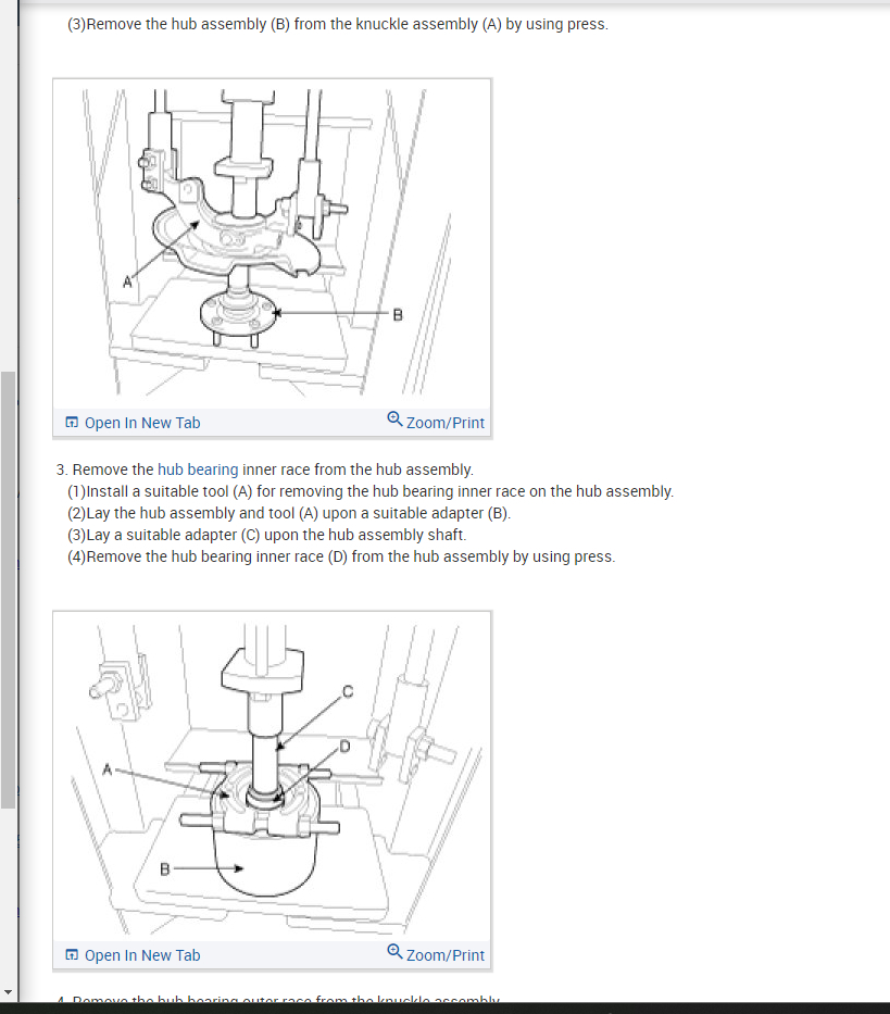

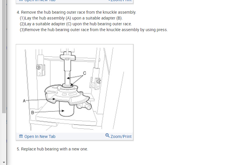

Below you will find the process on how to press a bearing out as this is what will be required to replace it so let's see if you can get a recording of this noise and we can go from there.
