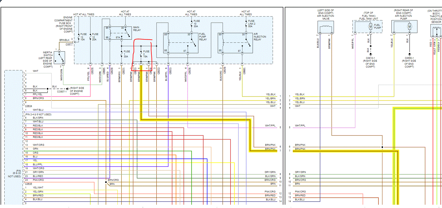

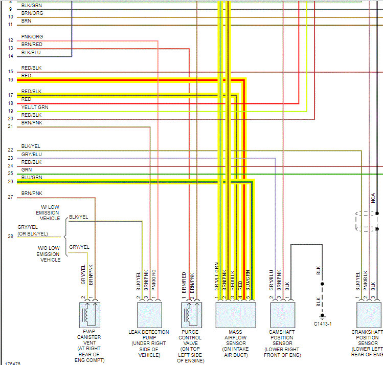

Which of the 5 wires are for the IAT I am trying to install a performance chip
100,000 MILES • 4.6L • V8 • 4WD • AUTOMATIC
JOSH6566
There are 5 wires and I want to know which ones are the IAT and how to install the performance chip.
Nov 14, 2020 at 8:05 AM
  • 110,246 POSTS

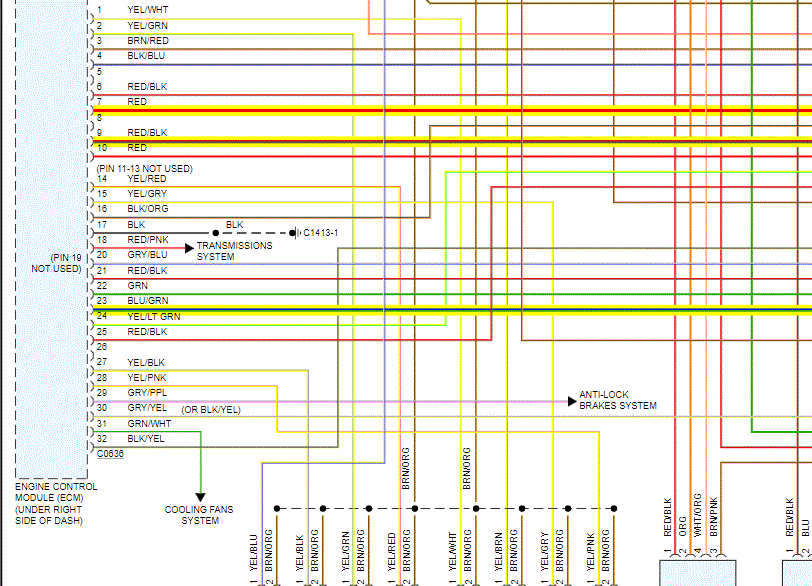

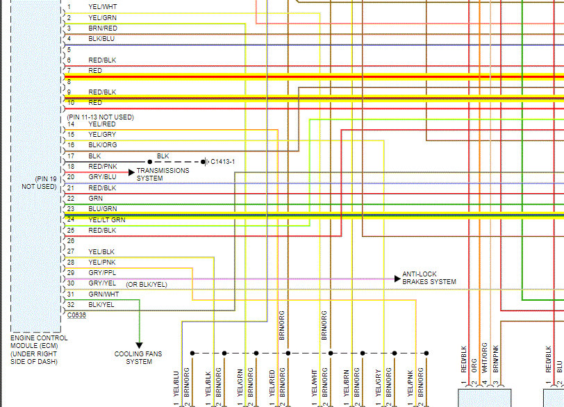

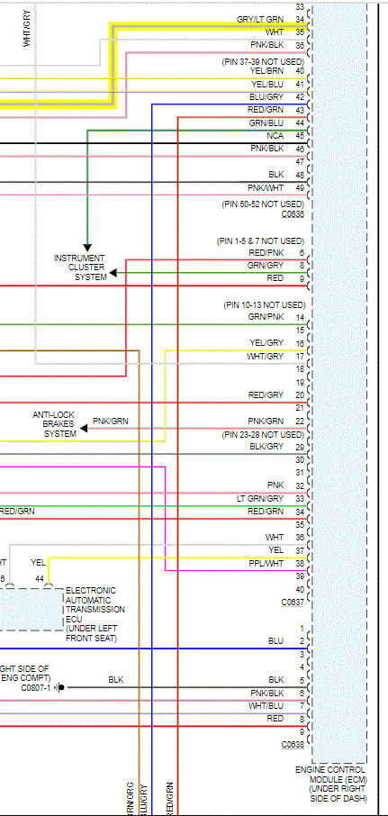

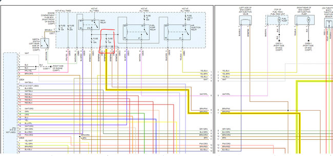

I attached pics below indicating where each of the five wires are going. I started with the MAF/air intake and highlighted the wiring. The three following pics show where each wire goes.
As far as the performance chip, I'm not sure what you are dealing with or what you have. I'm always concerned when these are installed because they can cause issues.
Regardless, I hope this helps. Let me know if you have other questions.
