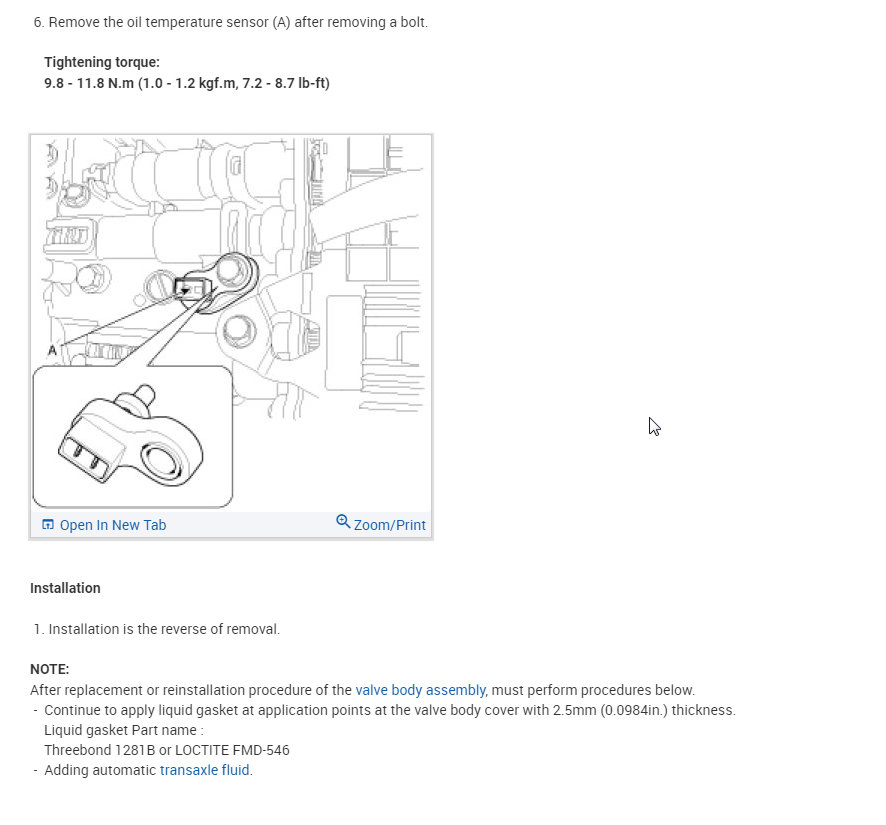

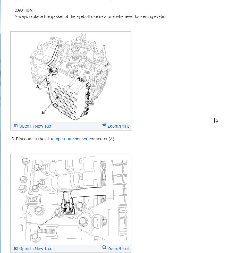

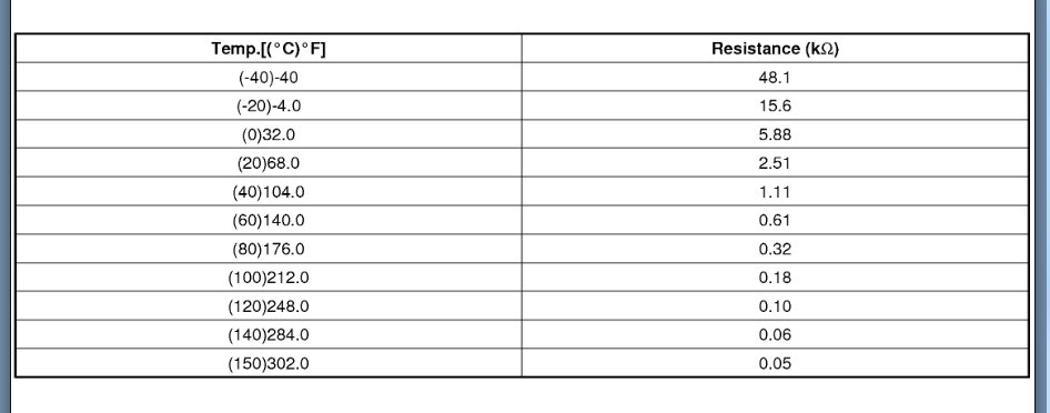

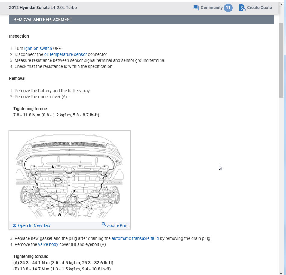

Where is the transmission filter and temperature sensor located?
Aug 16, 2020 at 4:28 AM

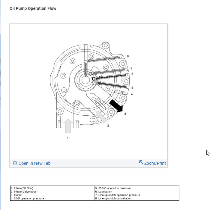

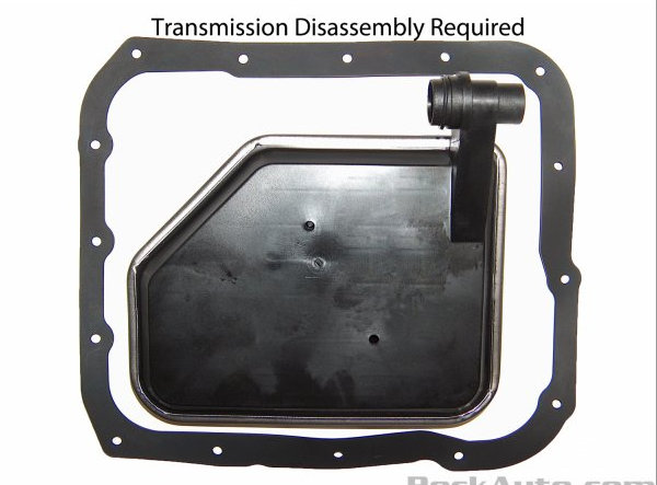

The transmission filter is interior to the transmission and does not require replacement unless you are rebuilding the unit. I included the info about the transmission temperature sensor. Also, a picture of the filter and diagram of the inlet to the filter and the pump. The manual does not have a specific process for the filter due to it not being a maintenance item.
Let me know if there is something else you need and we can go from there. Thanks

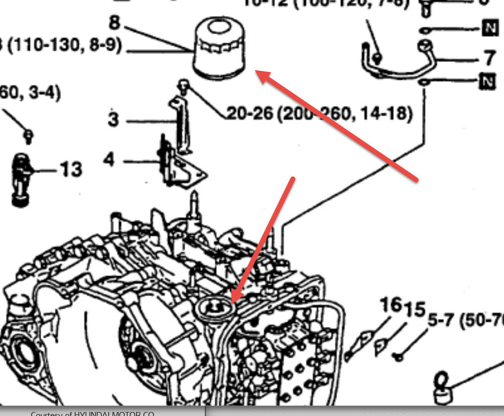

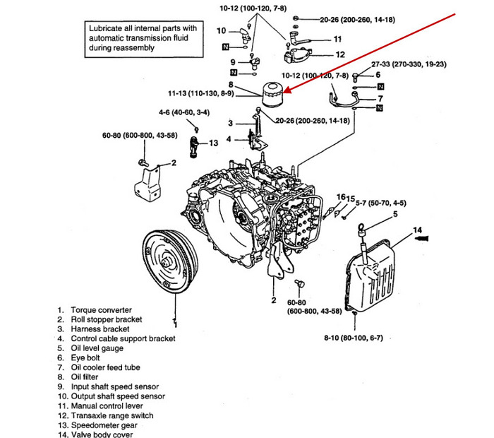

Need to change the transmission filter and I need to know where located.
Jan 8, 2021 at 3:53 AM (Merged)
HMAC300
  • 48,601 POSTS

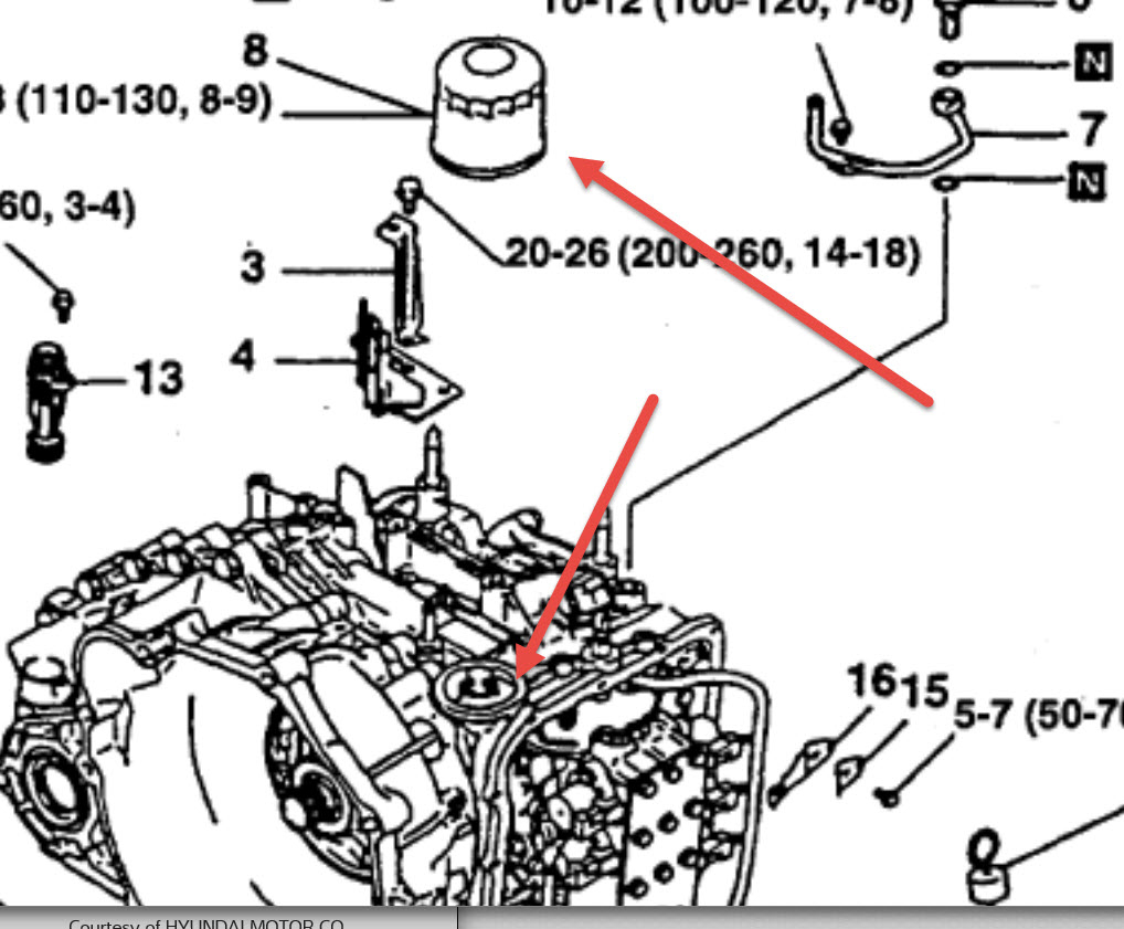

it is located right behind bell housing on left hand side of transmission. see picture for filter and where it screws on to.
M81
i change the fluid in the transmission and i can not find the filter i looked everywhere on the transmission and found nothing.
Jan 13, 2021 at 1:18 AM (Merged)
HMAC300
  • 48,601 POSTS
The transmission fluid filter is on top of the transmission like an oil filter. Check out the diagrams (Below). Please let us know if you need anything else to get the problem fixed. Cheers
