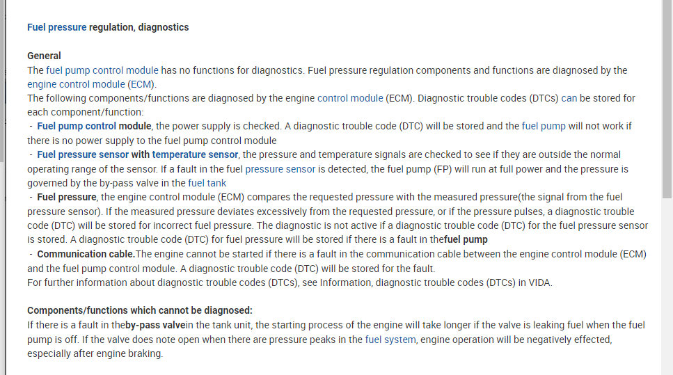

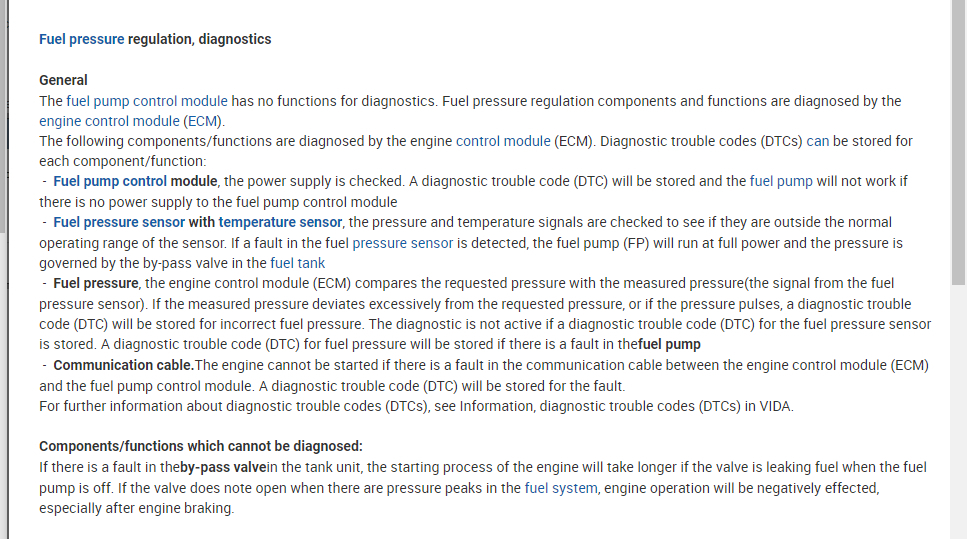

Car won't start when warm nor first thing when its warm outside. Have replaced fuel pump, fuel relay, coolant temperature sensor and cleaned the MAF. Also replaced pcv. Now think its the FPR but can't locate it. It is not on or under the injector rail, or near the steering. Don't know if its a mechanical FPR or electronic. Could it be on the fuel tank?
Jun 19, 2021 at 2:30 PM
Your engine does not have a separate fuel pressure regulator, it is part of the engine control module. Basically it monitors and regulates the fuel pressure and then will set a code if there is an issue.
If you have no codes then I would just check the fuel pressure when this is acting up and find out if that is the issue.
Also, this could be a crank sensor issue so we need to check if the RPM is moving when the engine is cranking. Here is a guide that talks about possible issues from a crank sensor:
This info will help us get started. Please let us know if you have questions and what you find with this. Thanks
