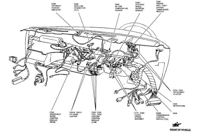

Can you tell me where the control module in a 1998 lincoln town car is actually located? The guy at Midas said inside of the wiper motor, online it says it's under glove compartment inside dash of car.
Tried replacing wiper motor 3 times with brand new motors, still keeps going out after a week. Everyone says it's not the motor but the control module needing replaced, have no idea where it's at and have to do it myself.
If under dashboard, how do remove dash to get to it?
I can't afford to take it somewhere to get done.
Thanks

The wiper control module is located in the lower center of the dash. Check out the diagrams (Below). Please let us know if you need anything else to get the problem fixed.
