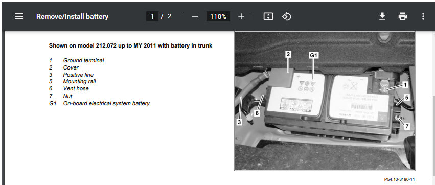

Where is the battery located?
2018 MERCEDES BENZ CLS63
104,000 MILES • V8 • TURBO • 4WD • AUTOMATIC
BHAMDOC1973
  • 2,007 POSTS
2018 GLS 63 AMG.
Apr 25, 2023 at 11:16 AM
  • 110,194 POSTS

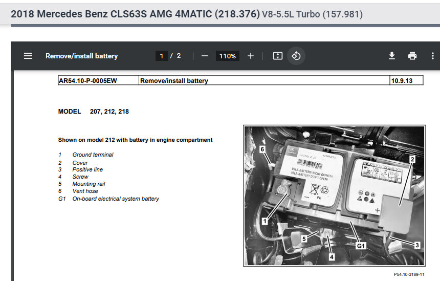

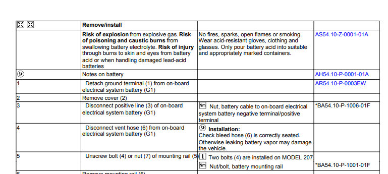

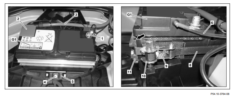

The battery is under the hood on the passenger side. It is near the firewall and should have a cover on it. See pic 1.

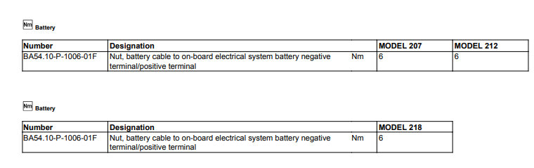

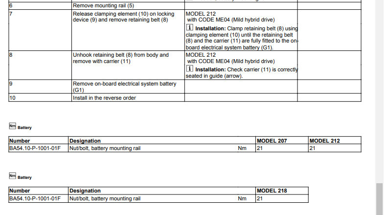

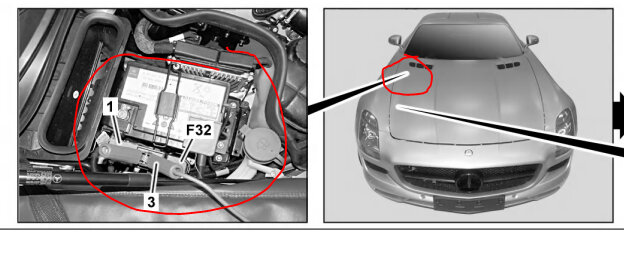

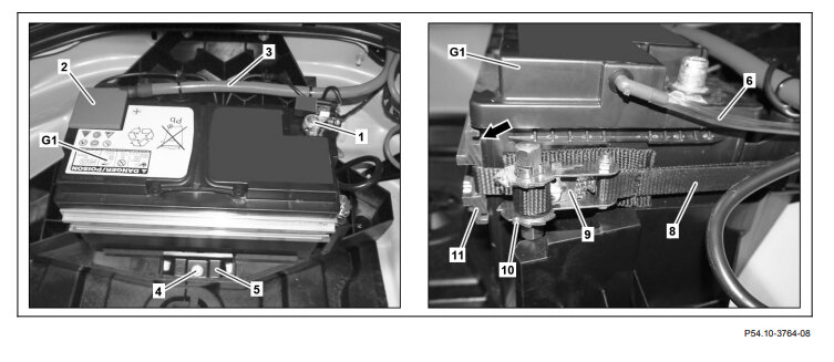

The remaining pictures are the directions for replacing it.
Apr 25, 2023 at 8:11 PM
BHAMDOC1973
  • 2,007 POSTS
Unfortunately, what you gave me was incorrect and is for a CLS, i have a GLS. I found it under the sear on the passenger side.
