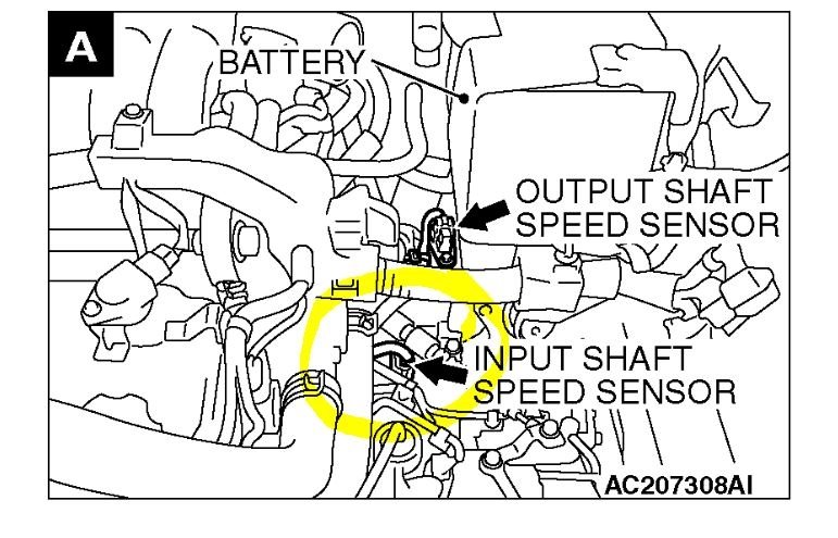

Recently my speedometer started reading anywhere from 5-20 mph higher than actual speed. I was told to replace this part. I found the output, but where is the input sensor located?
Apr 20, 2019 at 4:30 PM
Good evening,
I attached a picture for you to view.
Why are you replacing the sensor? Do you have a code for this sensor?

I was told it is most likely the speed sensors and since there's input, output, and vehicle speed sensor they just ordered this part for me and said this was it pretty much lol. AutoZone. I probably am not even replacing the right part. I just recently had to take it to Mitsubishi and have them replace two wheel speed sensors due to ABS issue.
Apr 20, 2019 at 5:06 PM
Got it.
What is the code number?

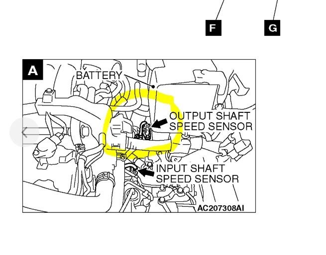

Jesus! Haha. Okay, so I asked AutoZone why I got the input sensor when in pretty sure I needed the output. They claim there is no output on my year Mitsubishi, that when they search it, the only thing that comes up is the input. Ugh. This car is a pain in my A**.
Apr 22, 2019 at 12:49 PM
Okay, first, taking advice from a parts salesman is never a good idea. You need a technician opinion, not a parts guy.

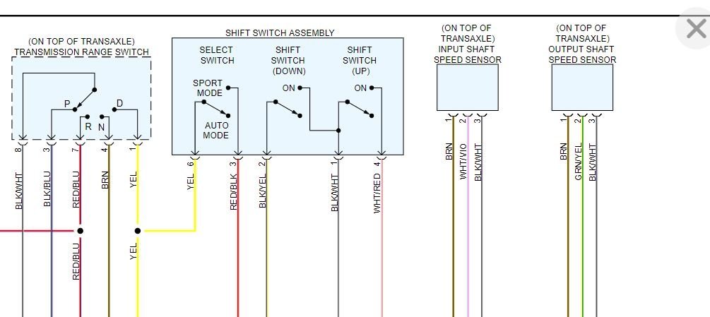

The speedometer is controlled by the vehicle speed sensor not the input and output speed sensor.
Do you have a scan tool to see if there is a signal to the PCM?
You do have an output speed sensor. I attached a picture for you to view.

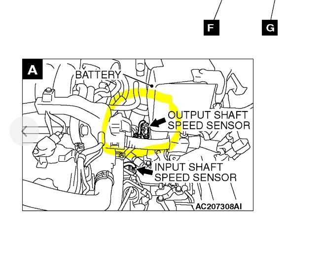

The speedometer is acting very strange. It's different every time, sometimes it is 5 mph off or even 40 mph off. Sometimes when I stop at lights it still reads 5-30 mph, or when it is off it sits at 20-40 mph. All my other gauges and odometer still work fine. I was told it is a speed sensor on this site. My car only has input and output, I have called multiple auto parts stores, that's all that shows up other than wheel speed sensors.
Anyway, I bought and replaced the output speed sensor because I was told it sends speed to the cluster etc. Well, didn't work. $99.00 down the drain. The input shouldn't affect the speedometer I'm told, so should I just get a new "used" cluster?
